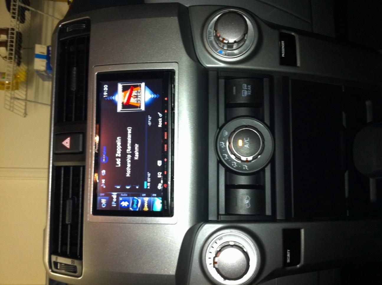

Here's the Avic installed. Took it with the iPhone. Have two VAIS antennas inbound, one male/one female (SFA12F and SFA12M). Will follow up with the one that worked.
