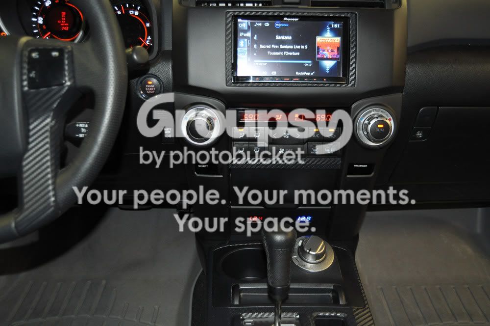

i doubt this has come up yet, but there are basically two kinds of double din dash kits for the 2010-2011 4runner, one of them is made by Metra, and the other is made by Scosche
I didn't really notice the difference until i saw a photo of Harpers dash kit. People always complained about the space on either side of the nav unit. I think with the Scosche there isn't a lot of space on either side because of how the plastic is laid out.
Metra
Picture022-4.jpg~original
Scosche
IMG_2464.jpg~original
notice the slight differences in the plastic around the nav unit. I kinda like Scosche better. But, like i said, i didn't notice this until after i bought the kit and installed. it.
yeah, but it is the point that it is metra.. :) we're not on good terms with each other.
Also, Scosche is more stable.

Two things - thanks for posting both images....I know which I will go with now when (if) I make the jump and upgrade to a Nav system.
Second, what is with the 4R? Carbon Fiber? What are those digital numbers at the bottom of the console just above the 4WD selector on the LE? I am guessing it is something that is custom based on the rest of the 4R but just curious if anyone knows.
I'm pretty sure that is Harper7's 4R, the carbon fiber is an overlay, and the "numbers" are voltage indicators for his dual batteries.
that is harper7's work. the carbon fiber is a film or something that you can apply to anything. As you can see he likes it. He was talking about doing a sweet camo 3M film on his roof. Not sure if he ever got around to it though.
those red and blue digital displays are for his dual batteries, it displays the voltage for each
Figures it is something he would do :hiding: I actually don't mind the carbon fiber look, we have an 06' F-150 FX4 which came with the 'carbon fiber' around the dash and wheel like his, I like it. Toyota needs to enlist him for a 'Harper' edition!
I used 3m Di-Noc carbon fiber vinyl wrap and put in some voltage gauges for my dual batteries.Painted all the other silver to black. That silver was getting scratched with my kids and dog pretty hard on painted plastic,especially the center console.The write-ups are over on my build thread in the gallery.......Voltage Gauges
