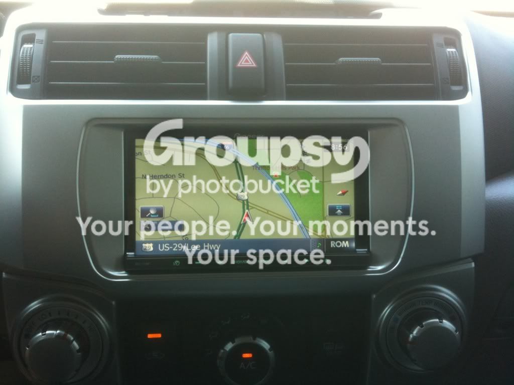

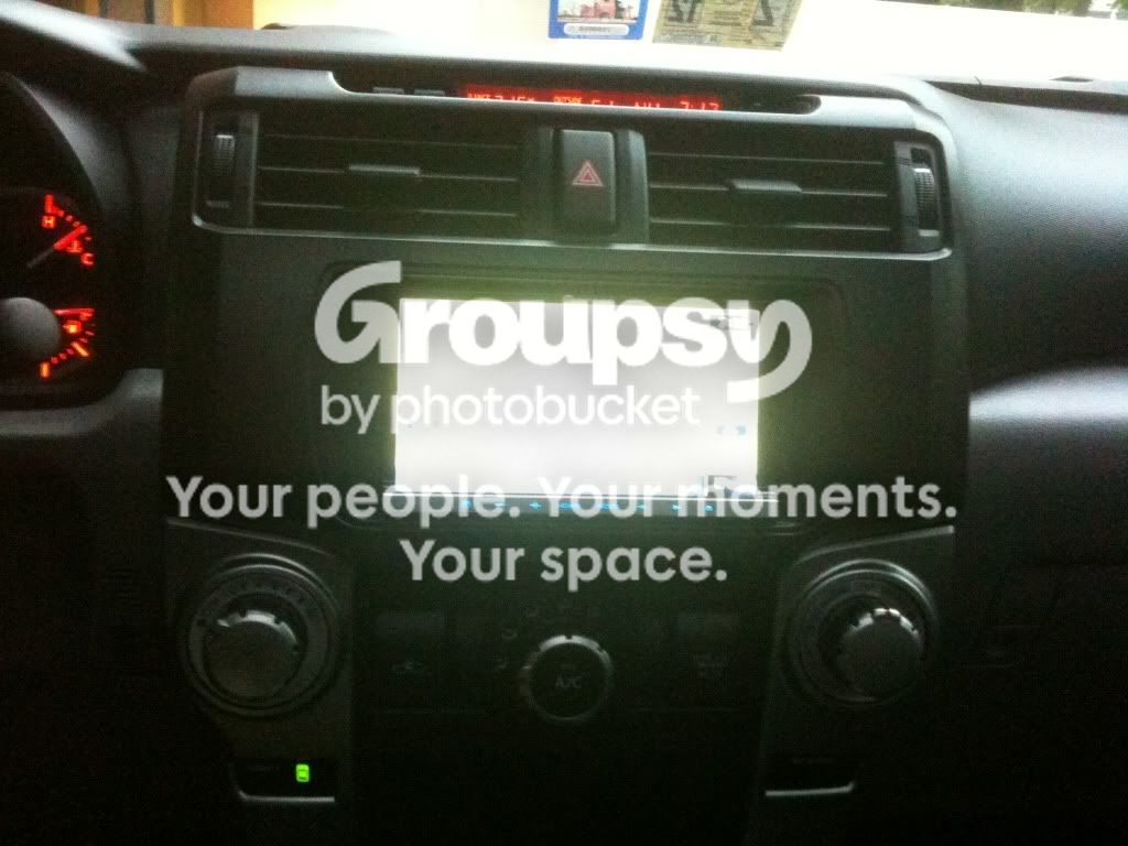

Here is a picture of my Nav system before this weekends work:
IMG_2464.jpg~original
3b6eea24.jpg~original

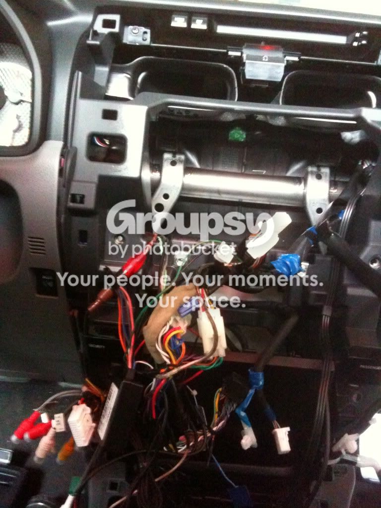

Next, here is a pic of me taking apart the dash, and the Pioneer Nav being taken out
IMG_0913.jpg~original

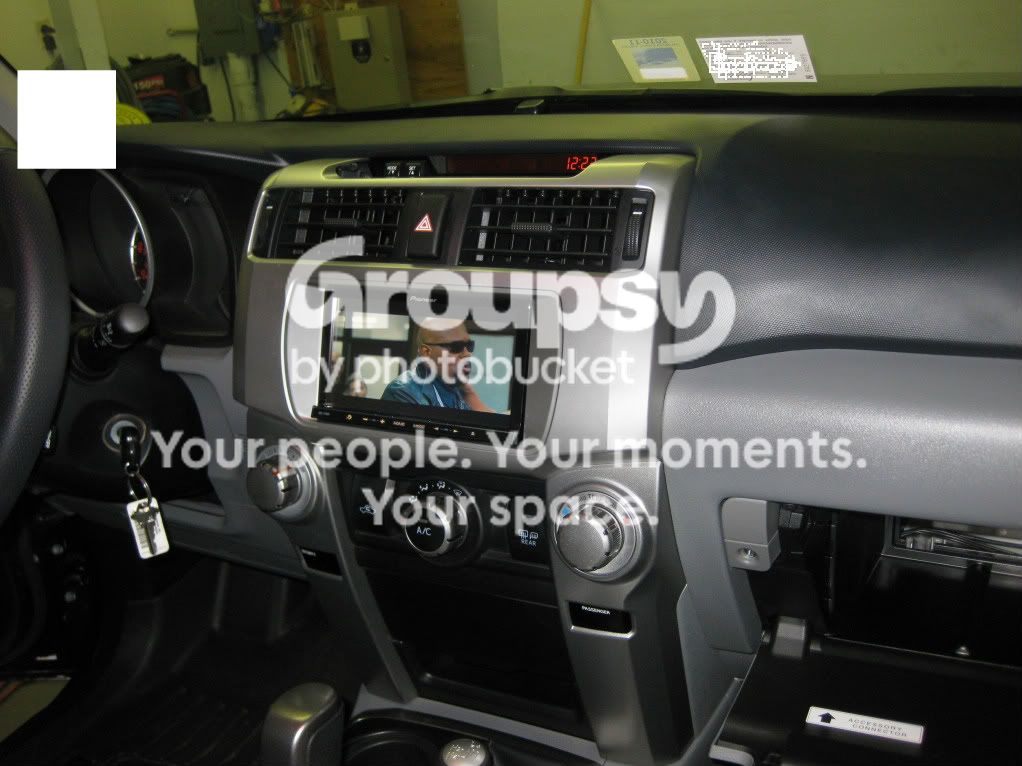

Here is the finished product. SHOUT OUT to Harper7 for encouraging me to keep trying and to not give up. His dash kit was an inspiration and i'm glad i kept trying. The painting and sanding of the dash kit, wasn't too bad I wanted to give up, but kept trying. Eventually, I got better at it. In the end i went through 3 dash kits, and lots of paint. LOL
IMG_0917.jpg~original

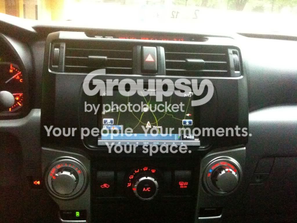

Here are a few examples of the screen being dimmed when the headlights are on.
Before Dimming - headlights OFF
IMG_0919.jpg~original
After Dimming - headlights ON
IMG_0918.jpg~original

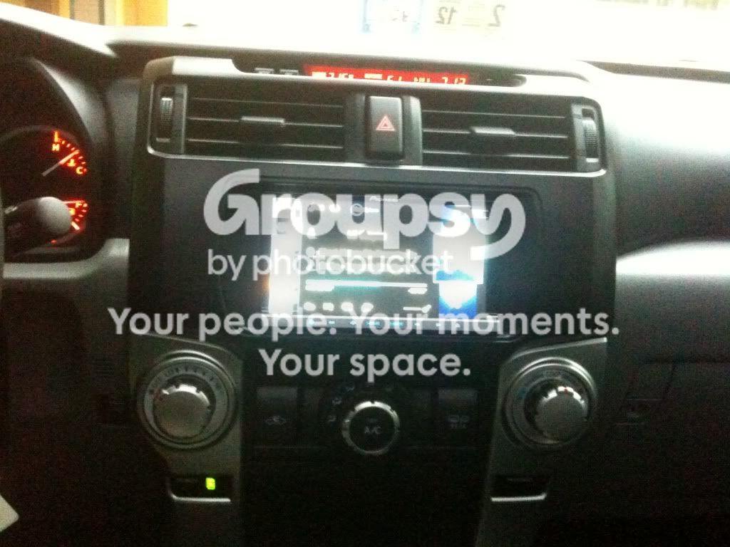

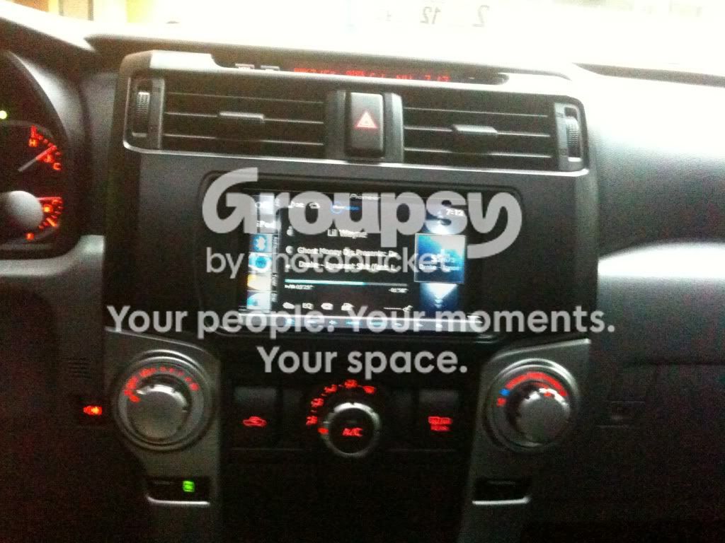

IMG_0916.jpg~original

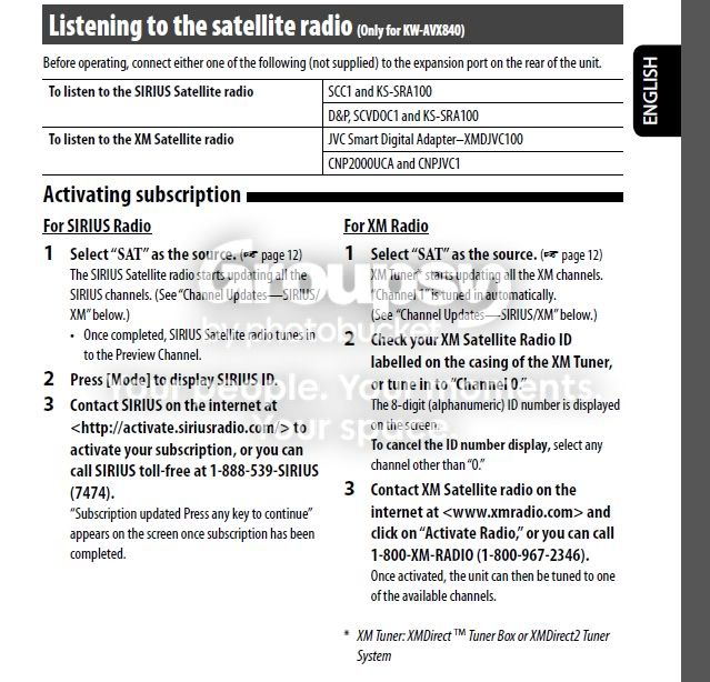

yeah, i'm pretty sure the T4R factory XM isn't compatible with aftermarket systems, at least that is how it is with the Pioneer unit i have.
I found this, which makes me believe you will need to purchase a XM adapter for your JVC headunit.
ScreenShot002-1.jpg~original
Here is the link of where i found it, i scrolled down and it is under "listening to the satellite radio"
http://resources.jvc.com/Resources/00/01/50/LVT2180-001A.pdf
