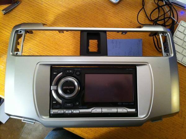

back on topic, I am going to make every effort to keep the stock stereo, non nav, and add either cleansweep or audio control in order to add my JL M6450 amp, sub I will have to sell my 10" RF Punch and go with an 8" once I find a JBL sub enclosure.
I really like the convenience of the stock system, it is the first bluetooth system I have experienced that works reliably. Even compared to my alpine system. I find it controls my iphone as well as my ipod nano pretty well. Haven't added the infinity kappas, they are sitting in a box, I am currently traveling for work so I have no access to my car. I guess my plan is to see how far I can go with the stock head unit, adding amp, sub and new speakers, dynamat, etc. and see if I am happy with it at that point, then if not.....
Backup plan, is this:
I have all the optional accessories for it, it may look a bit funny since it is blue lighting, and the dash is red.
