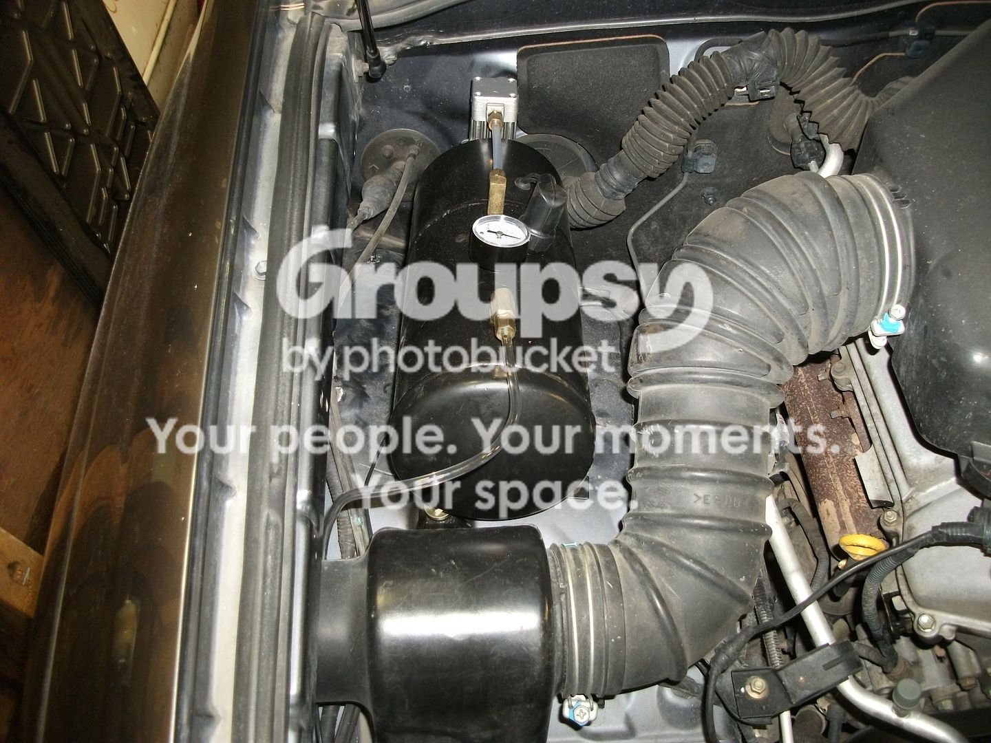

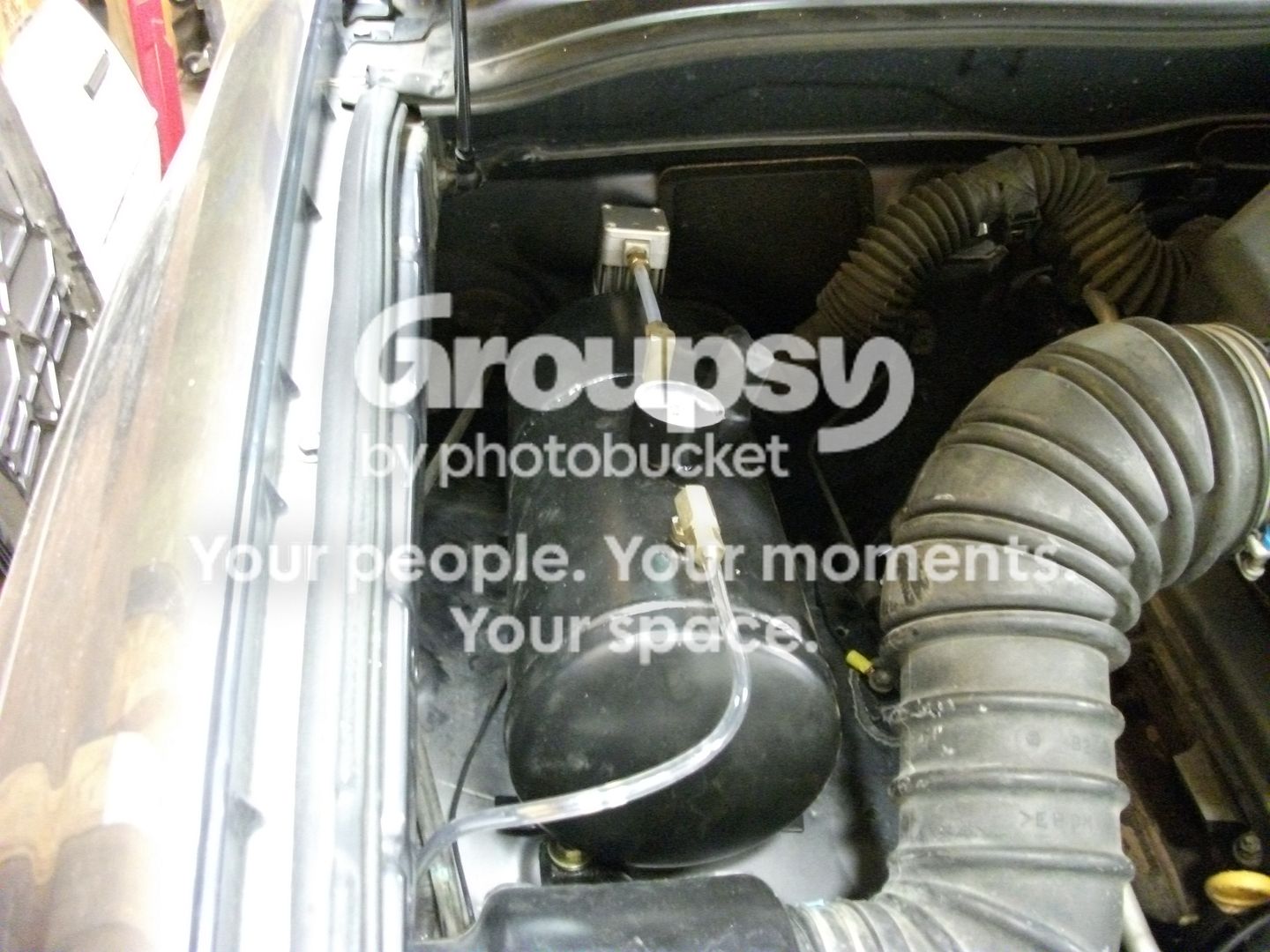

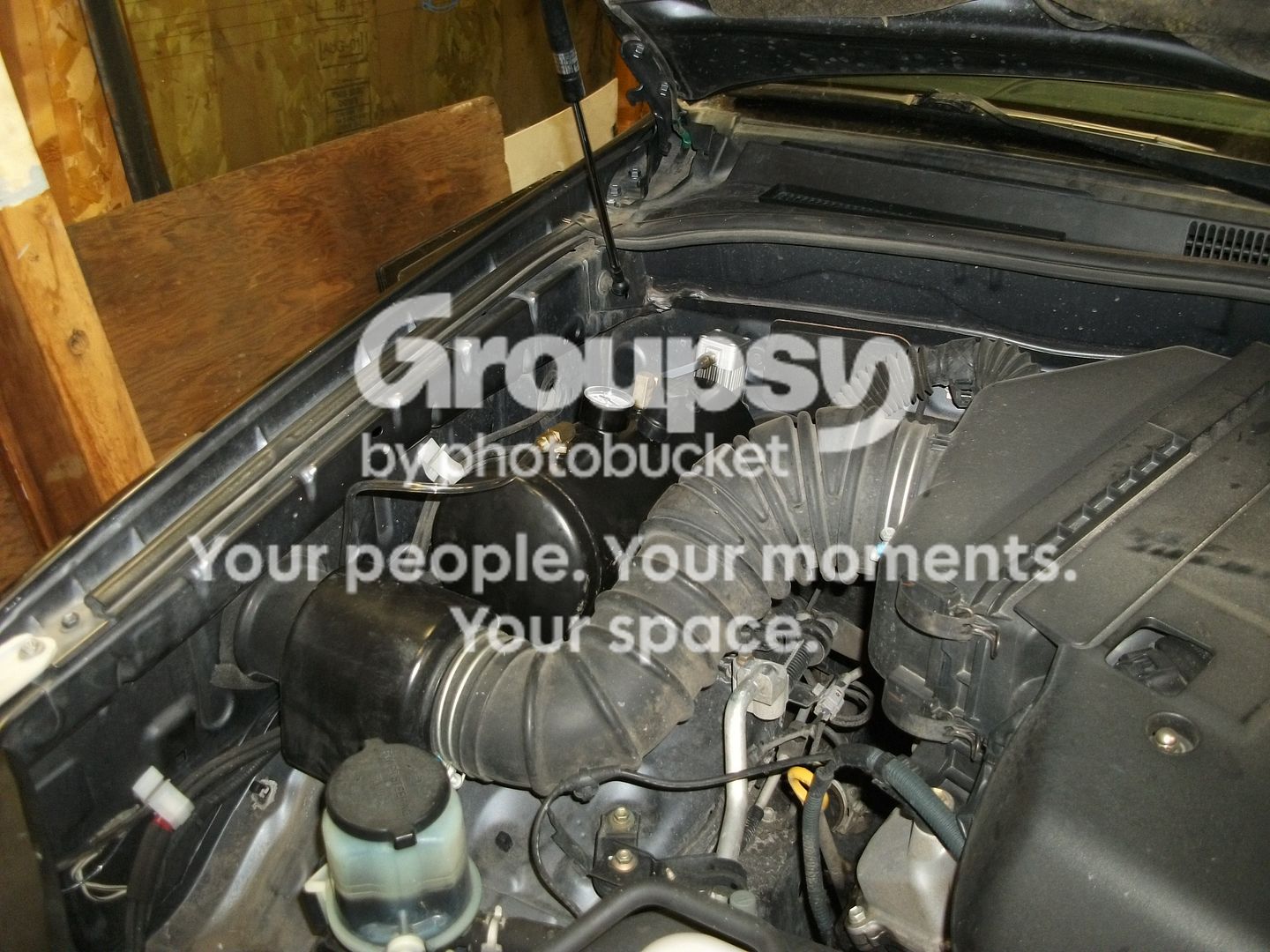

Put the tank/compressor over the passenger wheel well:

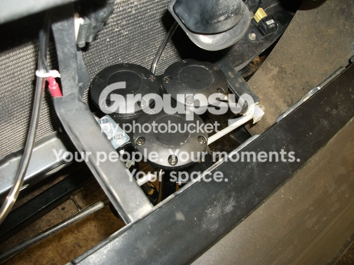

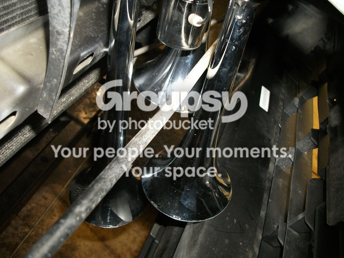

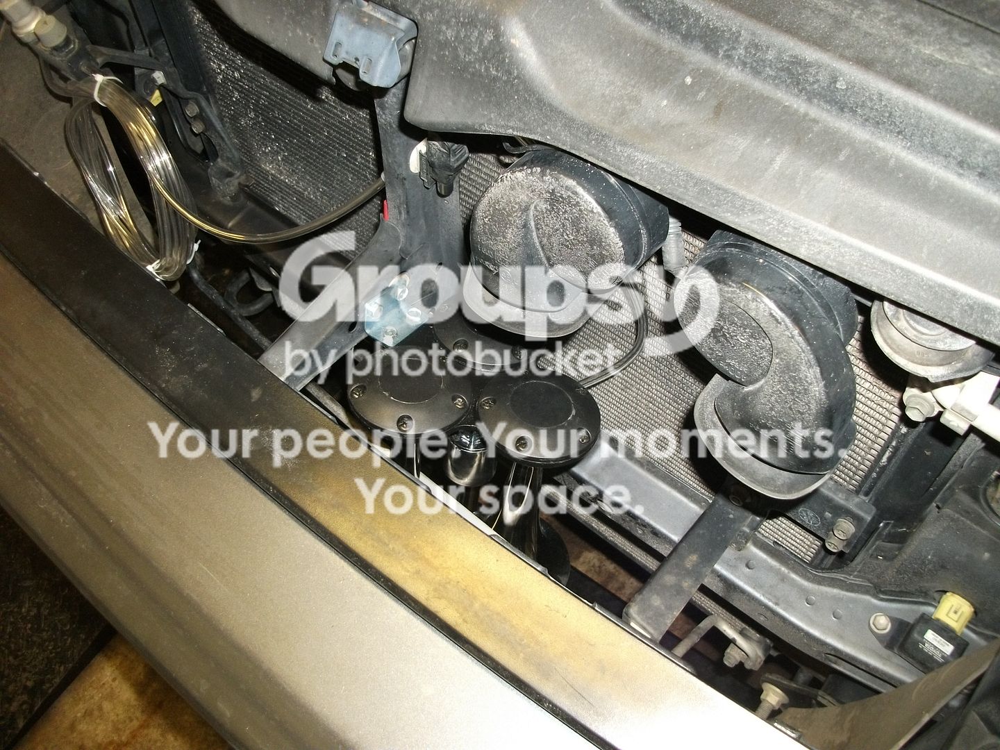

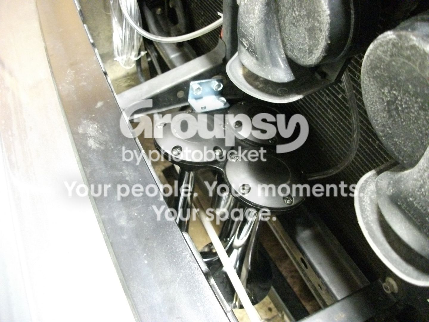

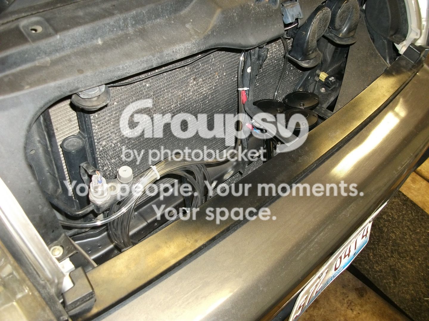

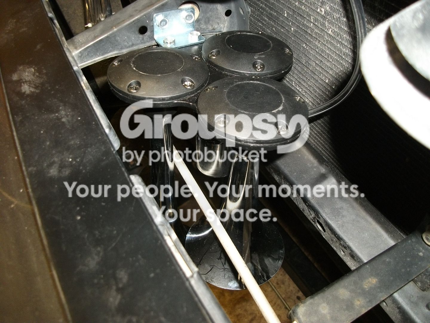

Mounted the horns behind the grill like most people do:

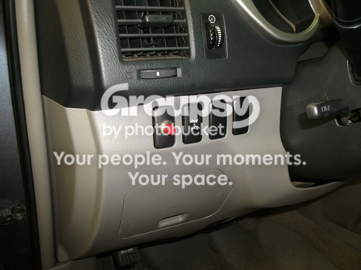

And the button is in one of the blanks:
looks like my kit when i first got it. Youll want to upgrade that clear line to a hard line 3/8 line. Mine blew up first time it aired up. Mines 5 years old and works great. I put different horns on but i like it. Lots of fun.
I think the line problem has been addressed because my kit came with a fitting that I had to change. The line connection at the horns is extremely tight. I had to use a lighter to soften the hose enough, then some grease on the fitting to get it on. I doubt it's going anywhere. Been using it with no problems so far.
im looking at getting air horns/on board air for my truck, my main thing is finding out where to put the air tank and the air compressor and have them not use up much space or be in the way of anything.
You did see above at his compressor that mounts in the engine compartment?
By the way, how's the horn holding up?
the little air horn is still doing great. dont know if i will ever go to a big air horn or not. yea i like the tank mount but i dont know if i would have a tank that big on the fender. once i add an air tank with my pump i have i might
