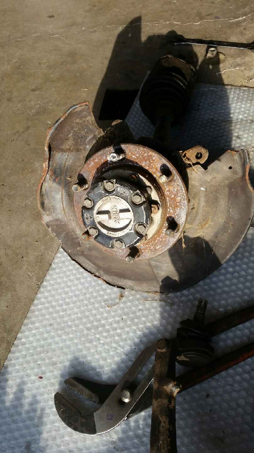

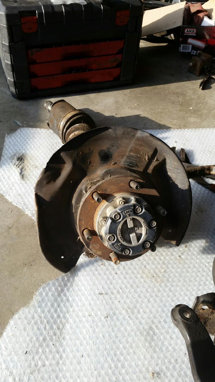

I just got a set of manual locking hub today!!! It's off a 98 tacoma my buddy going to sas the tacoma and he just gave it to me! So happy can't wait to finish it up! Will post pics up later
Nothing is better when it's free!! FYI 3gen fans, Sas guys don't give a f about these hub it's just trash to them! Find someone who planning on Sas see if you guys can get it for free Hahaha or $100.00
