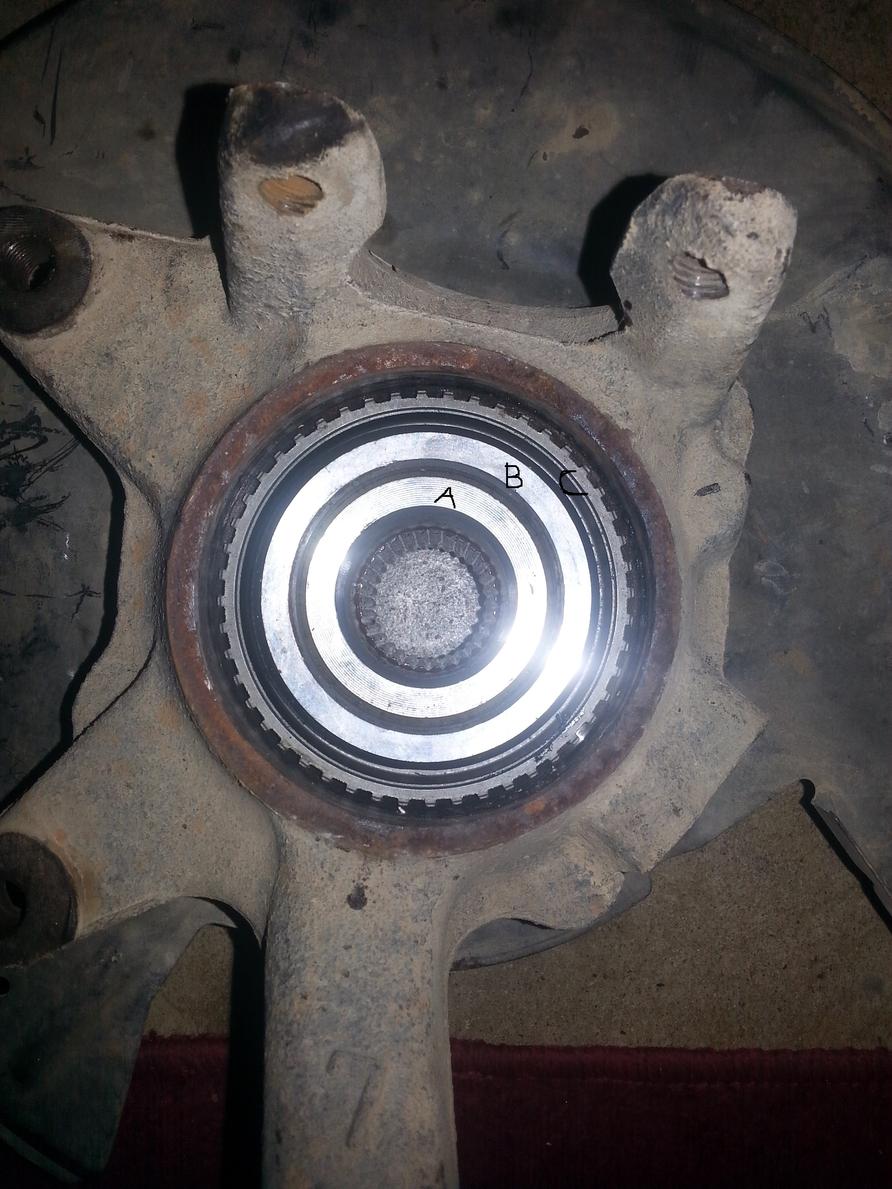

ADD Spindle w/ ABS
A is inner ring
B is middle ring
C is ABS ring
When pressing the spindle out, do I press on the inner ring? And does the middle ring and ABS ring come out first? I've tried pulling them out with a magnet, but have not came off.

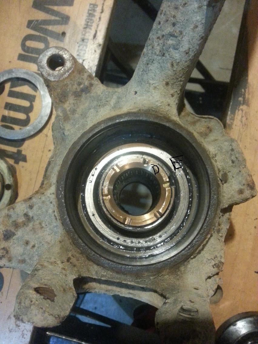

Manual Hub Spindle with locknut and spacer removed
D is bronze bushing
E is the wheel bearing
On this one, I will not be removing the wheel bearing; I will just push the spindle out and press it into my ABS spindles with new bearings. Do I need to remove the bronze bushing or do I use the 7 ton puller straight on the bushing. If I do need to remove the bushing, how does it come off.

ADD Spindle w/ ABS
A is inner ring
B is middle ring
C is ABS ring
A is the butt end of the hub. This is what needs to be pressed out.
B & C are held on by nothing but grease. You may have to remove the inner seal to get these out from the back. Otherwise, you could leave them in there when you press the wheel bearing out through the front. These bearings are not reusable as per the FSM. Usually, just by pressing the hub out, the bearing gets damaged (not necessarily visible) and will no longer spin smoothly or with ease. I'd say replace them while it's all apart, otherwise you run the risk of a quick bearing failure when it's all put back together, making that much more work for you.
D doesn't need to be removed. Check out post #166 above.

I squashed my bronze bushing and had to buy a new one. It only takes a few taps with a long drift and they come right out. Better safe than sorry.
