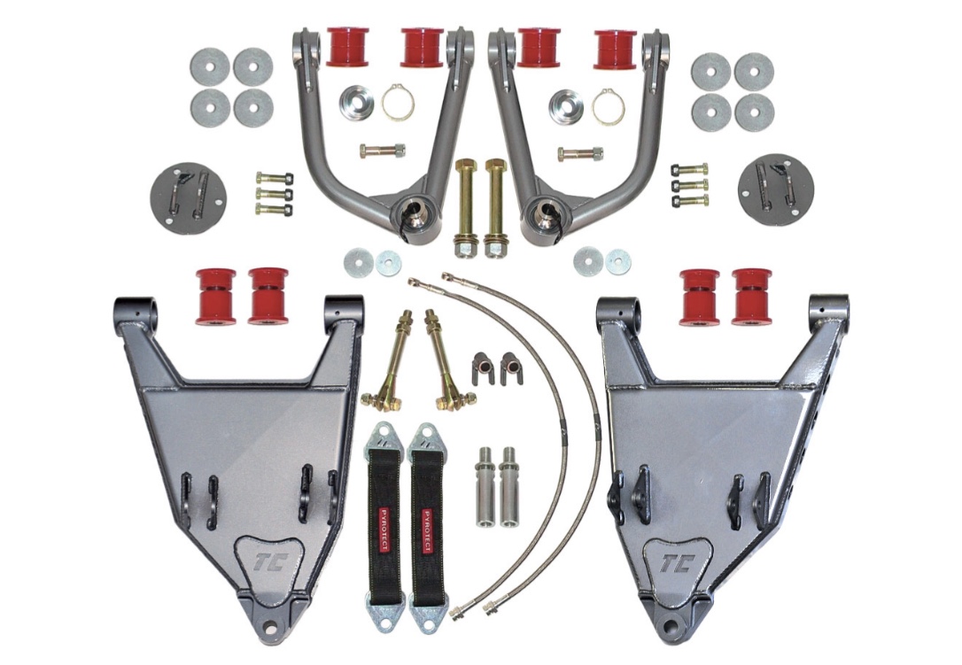

-Total Chaos:
-3.5” wider/13” of travel
-Included with kit: LCAs, UCAs, brake lines, limit straps, steering extensions, shock mounts

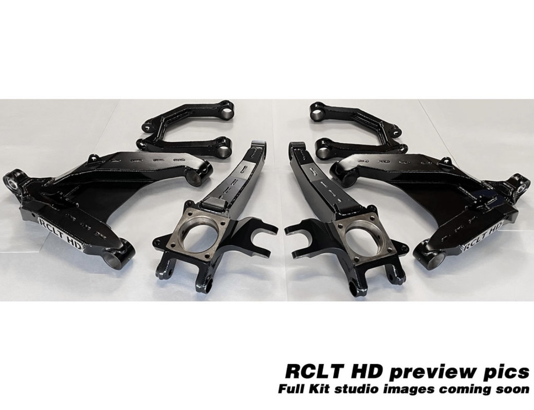

I've been bugging them since they released it.
I have a feeling it's not gonna happen.
Nope....market is now too old. Not enough RCLT projected units sold for the 3rd gen to recoup the R&D.
I'm going custom width FJ80 front, Tundra 8.4" rear instead....but keep thinking Tons are a better investment. Trying to keep it all Toyota though out of pure nostalgia.
