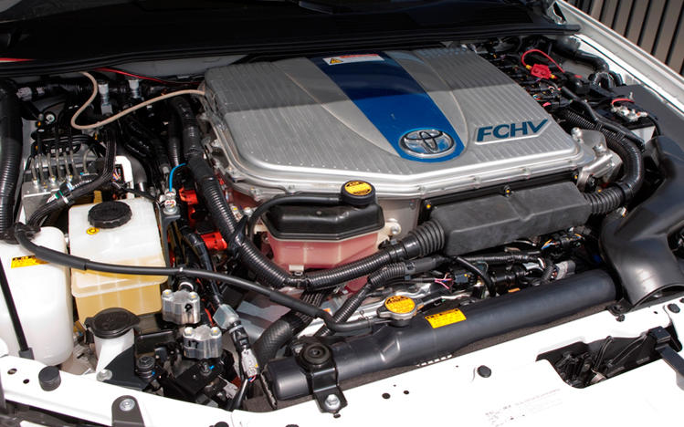

[MENTION=48776]dekeman[/MENTION] You dog, you're testing that 4R with the 1VD-FTV aren't you?
Could you imagine? My dream come true.
No, it's got something else avant garde....;)
