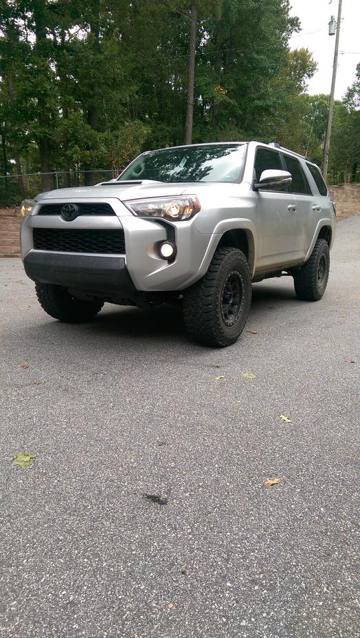

Yesterday I had my Bilstein 5100's installed. I went with the 2.5" setting up front and added a Daystar 1.5" spacer in the rear. Ditched the stock Dunflop tires for 275/70R17 KO2's.
MAJOR improvement in looks and ride quality!! No more major nose dive during breaking and it soaks up bumps better. Absolutely zero rub and I get to leave the mud flaps on!
I was worried about it looking "goofy" with that amount of lift on 275's, but I actually love the look!!

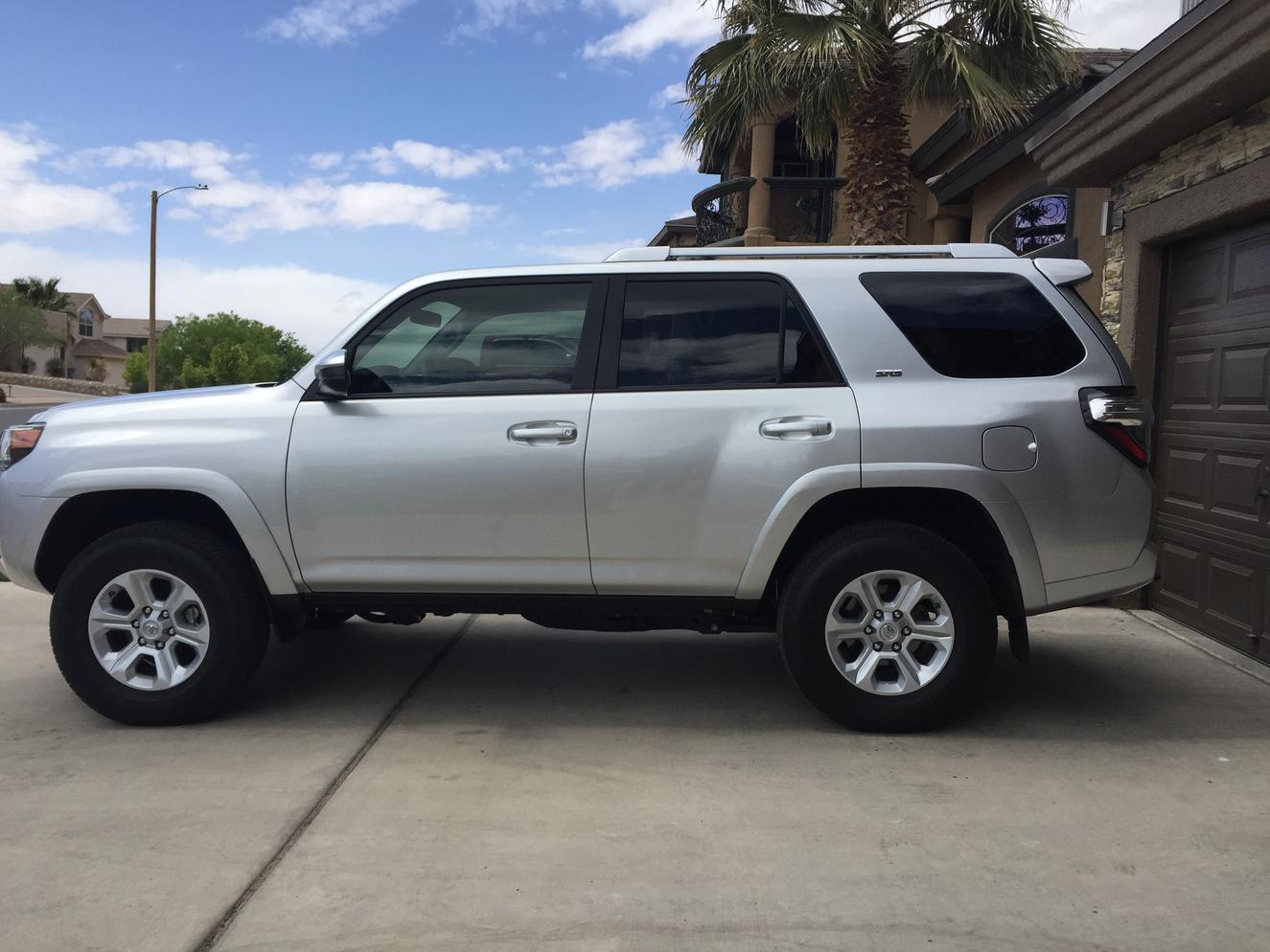

1.75 and stock rear with bilstein shocks
I will be adding a 10mm spacer by OME in the rear here soon.
