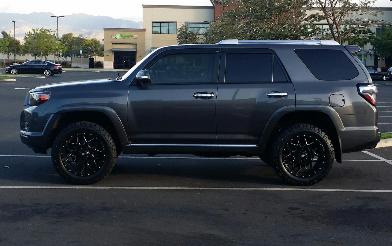

Yesterday I had my Bilstein 5100's installed. I went with the 2.5" setting up front and added a Daystar 1.5" spacer in the rear. Ditched the stock Dunflop tires for 275/70R17 KO2's.
MAJOR improvement in looks and ride quality!! No more major nose dive during breaking and it soaks up bumps better. Absolutely zero rub and I get to leave the mud flaps on!
I was worried about it looking "goofy" with that amount of lift on 275's, but I actually love the look!!
This lift and tire combo looks perfect! I have 15" TEP and looking to do same combo as you have. Just a few questions, did you notice any power loss with the weight of bigger size tire and i know the mpg will go down just wondering how much? Thanks!
1.75" & 1" & 275/70/17
I notice a very slight power loss due to heavier tire, and have a very minor rub driver side only in full reverse lock, but only in one direction. Everything else is prefect. Happy as a lark!

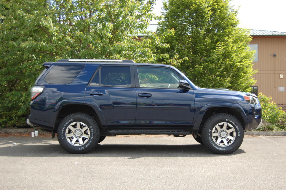

I just had 5100s installed at 1.75. Stock rear coils with 5100s in the back as well. I still have about 1/2" of rake. Measuring from the wheel centers to the fender is 21.5" front, 22" rear. I'm going to measure the frame one of these days, but she rides like a dream now! There's a pic in the "What'd ya do" thread from today if you want to see it. (I don't have the pic here at work to repost)
I saw it. Looking good, though it was a bit dark but i can totally see the difference. Mine is SR5 like yours. Im now have second thoughts regarding 1.75 front and stock rear. Does Trail w/o KDSS has a different suspension setup than sr5?
