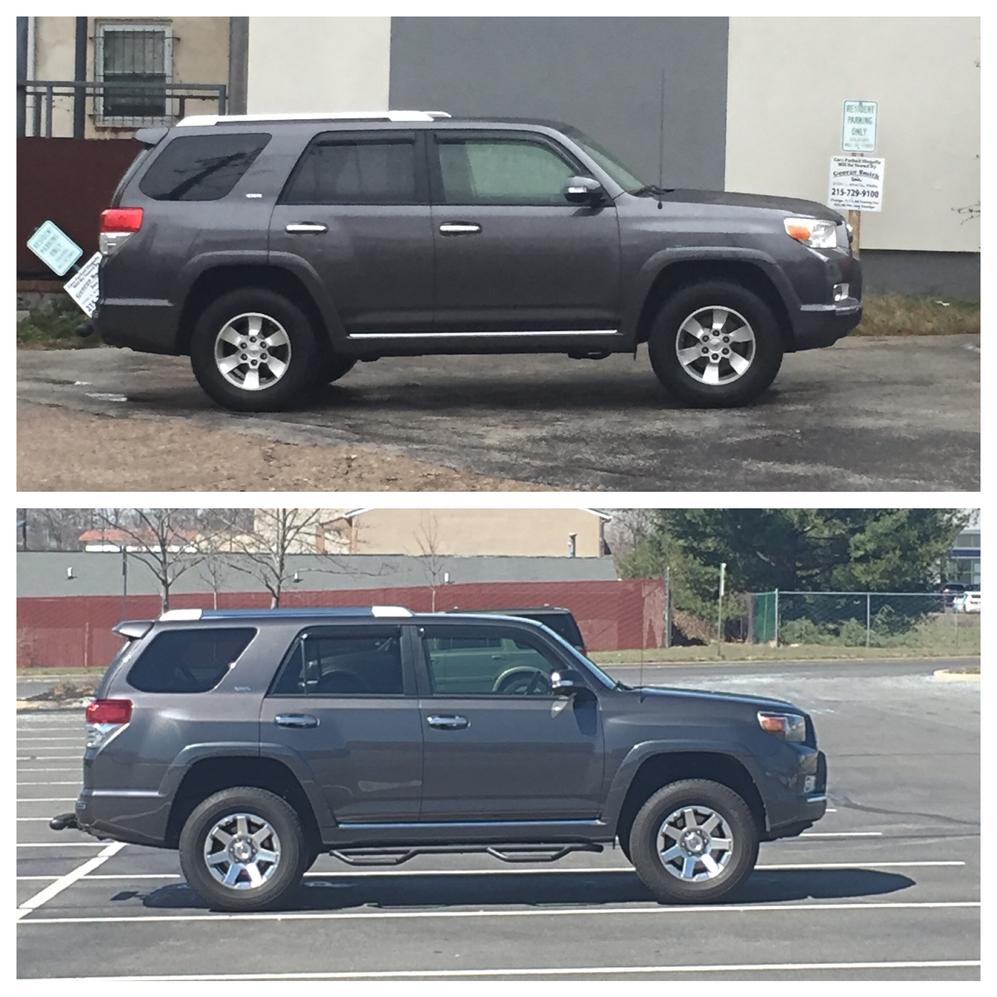

Yesterday I had my Bilstein 5100's installed. I went with the 2.5" setting up front and added a Daystar 1.5" spacer in the rear. Ditched the stock Dunflop tires for 275/70R17 KO2's.
MAJOR improvement in looks and ride quality!! No more major nose dive during breaking and it soaks up bumps better. Absolutely zero rub and I get to leave the mud flaps on!
I was worried about it looking "goofy" with that amount of lift on 275's, but I actually love the look!!

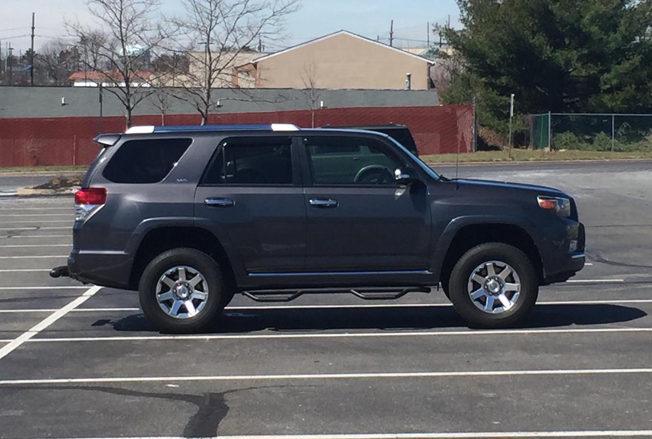

Got my lift installed today, here are some before and after measurements. Happy with everything so far. Stock UCAs. Measurements are from ground to the fender, which keeps some of the stock rake.
Before:
Front Driver-34.75"
Front Passenger-35"
Rear Driver-36.5"
Rear Passenger-37"
After:
Front Driver-37.25"
Front Passenger-37.75"
Rear Driver-38"
Rear Passenger-38.5"
