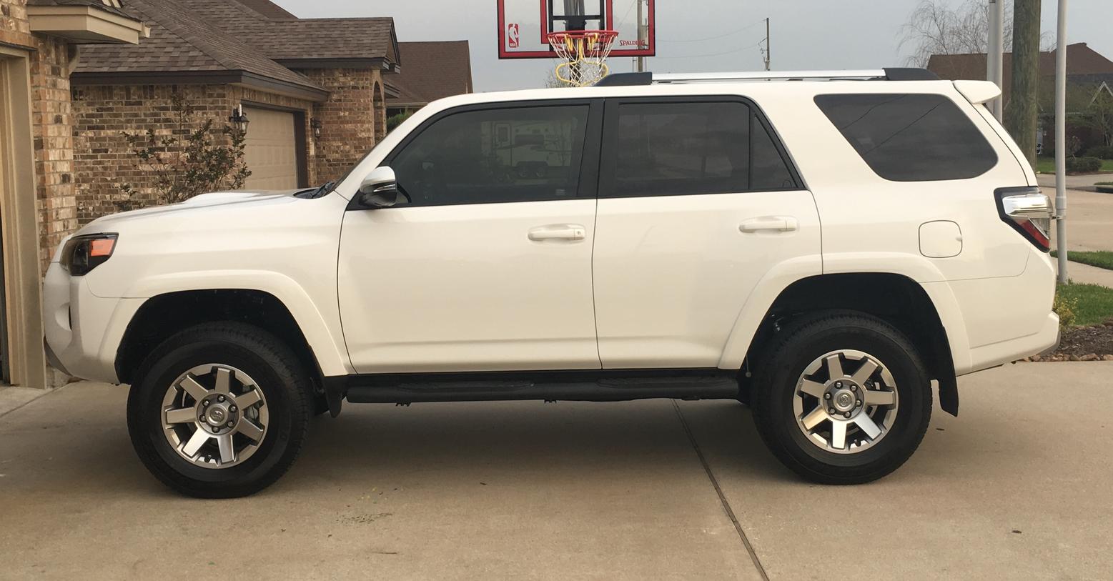

Thanks for all the input finally got my lift done yesterday. 5100s w/ 884s set at 0, rear 5100s with stock springs w/ Cornfed 1 1/4 spacer. Stock tires for now but will be installing KO2 275/70/17
Looks good. How much lift did you get up front? 2.5"?
I didn't realize your still running stock size lol. I assumed by now you'd have up sized a little

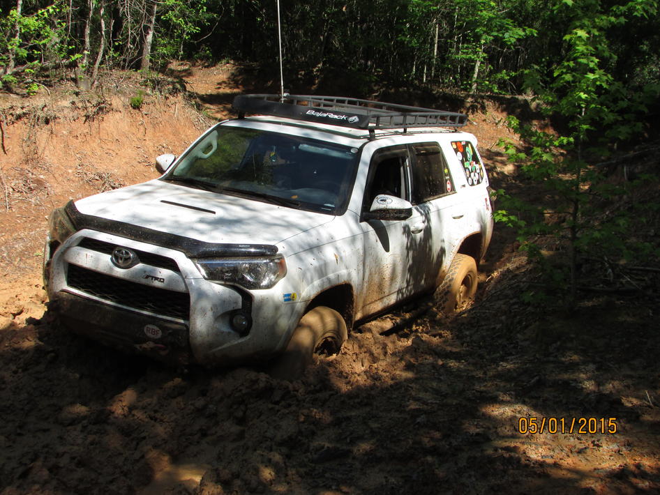

Lol. The only places I've been stuck bigger tires weren't going to help! And I still like getting 17 or 18 mpg!
