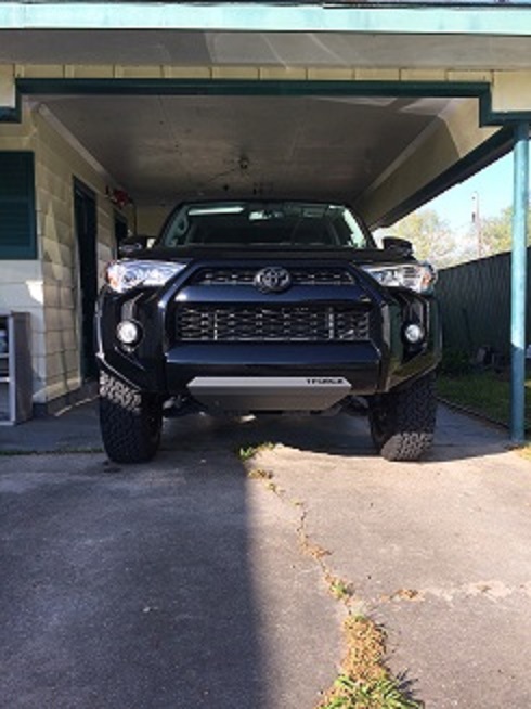

i just put 5100's on my 2016 SR5, set at 1.75 in.
the back(measured from ground to top/center if wheelwell) is still 1/4 in. higher.
the ride now feels much more controlled, not feeling like it is floating anymore and hardly any nosediving when i brake.

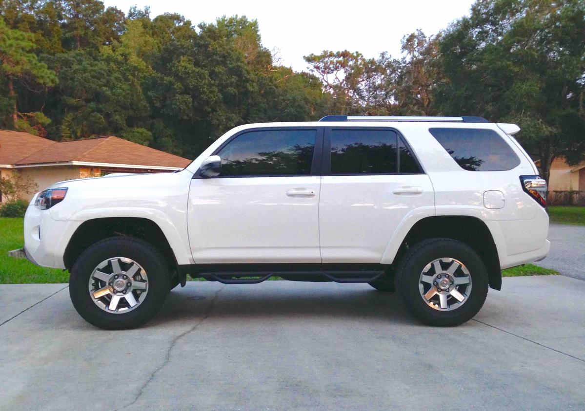

T4R - 8:24:16 - After Lift.jpg
Rod Lundquist did the installation. He did a fantastic job on mine. They are pricey, but I believe the job was done well. I'd go with cornfed spacers on the rear. They help compensate for the driver side lean. I went with 2.0" in the rear because I carry a lot of weight when I go to the woods. Recommend the UCAs.
