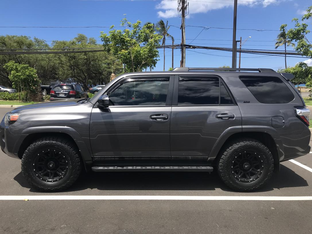

This is [MENTION=4880]colo4runner[/MENTION] 4Runner with a 1" rear Cornfed spacers and the front Bilstein 5100's set at 1.75".
What size tires do you have on this? Looks great!

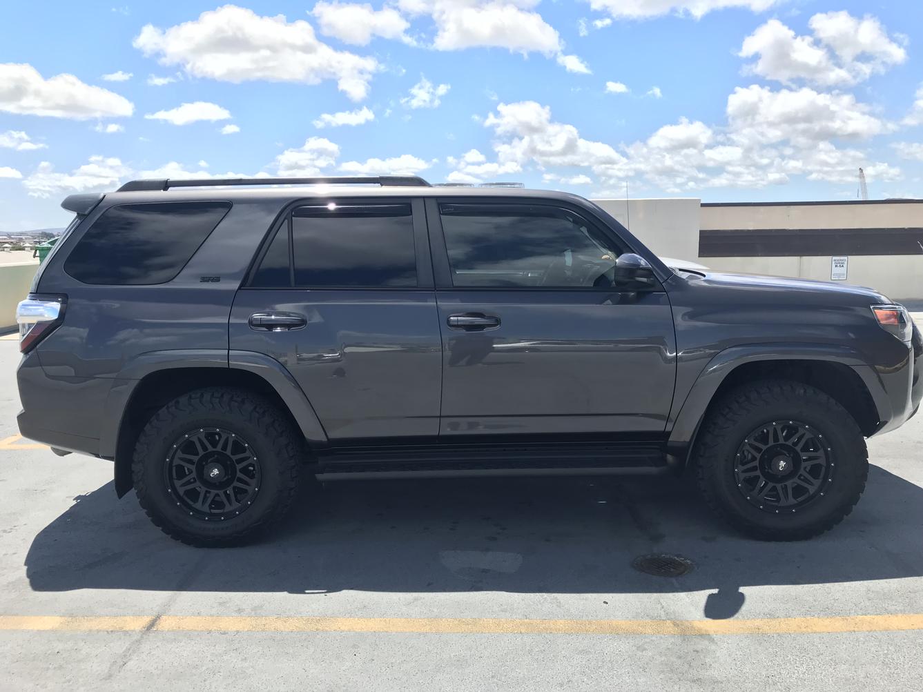

2015 4Runner 3rd row seating. BFG TA KO2 265 70/17.I did a set of Bilstein 5100 set to .85 on the fronts. Rear Stock. I’ve attached the before and after pictures.
