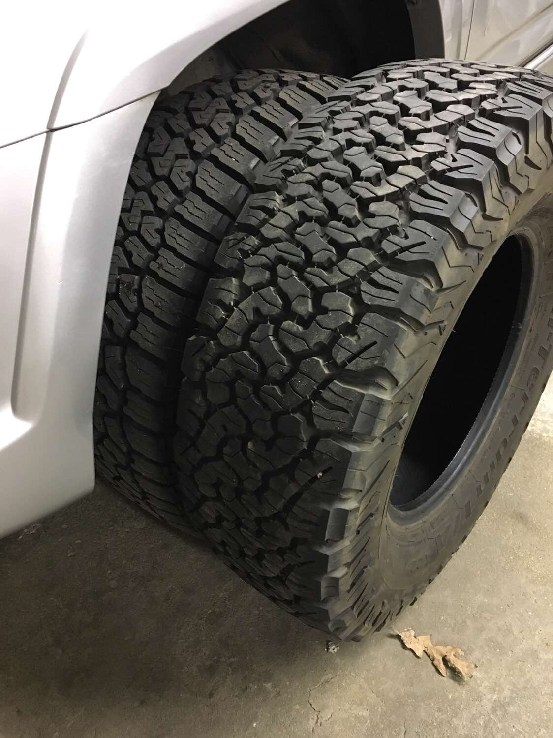

Running Cooper Discoverer AT3's in 275 flavor with no rubbing.
Most people can run 285 KO2s with minimal trimming from what I gather.

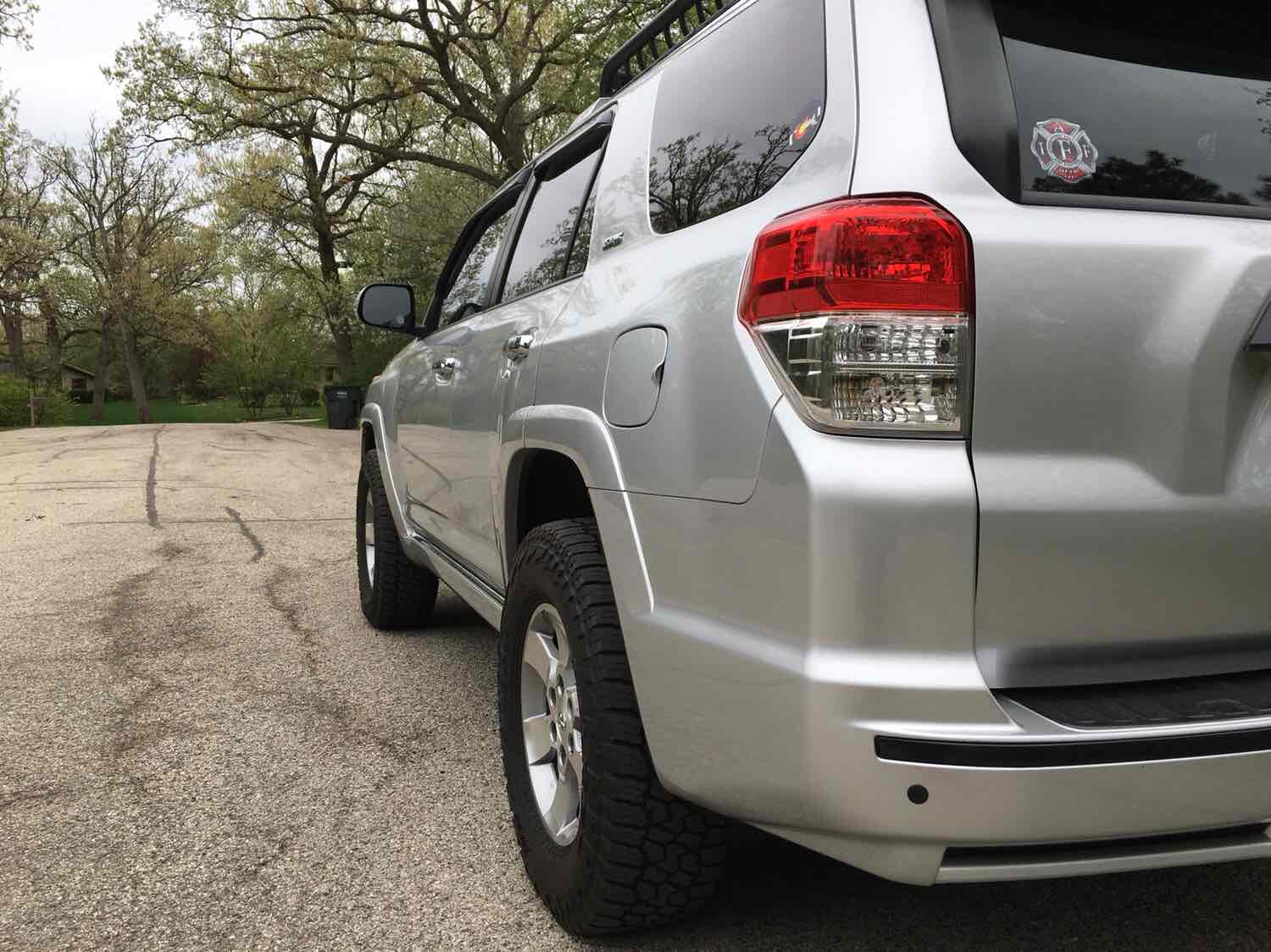

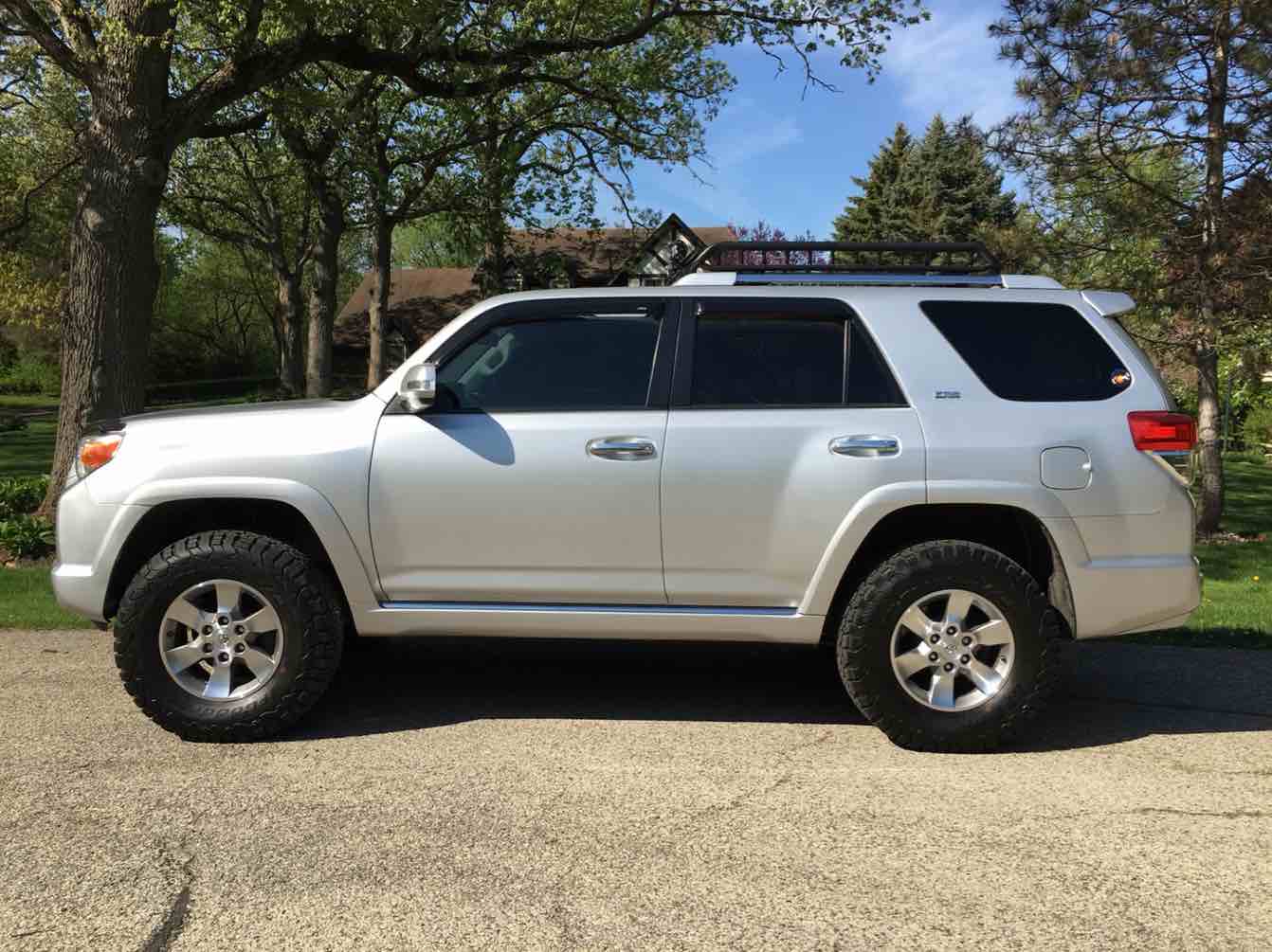

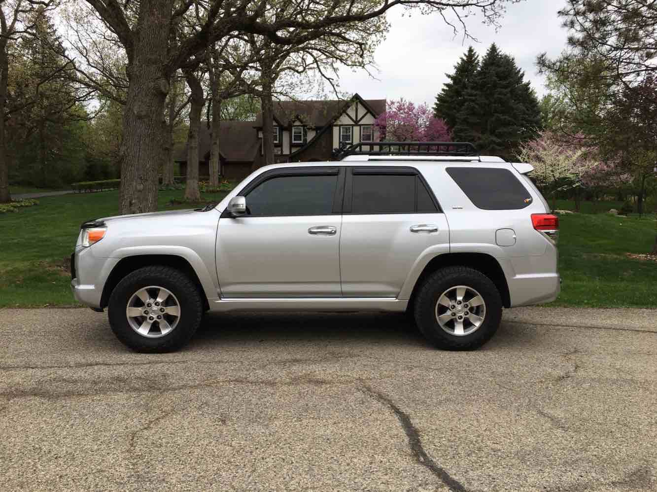

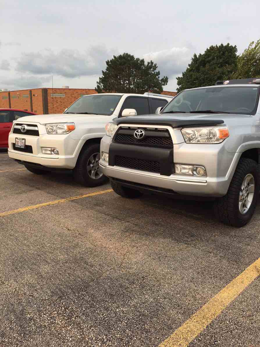

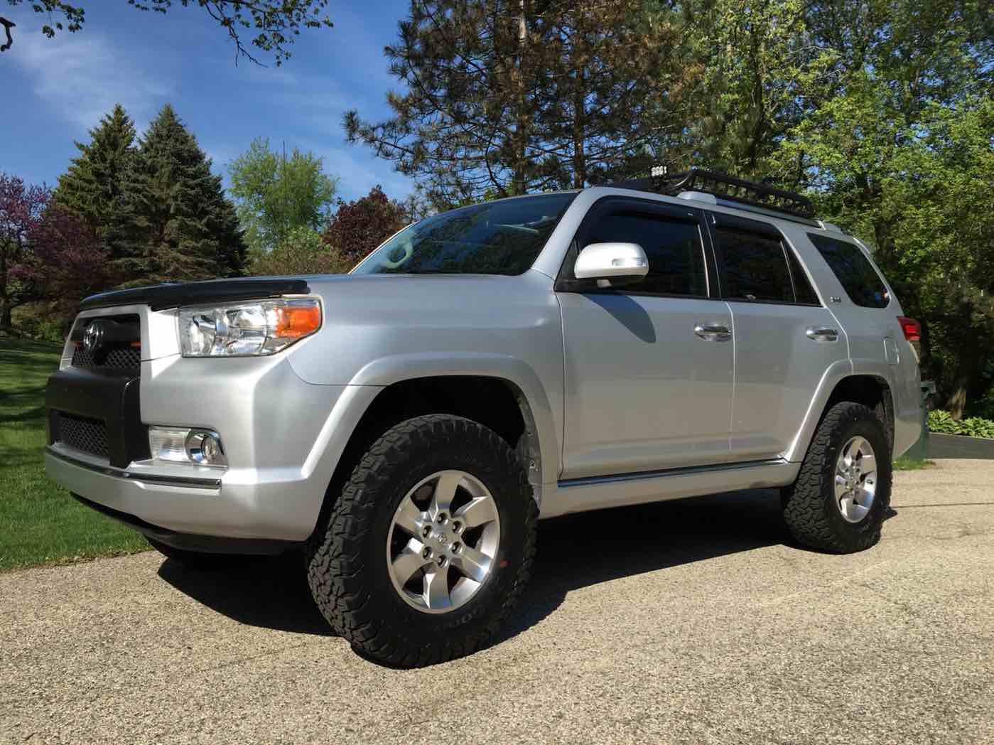

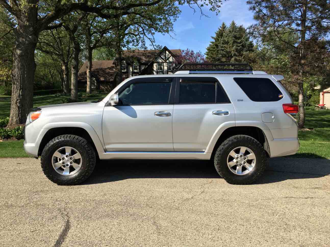

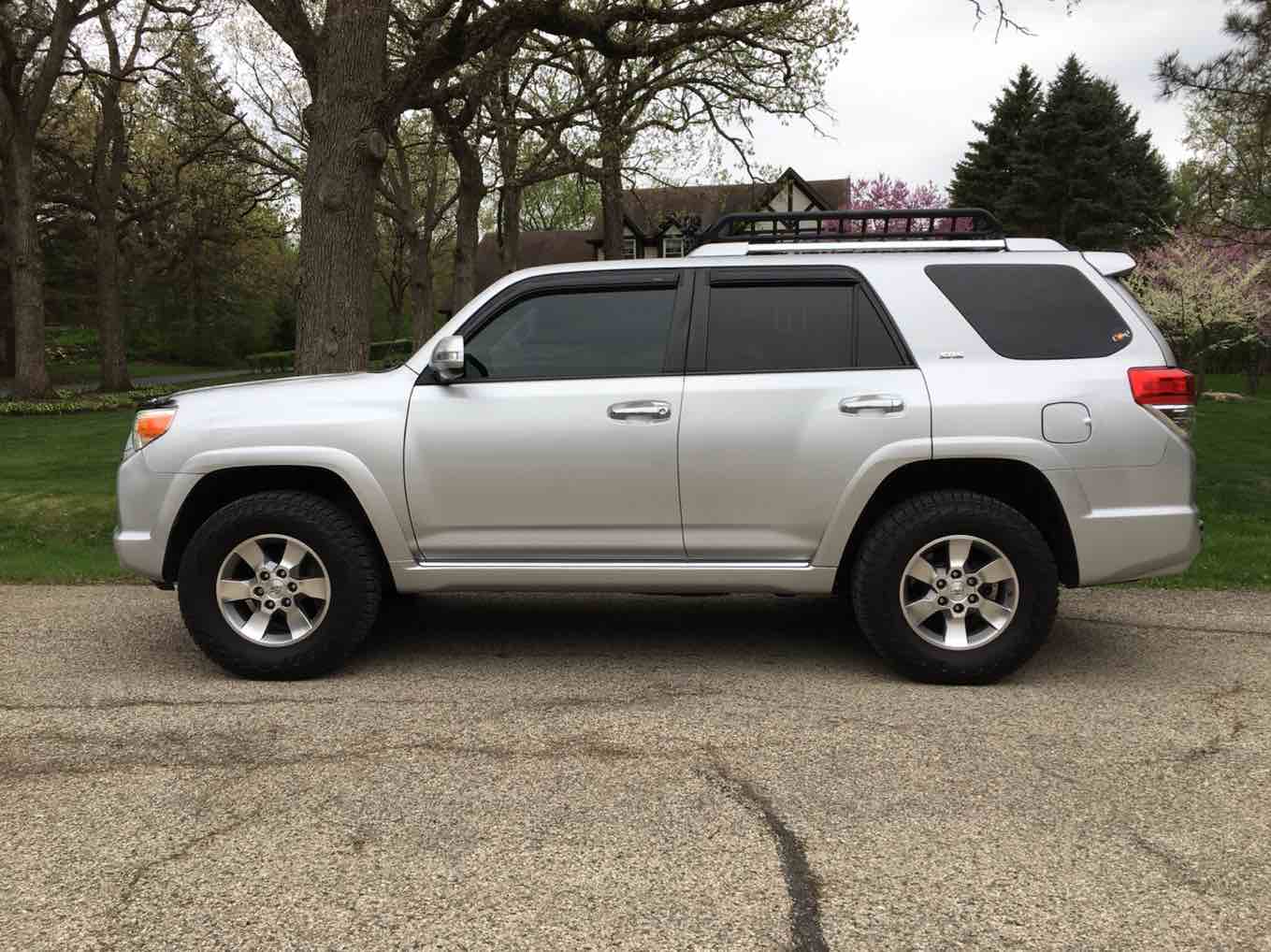

For those looking for reference, I recently changed my original 5100 setup from one classic setting to another.
My original setting was .85 front, stock rear on factory sized 265/70R17 tires (Falken Wildpeak AT3W)...This setup was great and I loved the ride. It just ended up not being noticeable to anyone but me and I needed the little extra lift for off roading.

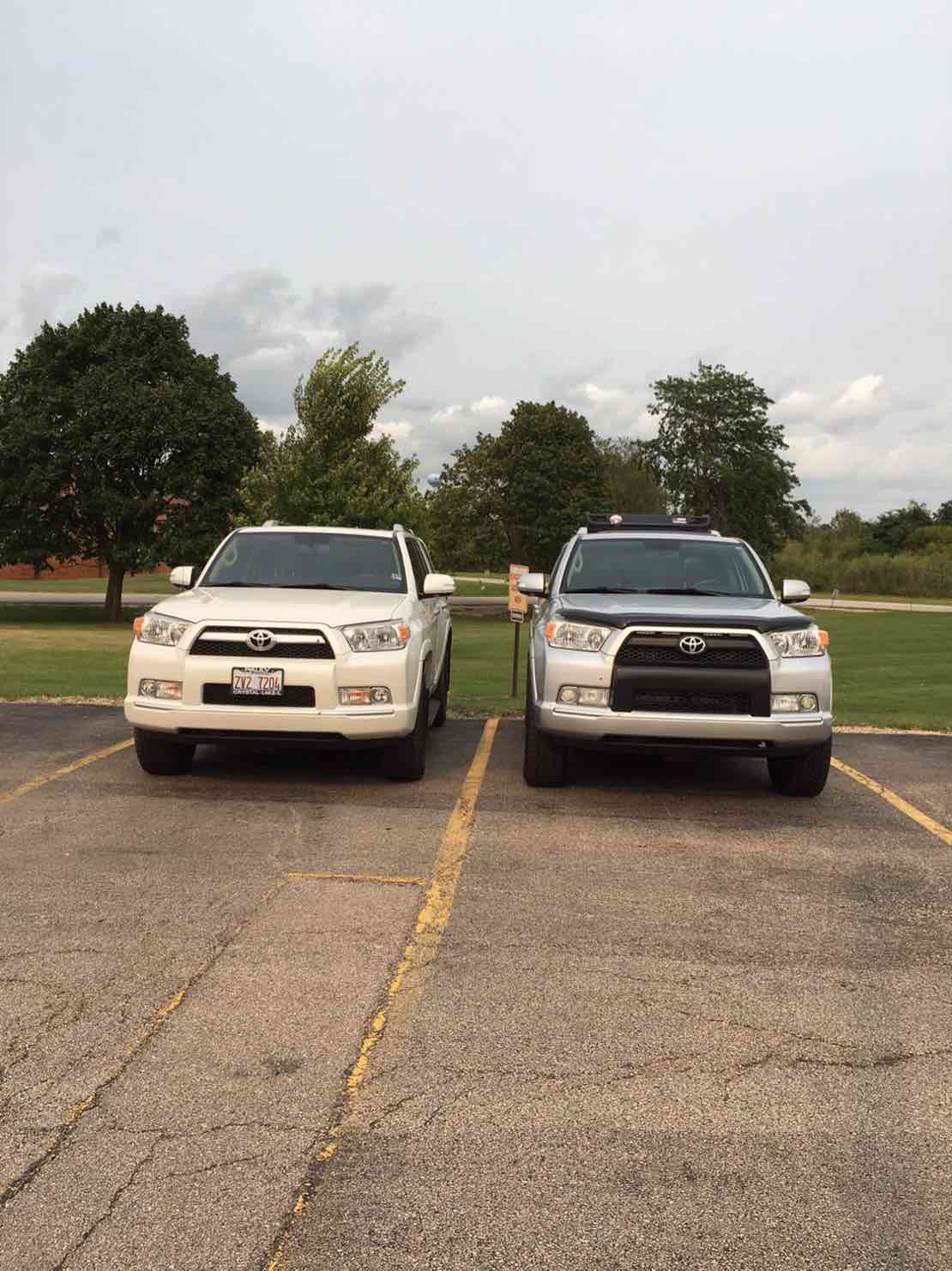

Next to a stock 4Runner

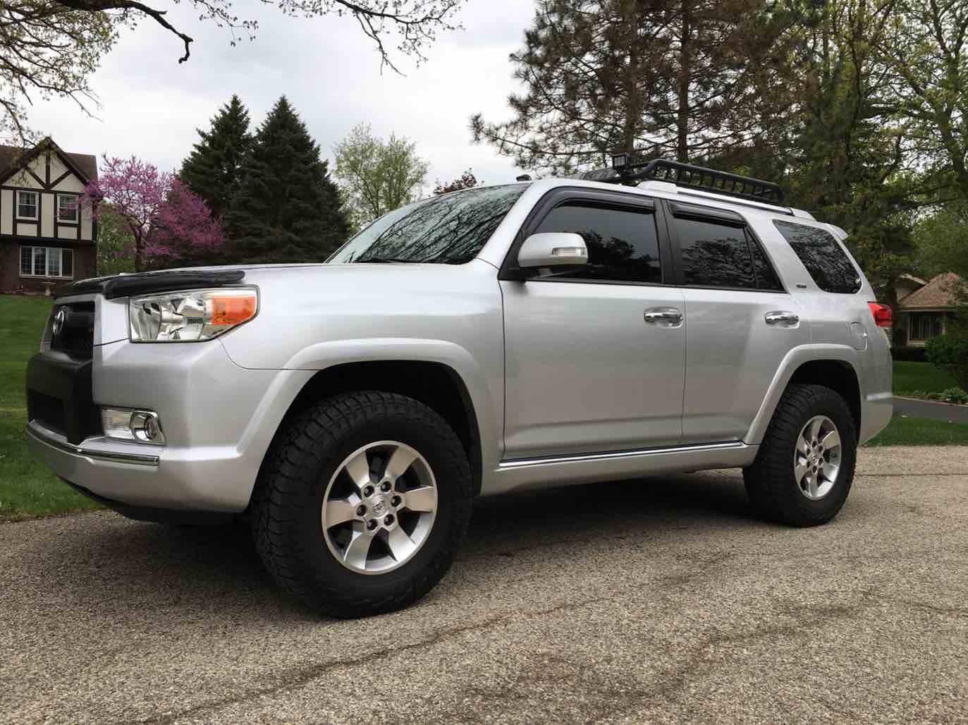

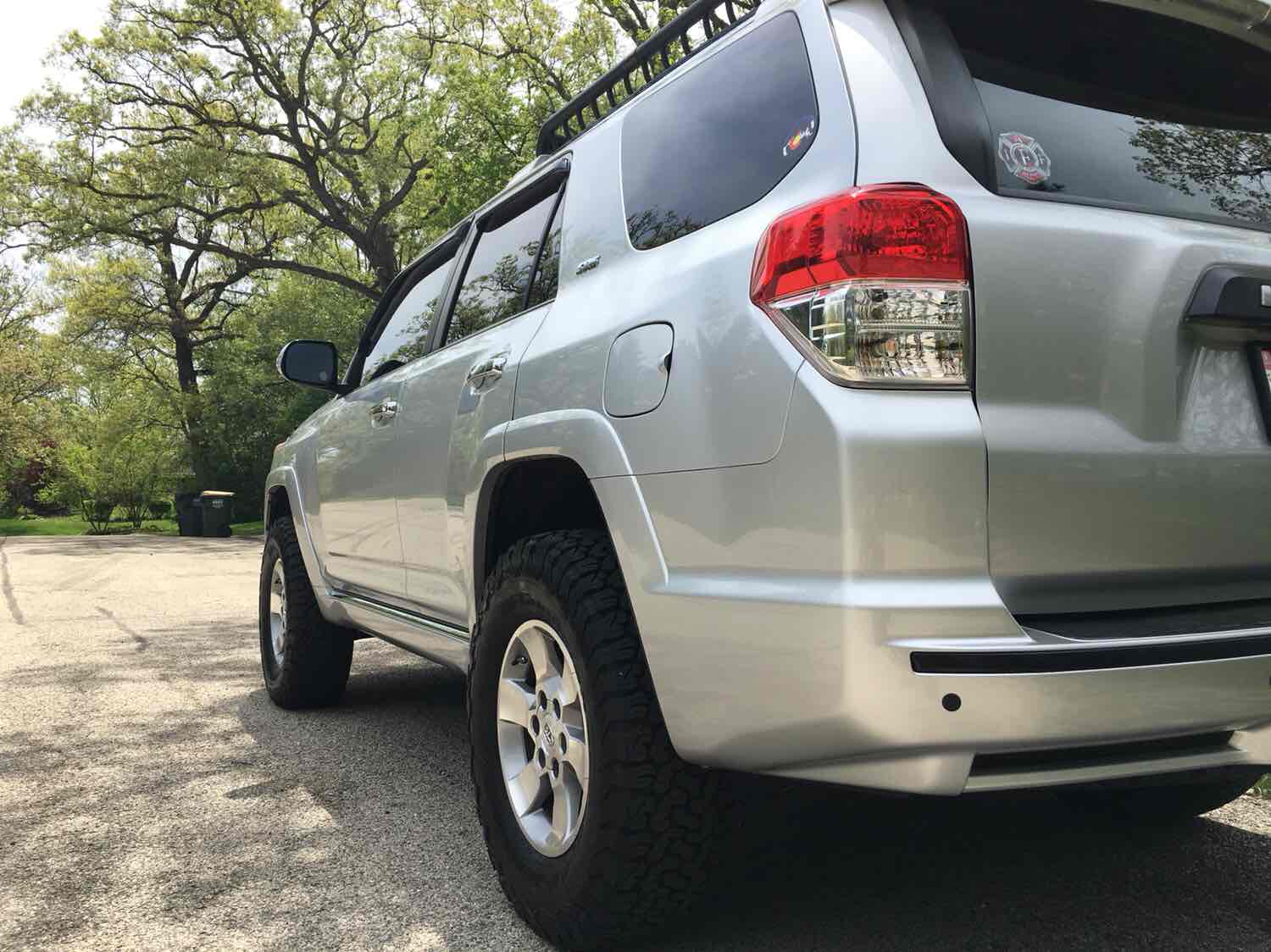

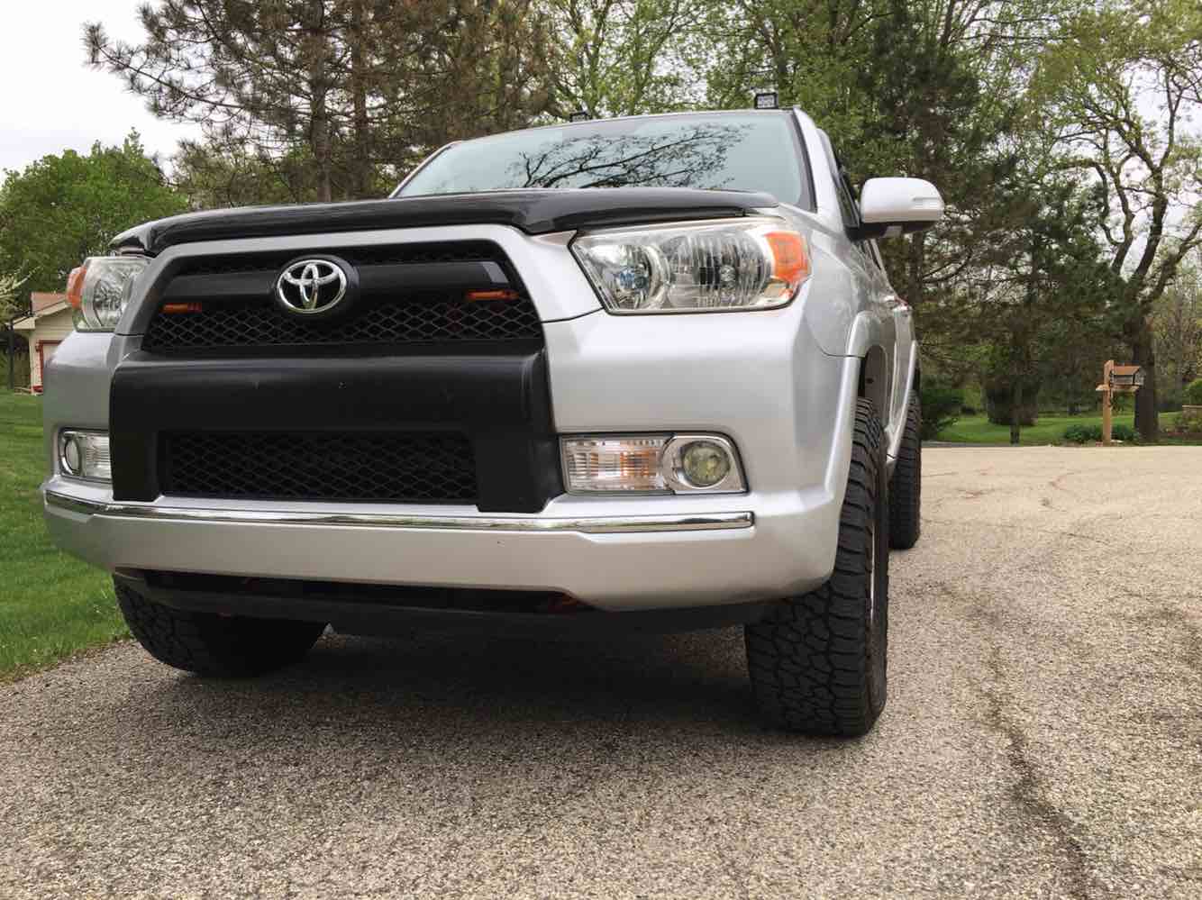

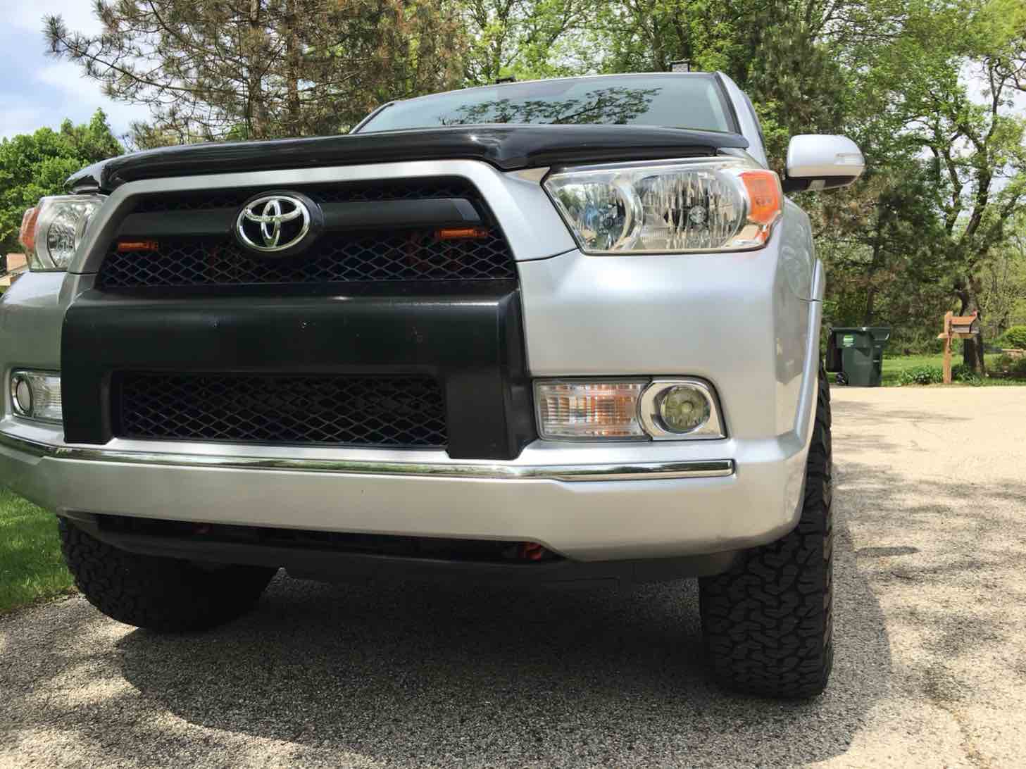

Before shots:
.85F/stock rear 265/70R17 Falken Wildpeak AT3W. Spidertrax 1.25” spacers
After Shots:
2.5F/1.5R daystar spacers, BFG KO2 285/70R17 C load, Spidertrax Spacers

Hope these help someone in a similar situation I was in.
