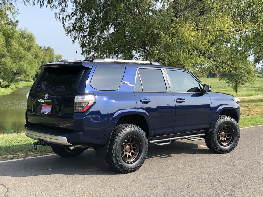

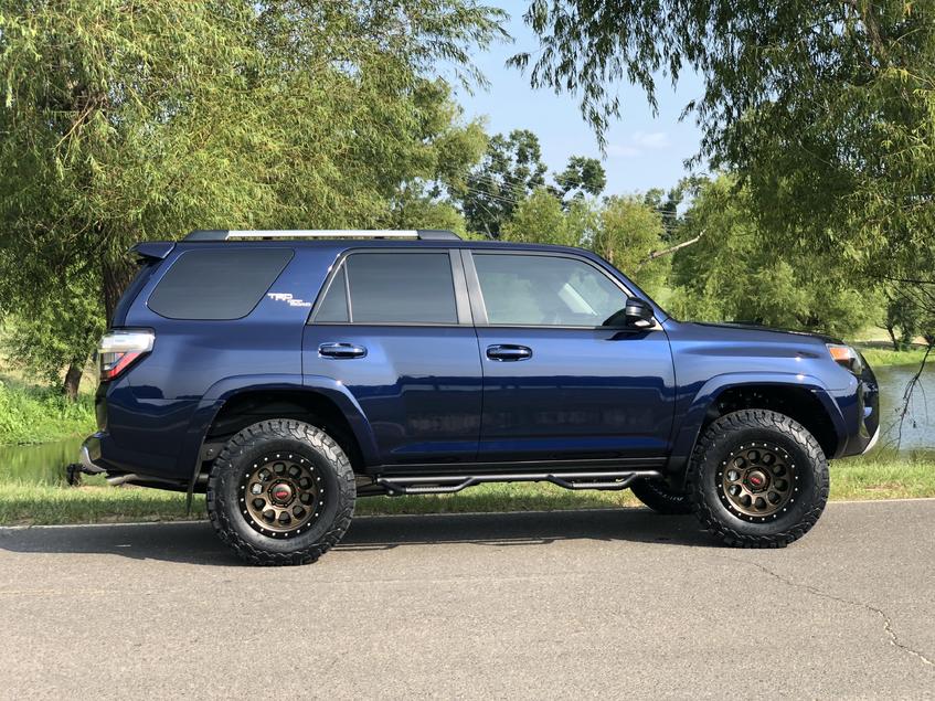

Another Bilstein 5100 question
5100 all the way up in the front.
Rear 5100 on day star levlers.
Stock rims and tires:-)
Parked next to a TRD Pro so took a pic for comparison....I'm happy with my results!
5100s with 1" Cornfed in rear, 275 BFGs on ICON wheels

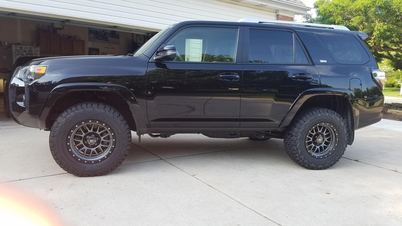

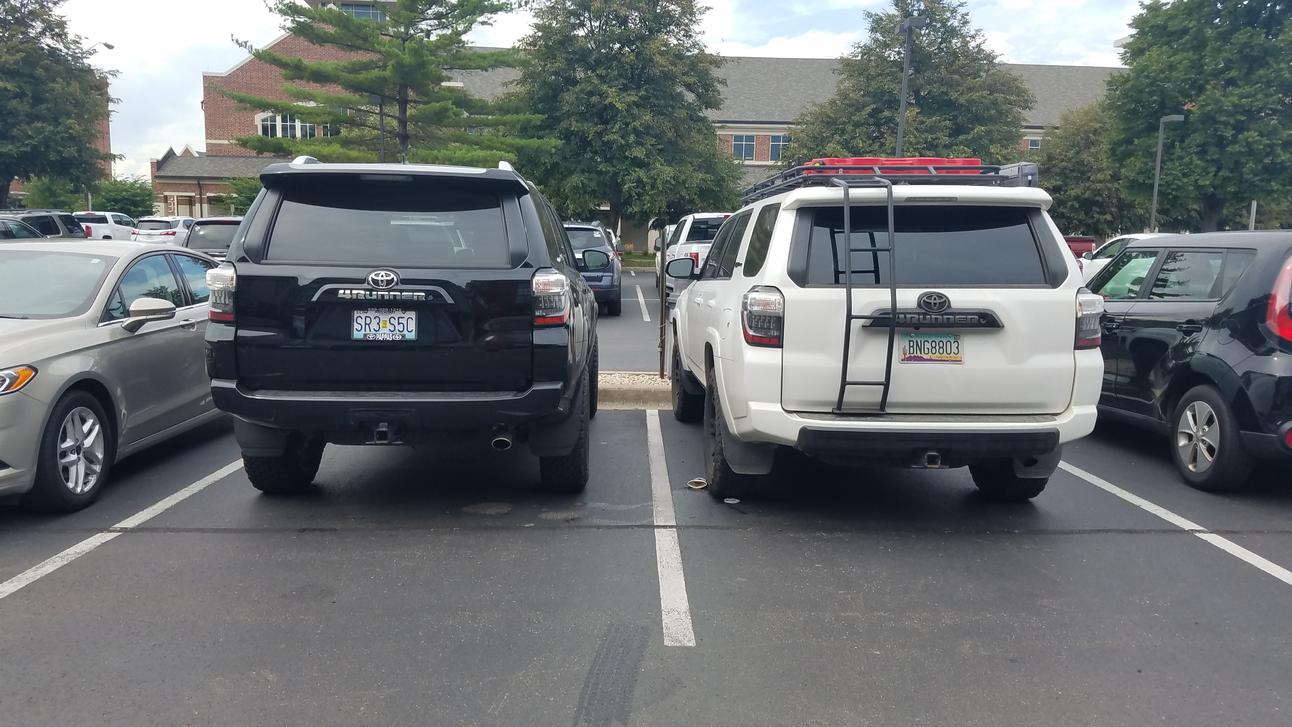

My buddy just installed some 5100's and NO spacers or other lifts. He set the front to the max height setting (2.2 I think) & he has a nearly perfect level truck. He's on 275 KO2's and stock wheels and it looks amazing. I thought for sure he'd have some reverse rake with the 2.2 setting up front but he doesn't, not even with his hitch bike rack and mountain bikes sitting on them (which would pitch the nose up additionally).
Because of this, I'm sold on doing the max height setting for the 5100's up front and not doing any spacer in the rear. It looks really good on his truck and as I said... level.
Truck may look level but no way frame is. I bet with the trunk full it would look silly. I am at 1.75 with cornfeds and am very happy. Looks killer and no nosedive
Any additional pics of your setup @TikiJoe? What are the billy's set at? Thanks!

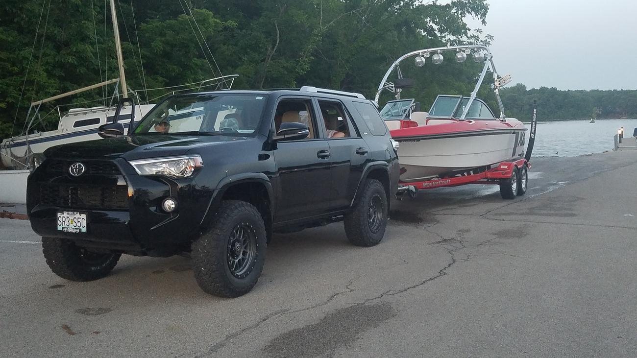

Sorry for the delay I haven't been on here. Here's one with the boat hooked up so the rear is sagging a little bit.... 1.75 upfront

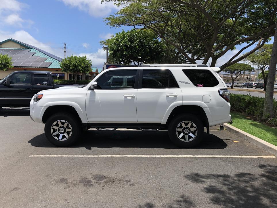

To each his own; you are more than welcome to try/do it.... But I'm telling you, somethings not right with that. Either he isn't on the highest setting, or something else is going on. TONS of us have all done this mod, and you WILL HAVE NEGATIVE rake with that setup. Heck, there is approx 1/4 inch negative rake at the 1.75 front setting and nothing in the rear (tho the fenders will look level).
The pics below are 1.75 front (which is NOT the highest setting) and stock rear... And it's level to the eye, but slight negative frame rake.
Again, do as you please, it's your rig, your time, your money. But with a completely stock 4Runner, 5100s at all four corners, and the fronts set to the highest, you will not be level.
