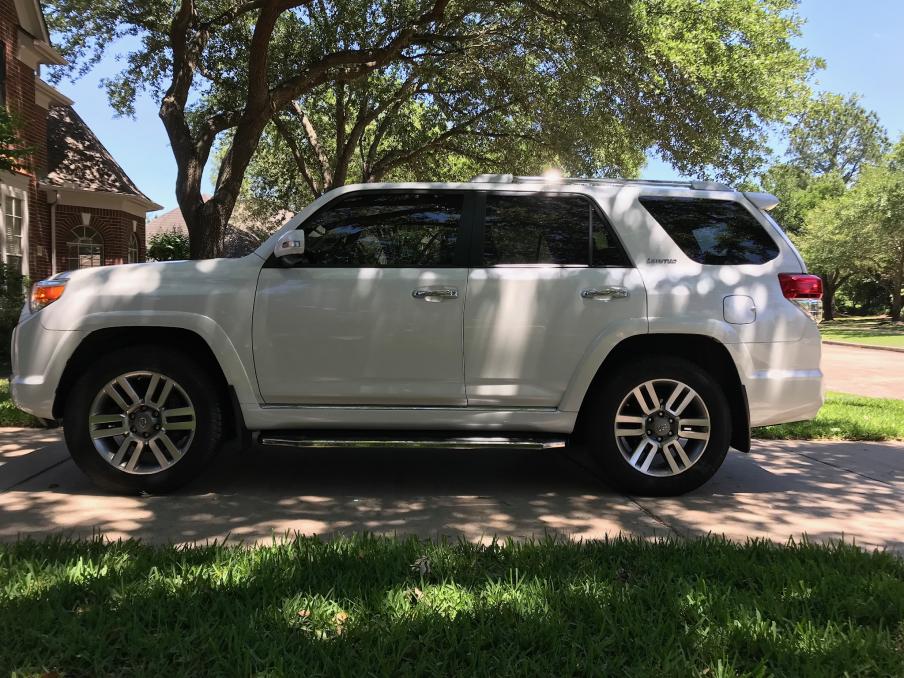

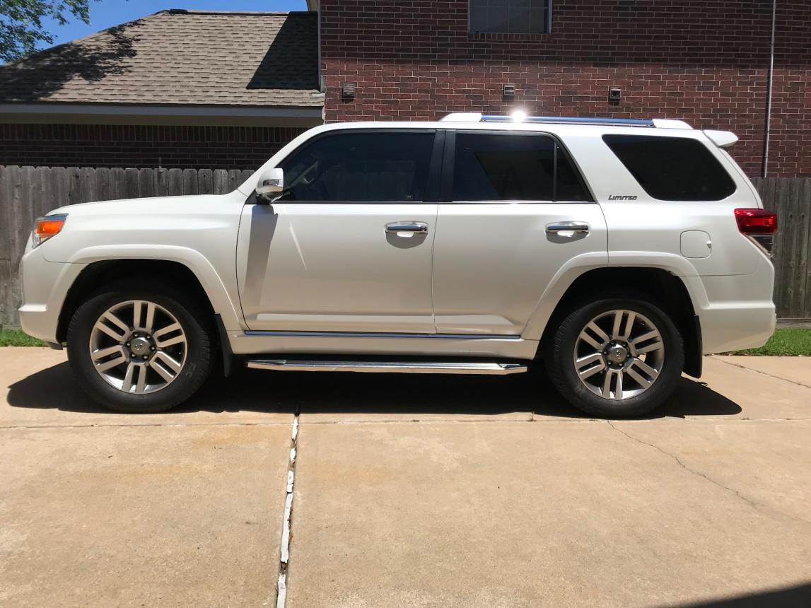

Yep! Here’s my 2012 with Bilstein 5100’s at 0.85” lift up front.
Those look like 20" stock tires on a limited. Is that the case? If so what size tires do you have on those rims? I have the same rim with 275/55/20. Not sure how I like that size tire. I will be doing the same lift as you. Bilsteen 1.75" on front with 1" spacer on rear with bilsteen.
They are Michelin LTX M/S2 P275/55R20 111H on stock rims on a Limited.
