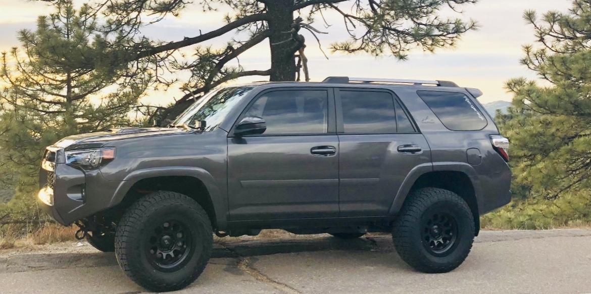

You're welcome. And in my case, just 5100's @ 2.5" in the front (no rear lift) set the truck 1/2" higher in the front than the back.
A 1" rear lift should give you a slight "rake" but close to level (see my pic above), 1.5" might be too much for you based on your comments.

FWIW, your truck looks like it sits about 1.5 inches higher in the rear. Looks like the same amount of "rake" I have, but I'm on somewhat even pavement.

The pic of your truck the front still looks higher than the rear.

Sorry for the delay, I got sidetracked after taking the pics...
looks great! would you mind sharing your hub to fender measurements on both the front and rear?
thanks
It's definitely higher in the rear, even if your perception is different...
When I looked at it evenly, these are the measurements I saw. Even if the pics don't exactly show it.
Front = ~21.75" / Rear = ~22.75"
