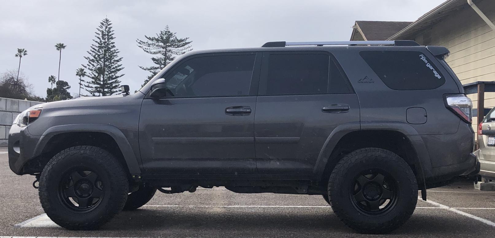

He guys this is my 2018 Off road. 5100's on all 4 corners with front set to 1.75. Rear is Dobinson C59-599 that gives a 1 inch lift. Rides so much better than stock and rides very similar to when the 5100's were set at .85 with stock rear. Zero rubbing so far with the 33 ridge grapplers . And holy cow the ridge grapplers are about 1/10 as loud as the 265 duratracs they replaced
Sent from my Pixel 3 using Tapatalk

Looks good.
What was your reasoning to go with a spring in the rear over a spacer?
I assume a lift in the rear with a spring should give you more rear travel but your front is still running the stock spring/travel right?
sorry if newb question
