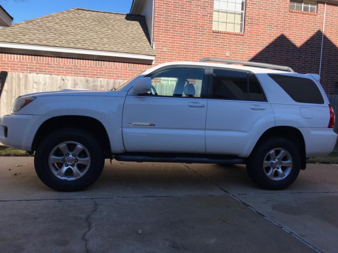

I didn’t replace any springs, kept all stock. On the 06 4WD, I did the max lift setting up front (something like a 2.25” lift), and added a 3/4” poly spacer for the rear and it looks perfect. On both the 06 and 12 2WD’s I used the second clip position for the ~0.85” lift up front, with stock for the rear. The first clip position would be used for no lift/stock look setting.
The first image below is the 4WD (no sunroof), the second is the 2WD (sunroof).

Nice looking 4Runner. If you had to guess how much lift you got on the drivers with just the .85 in front what would it be?? The reason I'm asking is I don't want too much so I can't step into mine anymore.

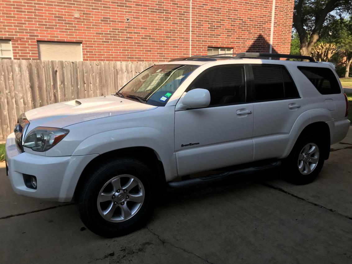

Heres another bilstein set up front 1.75, rear bilsteins with 1"cornfed spacers. Lift vs. Stock in the second pic.
Looks Great! What year is this? It looks identical to my 2011 Limited with 20" stock wheels. Mine is not lifted, but since the xreas on my is shot, I'm going with what you have. Thanks for the photos!
