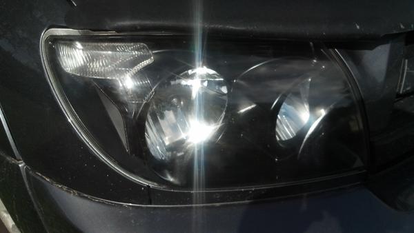

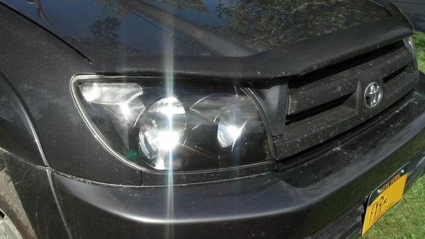

Blacked out my headlights last night. i left the orange reflector in but tinted it.
now im starting to think the fog and marker light down there could use some darker shades
looks good Adumb now you just need to give her a bath
