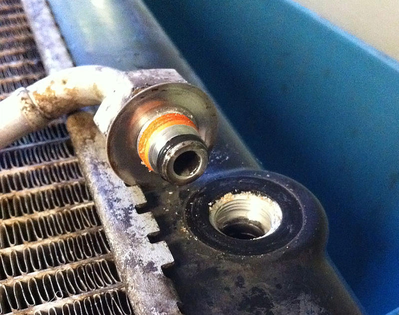

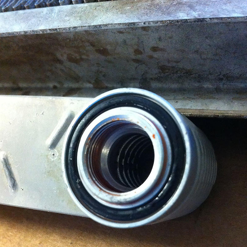

I changed my radiator out a few weeks ago. The truck, just purchased a couple of months ago, is a little over 100,000 miles, '99. I plan to do the bypass in a few weeks.
The images are of the fitting where it screws into the rad and the threaded part of the cooler. I have seen a pic where these parts were corroded. Mine looked fine, though the top of the rad was turning that brownish color. I guess I replaced a good radiator but I am fine with that. Something else baselined that I will not have to worry about for a while.

Milkshake is due to a corrosion failure inside the radiator that allows two liquids to mix, doesn't really matter if towing or not. More of an age thing.
