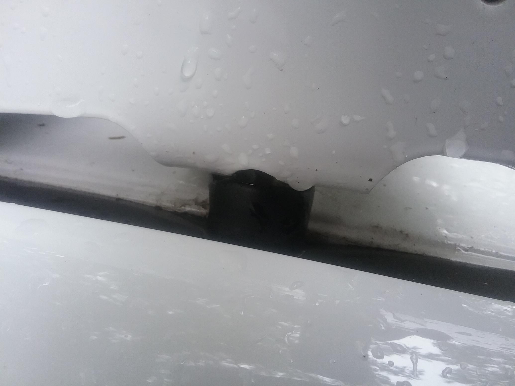

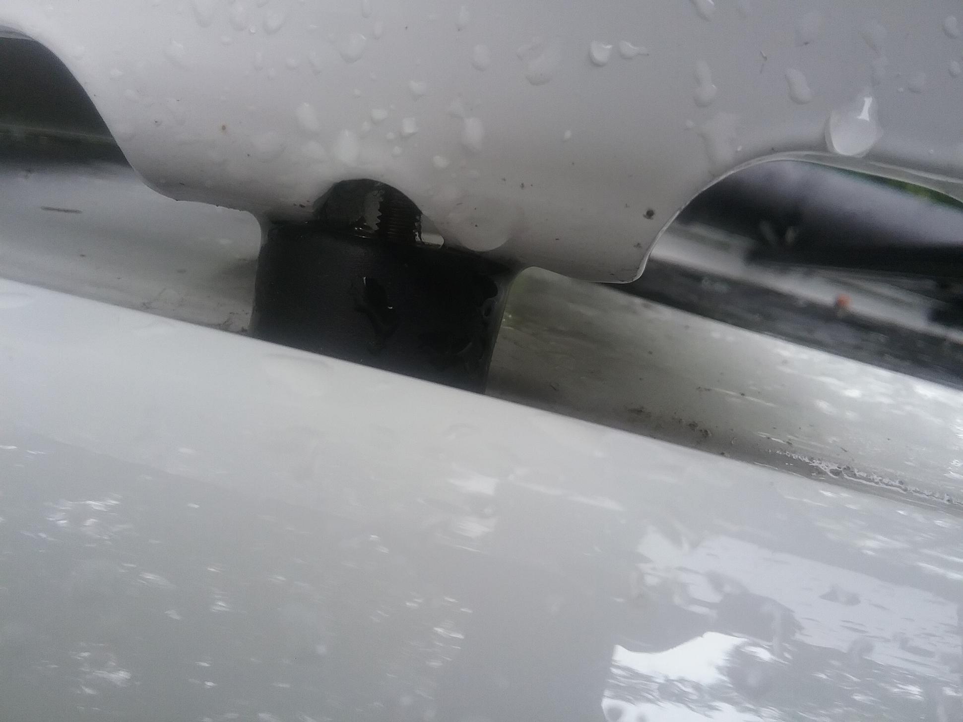

Has anyone tried mounting the full length Prinsu without drilling the two front holes?
I've had mine mounted with out drilling for about 5 months. I used 1" wide by 1" high rubber cabinet feet. got them from Parts-Express.com part number 260-744
I did trim them down a little but they have worked great, haven't seemed to move.
I have had decent loads on it so far but i try to put the weight towards the rear.
Here are a couple of pics.

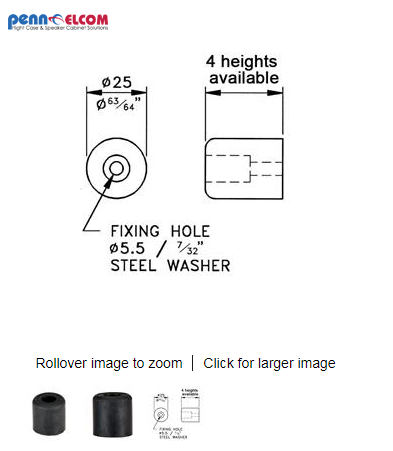

How did you mount the feet? Directly to the screws for the front of the rack? Did they require drilling or something to seat in the rubber mounts? Any signs of cracking after weather and sun exposure?
TIA
I used a 3/4 stainless screw and locknut. put the head of the screw in the bottom of the rubber foot so the threads are showing where you will attach to the rack. see pic to see diagram of foot. this one has a metal washer embedded in it. I had to trim the foot down by about 1/4 inch.
https://www.parts-express.com/penn-elcom-f1691-rubber-cabinet-foot-1-dia-x-1-h--260-774
