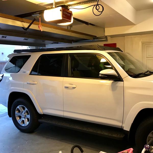

Bet you're excited to get the rack all mounted up! See below for the photos.
did you punch the rubber strip to make space for the foot? or does your foot go on top of the rubber strip?
Nope didn't punch the strip or anything. There's metal running through it and I didn't want to muck about with it. The rubber foot is simply resting on it.
Anyway, here are some photos... Let me know if you guys need anymore details.
Pulled my Gobi and installed the Prinsu. Two weeks from order to delivery. Powder coating was perfect. Great product. Very quiet and much better MPG hwy the Gobi.

Looks killer! It looks way better on yours then on my stock asz basic ***** white one:typing:
