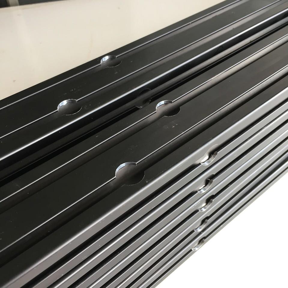

I got tired of having to remove my awning every time I added, removed, or moved something on my Prinsu rack. So I took all of the cross bars to a local machine shop and had them mill access holes to drop in or remove carriage bolts.
Other folks who have done this had all four in a row, but that seemed to me like it would weaken the bar, especially right on center. So I had mine staggered and offset one inch either side of center. There are no access holes on the bottom. This ought to make it easier to work with!
Looks nice. What size are holes?
I don't know. I asked them to use whatever end mill they had that was barely larger than the head of the carriage bolts I'm using, which are .580" OD. And I can't get to my calipers that measure ID.
You would want them to fit whatever carriage bolts *you* are using, anyway. Not what fits mine.
I had mine milled with an .600 mill. I haven't run across a 1/4" carriage bolt that won't fit yet.
