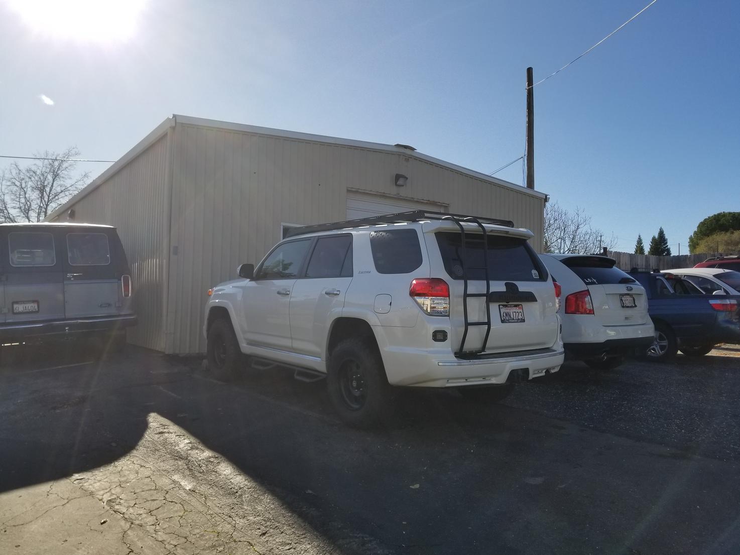

Can you attach a ladder to the prinsu rack? Gobi sells one but i would pull the trigger on the prinsu rack if I can put a ladder on the back.
I've got the Prinsu full length with the Baja Designs ladder. Love them both. (not the greatest pic)
