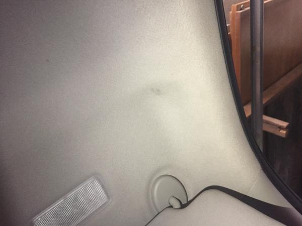

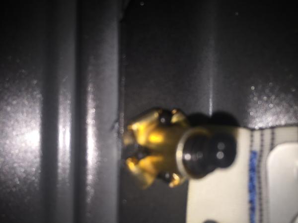

A couple months ago I noticed this on top of my headliner on my passenger side:

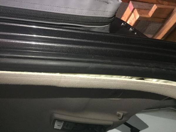

I wasn't sure if it was dirt or from the hole I had drilled so I immediately thought aw crap I f'ed it up and now I'm going to have to pay for the consequences of not having it done professionally. I decided to take a look for myself and looked up ways to partially take off the headliner so I could take a gander to see how bad the damage is. Theres plenty of questions about doing this task and some pictures with it already removed but not much detail. If you'd like, follow along and I will show you how I partially removed the headliner, or just skip past all those steps to see the end result of how it looks underneath your roof and if there was any rust.
I started all this like aforementioned, searching the forums, and couldn't find anything productive. I started prying at the liner with a flat tip to see where it's mounted. Since this is on the passenger side I will show you the steps for THAT side. I assume the driver side is similar. Here is everything simplified:

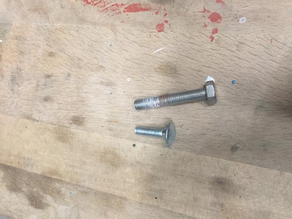

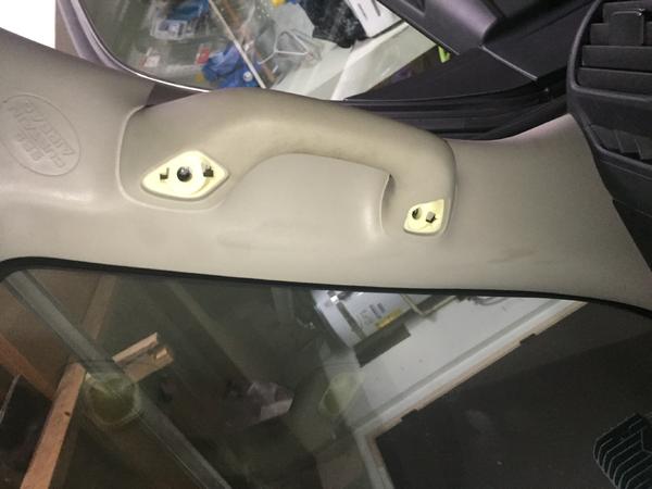

1) Remove (2)Oh Shit Handles:
Use a flat head and gently lift the (2) covers off, (2) Size 11 Metric bolts I believe, take them out. Handle can be pulled off right after.

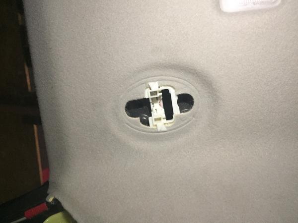

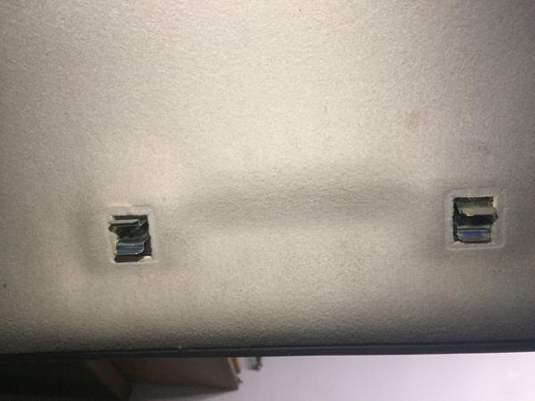

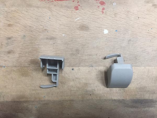

Pull the handle down, take a flat head and gently lift the bottom of the (2) tabs to pry if away from the mount. After it comes off a little you should be able to pull the tabs off by hand. The tabs will come out and take a slight turn out. Picture below shows what they look like and how you will have to turn them out:
Once you have these out, you can pull the handle from the metal clips. You can also pinch the metal clips together and pull the metal clips out. It will make it significantly easier to put the handle back in by pulling the clips out as well.
2) Remove (A)? Pillar
This should literally come right off once the handle is removed.

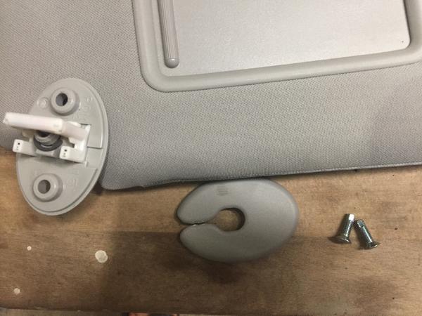

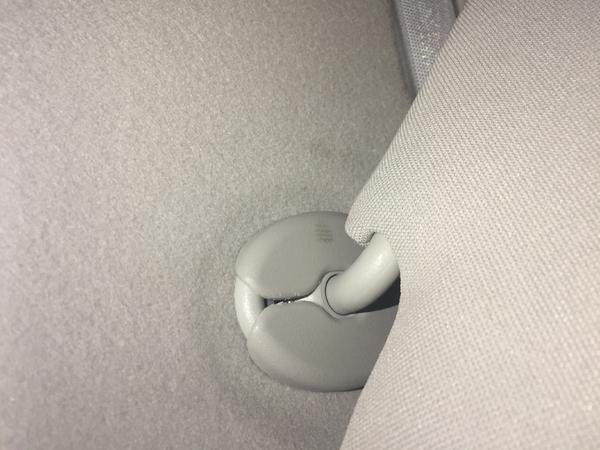

3) Remove Sun Visor
Flat head again or something similar to wedge this gently apart and pull it off with the visor mount sliding down the middle. This will expose 2 Phillips screws, take them out, and remove the visor.

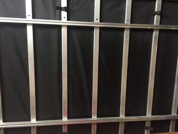

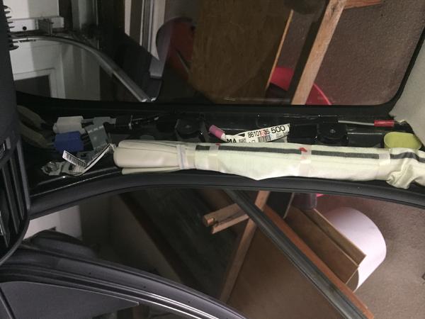

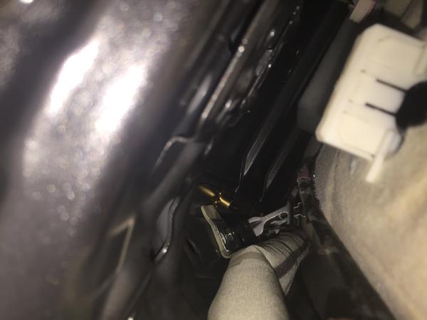

At this point you should have enough room to slightly pull down your headliner and take a look up with a flash light.

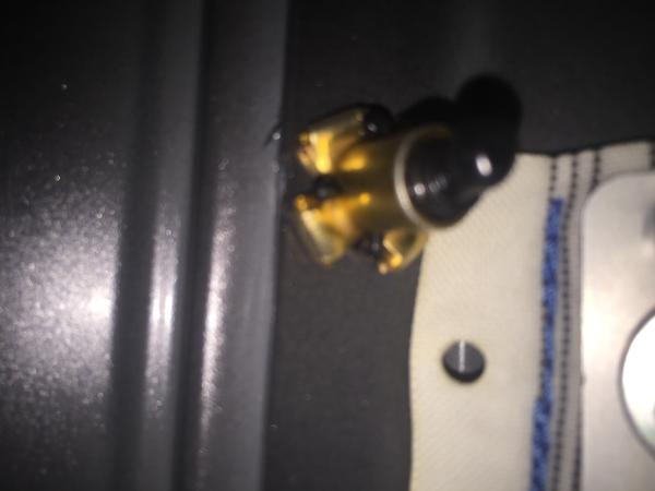

Here are the results:
It's that gold thing back there.
It's perfectly fine! Stop being a pansy and thinking so hard about it and get the full length option and drill in to your car!

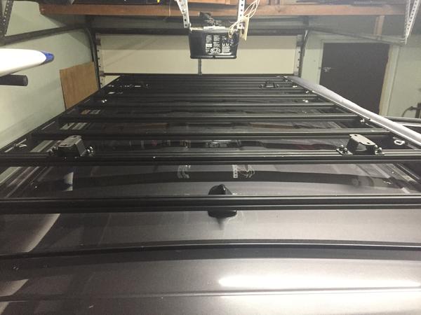

Roof Top Tent Mount:

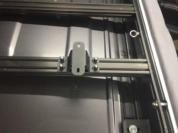

I coughed up the $120 or so and got the Prinsu mounting foot for topracs. I got this idea from someone on instagram. I believe he has a white 5th runner and lives in Vegas. I don't remember your name buddy but I stole this from you. Credit goes to you.
I have a goFSR M55. I bought the standard toprac feet at 1.5", which, with the addition of the channel for the bolt of the tent. puts me about 2.5" of clearance above the rack. Enough for me to get my hands in and bolt everything down comfortably without moving crossbars(which I tried and hated).
The only issue I have is that the bolts for MY TENT to mount to the rack are bigger than the holes on the toprac feet. Obviously if you have a different tent you may or may not have this problem.
This can be remedied by drilling a larger diameter hole in to the toprac feet or getting a smaller bolt that will still slide in to the channel of the rack tightly. You can also modify the channel that your bolt slides in to on your roof tent to be smaller.

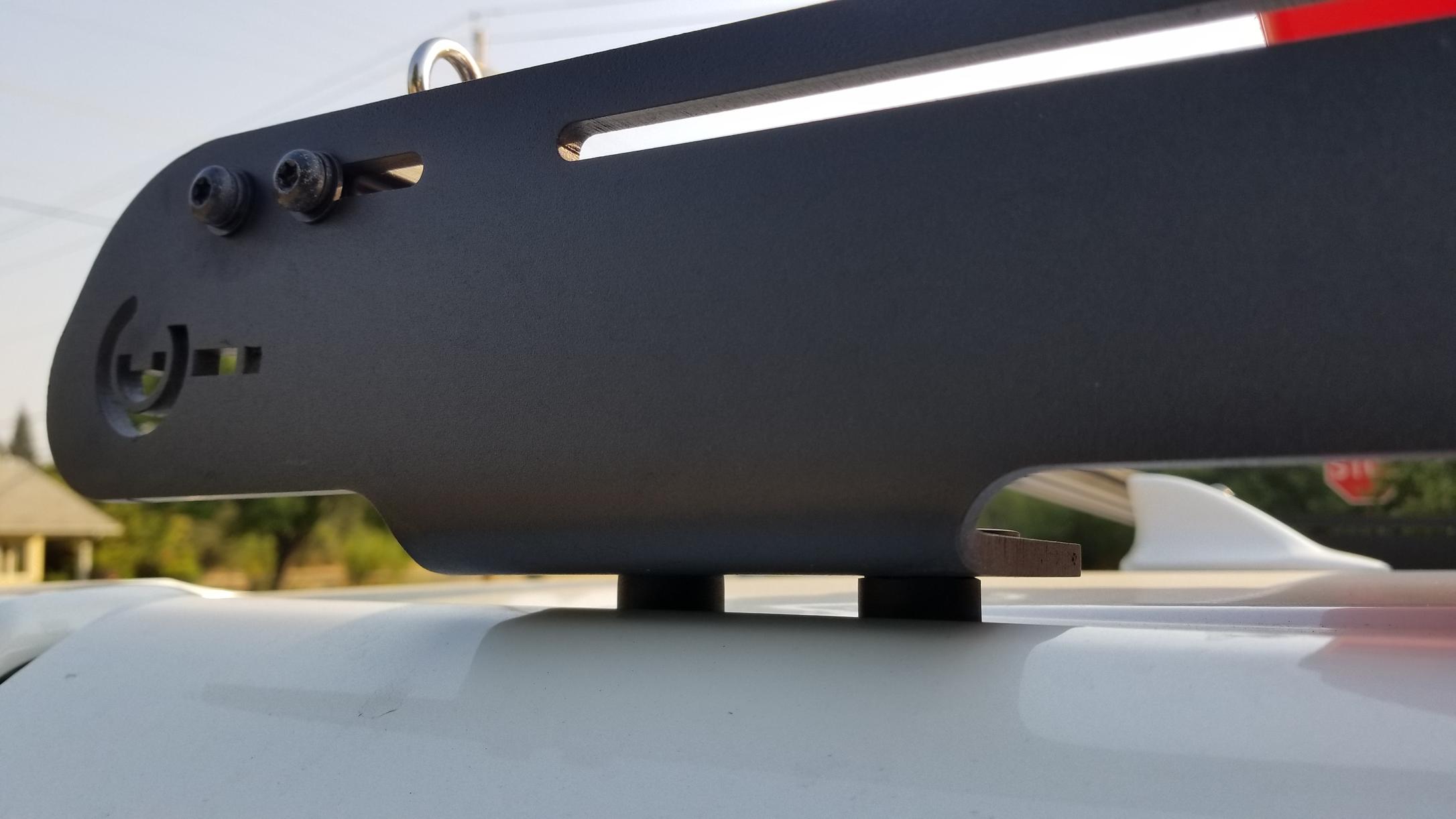

All of my spacers were the same size. I came across the post you found too.
Also, I didn't like the look of the aluminum spacers so I used heat shrink (for large diameter wires) to give them a strong black finish. Paint may work too but I didn't want to deal with it flaking off.

I painted mine.
