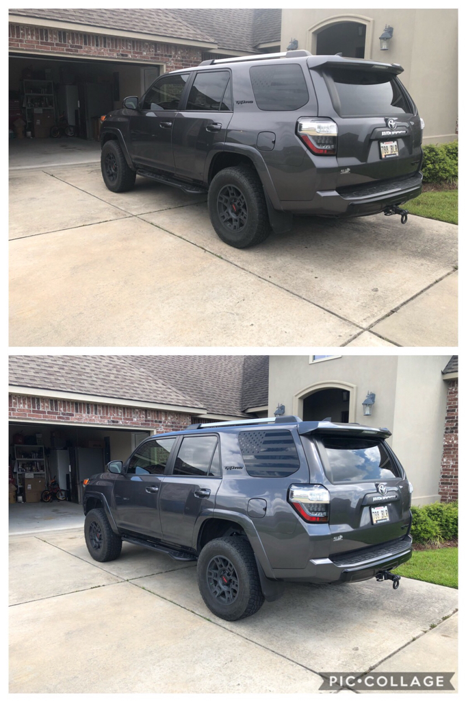

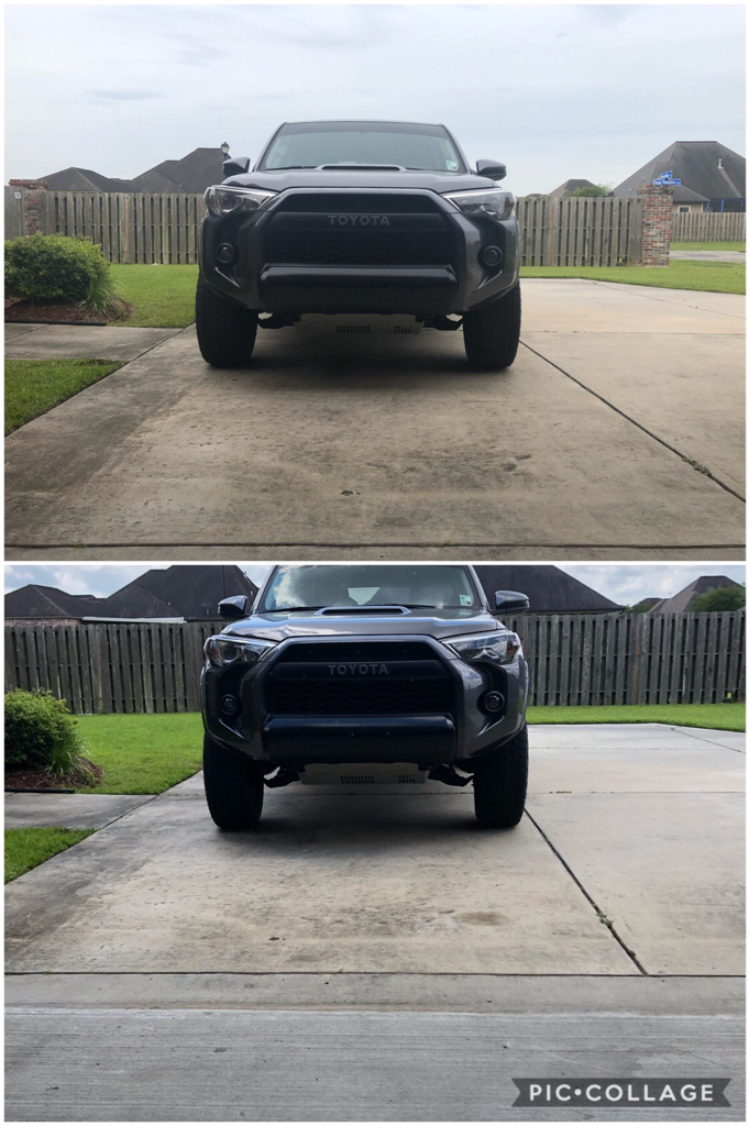

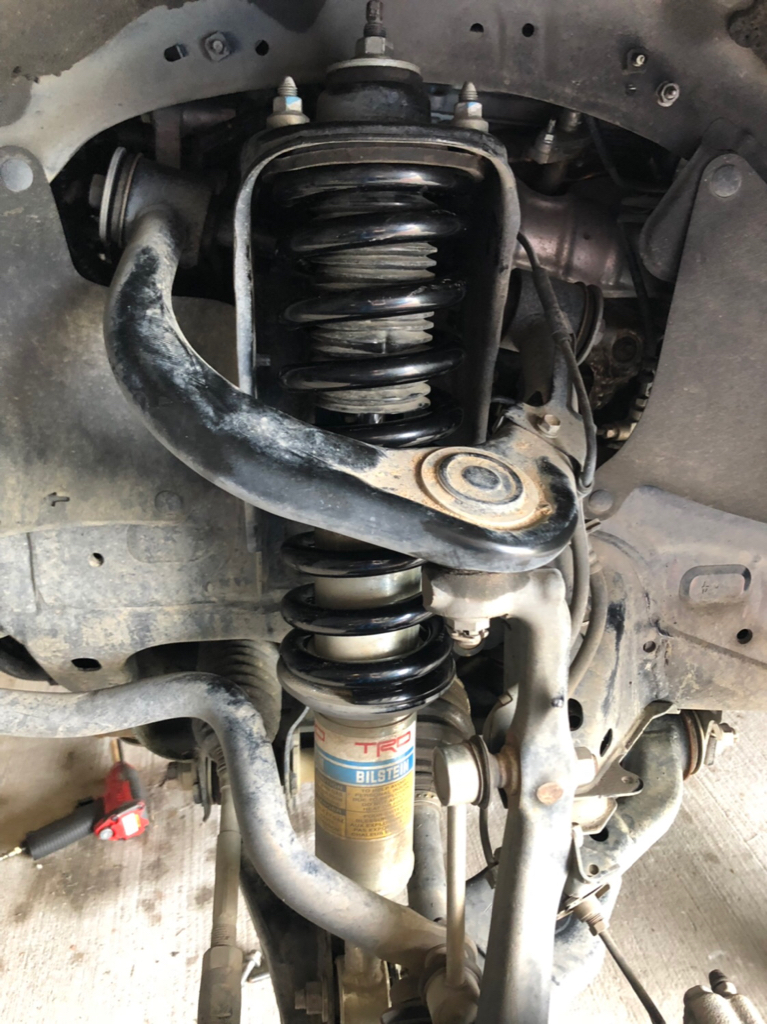

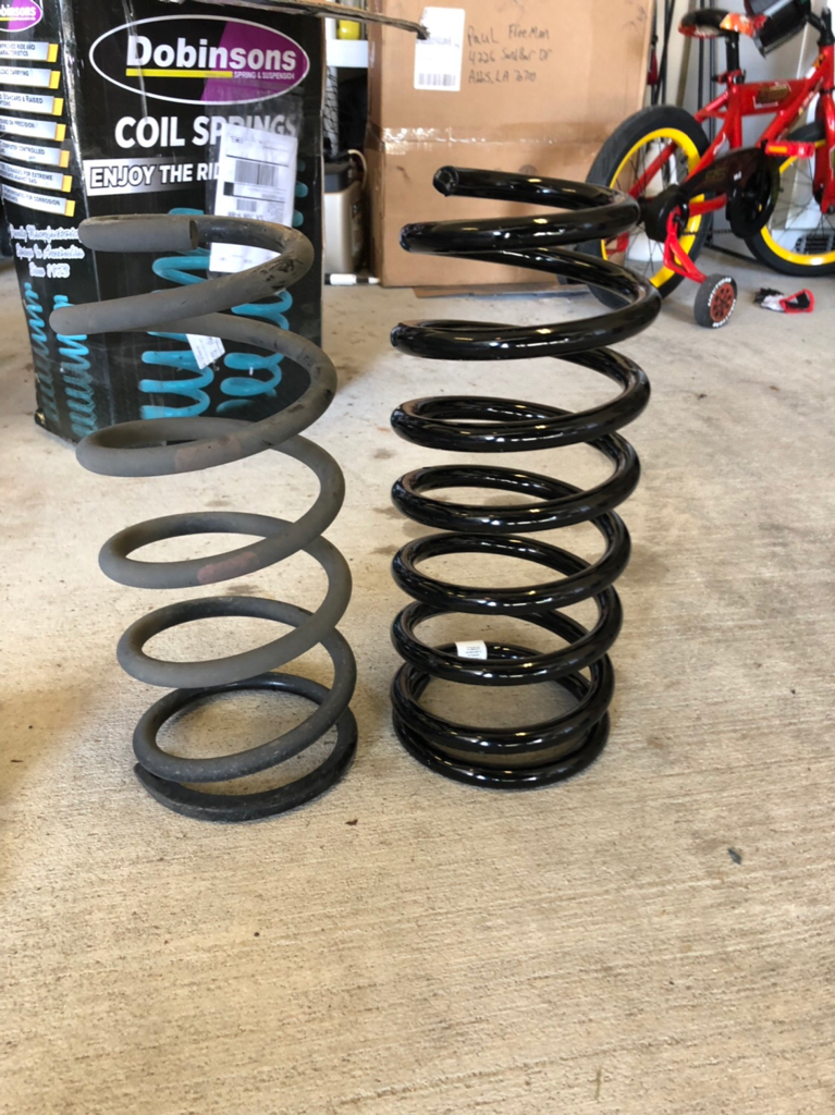

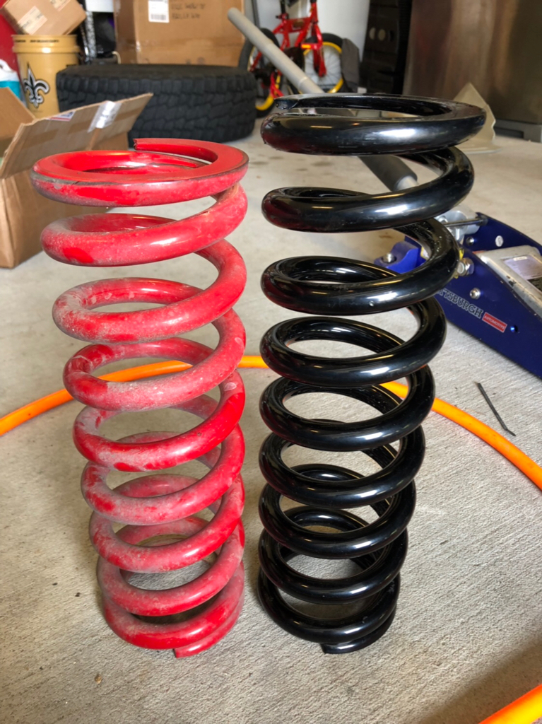

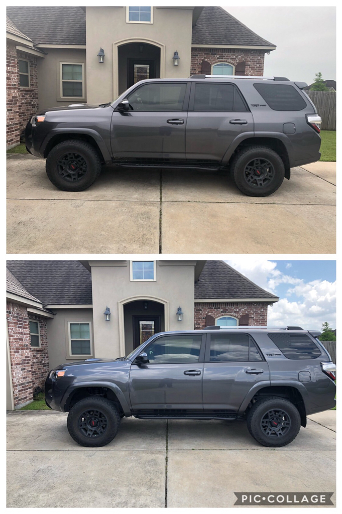

Finally got a day off to install my 6112s and Dobinsons 599 1.25" rear springs. Front was lifted about 2.5" and rear about 1.5". I did it using the no spring compressor route and it was the easiest spring swap I've ever done. Took me about 3 hours to do the front and rears. First front spring took about an hour the other side took about 20 minutes. Rear was a bigger pita then the fronts for sure. Did it all by myself. A good helper would have cut the time down quite a bit. I'll include before and after pics below with the measurements.
Install tips :
1. Tall floor jack and jack stands.
2. Loosen bolts on LCA mounts and lower strut mount before lowering LCAs. This will allow the arm to completely fold down.
3. Lower ball joint bolts and lower strut bolt have red loctite so an impact or a good breaker bar is very helpful.

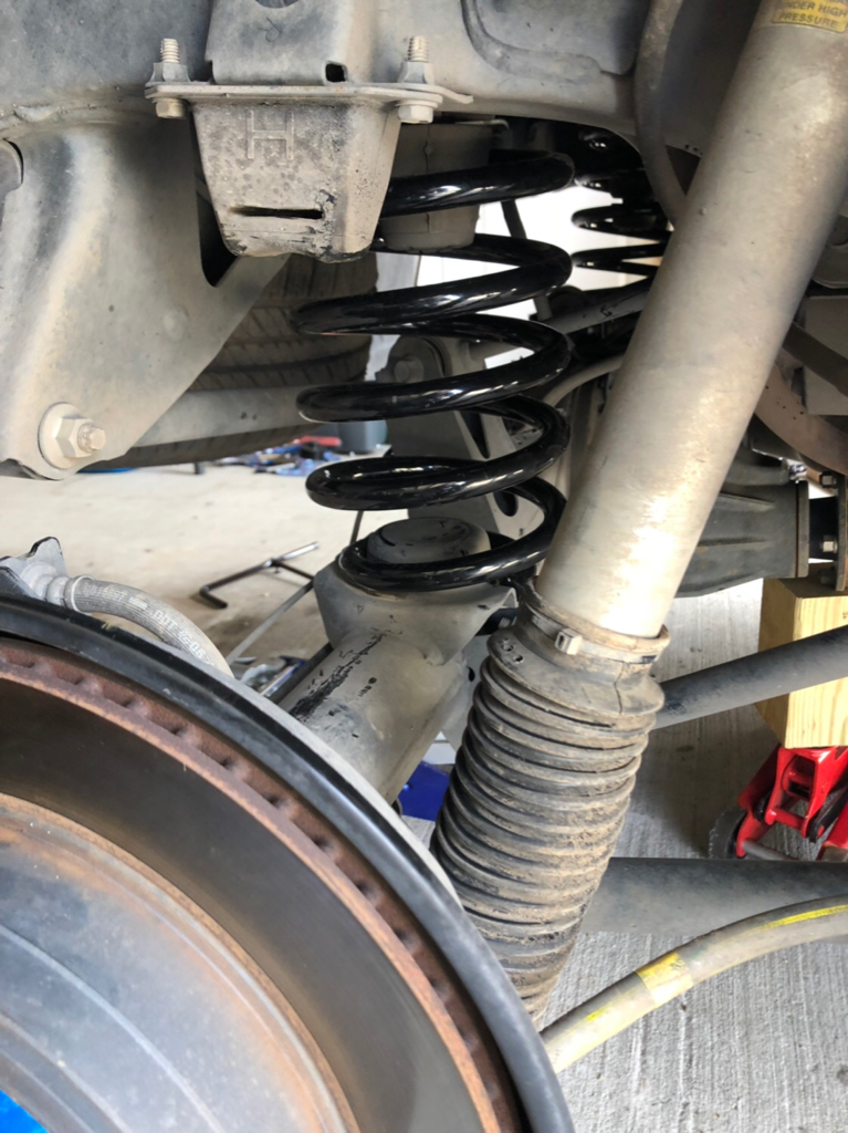

4. Stock bottle jack between rear axle and bump stops make getting the rear spring in and out a breeze.
Driving and ride impressions.
Ride is definitely firmer but I wouldn't call it rough or harsh by any means. Rides very good over bumps but maybe a little bump steer but may be due to the fact I haven't had it aligned yet. Cornering definitely feels better and body roll was reduced. Brake dive is greatly reduced. Other the having to climb up into it more I doubt most normal people would even notice the ride difference. All in all in very happy with it as far as looks and ride. Can't beat it for spending less then $300. I think my only real negative was the drastically reduced down travel, although I knew that would be the case. It'll hold me over until I can budget the full King setup next year.
Getting it aligned Friday and will let the suspension settle in for about a month and update measurements of they change much.
Any questions or anything just let me know.

Nothing was hard it was just a pita doing it alone. If I had an extra person to step on the hub on each side while I slipped the springs in and out it would have been so easy. I used the stock bottle jack between the axle and bump stop on each side to force the rear down and they went right in. Only other hard thing was a pain is that only removed the lower shock mount on the rear to allow it to drop. Took a big pry bar to get them off and some never seize and a dead blow to get them back on, just due to the angle.

Yes the bottle jack worked perfect just not as quick s someone stepping on each side.
Yes I only unbolted the lower shock mounts.
No there was no need to unclip any of the brake lines or wiring.

No I bought them off of a forum member here that decided to go with a higher lift. Same as I did for the 6112s as well. Got like $300 into both sets. Not a bad deal.

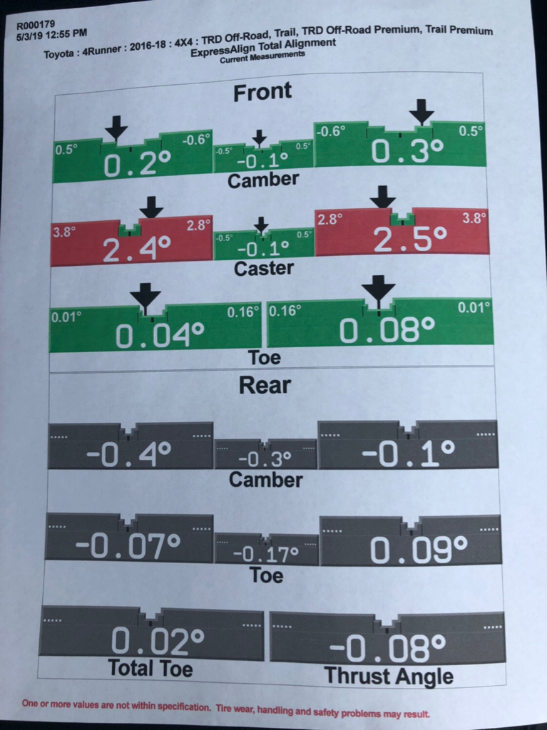

Took mine in today for an alignment and after 1.5 hours they told me this is the best they could do and my factory cams were out of adjustment room. It's not for off so not sure it'll make a huge difference or not on how it drives, or worth the hassle of pursuing it any further. Any opinions?

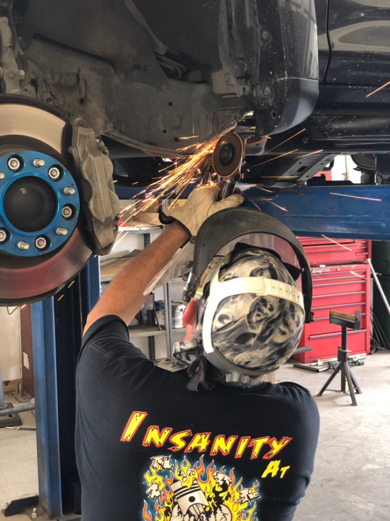

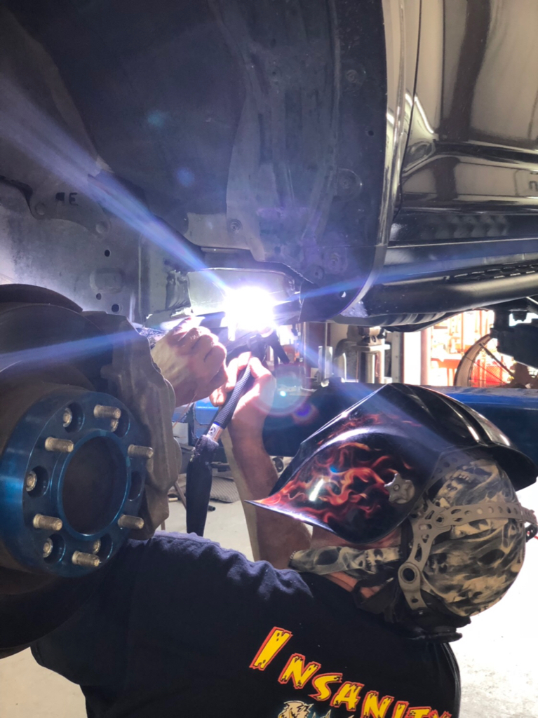

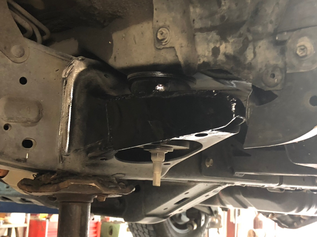

Did my Body Mount Chop today. Not the prettiest welds but it's been about 10 years since I picked up a torch.
You are a brave man...

great work. i may try the approache as well. as for alignment, do you mean camber or caster ? looks like your camber is okay and your caster ran out of adjustment room.
