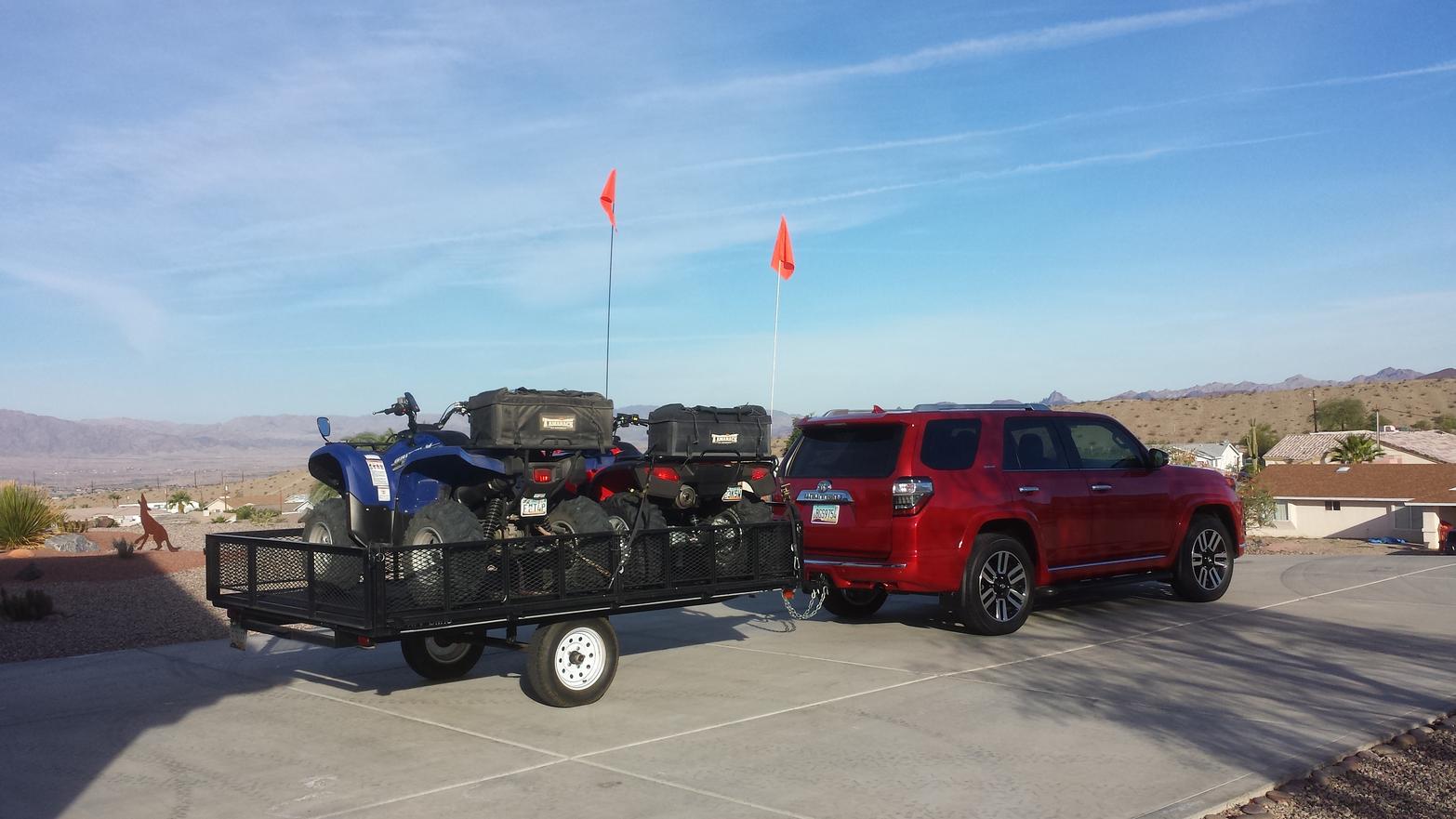

Each atv weighs around 750 lbs. and roughly 500 lbs for the trailer. I generally do not tow long distances. I generally leave it in 4th because there is a lot of hills where I live. If I am on a level section of road above 60 mph or so I may put it in 5th temporarily.
here is a picture of the atvs and trailer. I can not see directly behind me with any of the mirrors. I take the seats off the atvs to be able to use the rearview mirror on the windshield to see directly behind me.

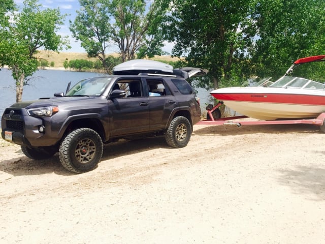

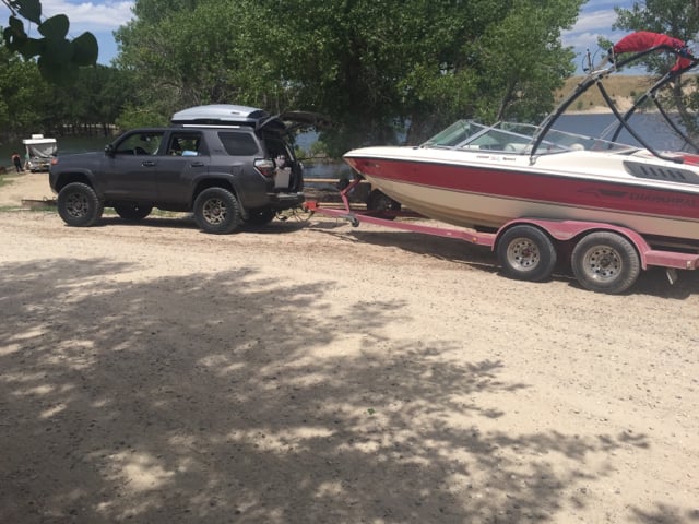

I had a Bayliner Trophy 1802 on a trailer with surge brakes that towed fine for short distances. I did take it from Key West, FL to Yuma, AZ without any issues, but the surge brakes did make for some scary braking situations. Pictured below was the boat loaded and sat at 4800lbs (3500 without cargo). I didn't have aorbags at the time so the rear did squat.

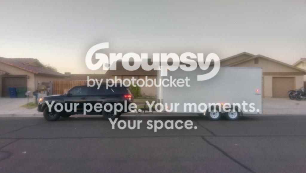

Here is my 16x7' trailer fitted with weight distribution hitch and airbags, and electronic brake controller. Final weight was approx 6100lbs... it towed just fine and the electronic brakes saved my bacon.
