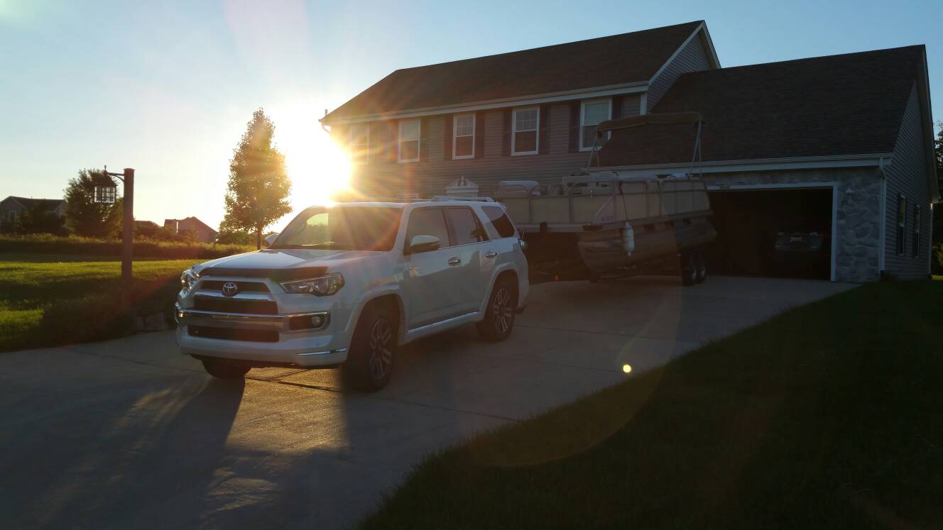

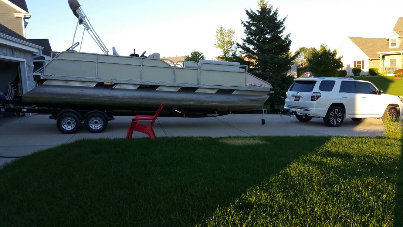

Towed the pontoon today for about 30 miles and went great. The 4runner handled the trailer and boat like a champ. Have a long trip on Monday which will include freeway driving.
Some pictures.
Sent from my SM-N910V using Tapatalk

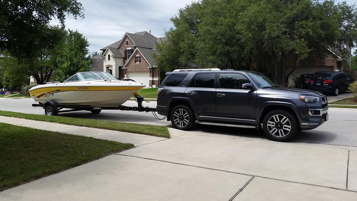

So my setup wet is in the 4,000+ lb range and it does fine. Will downshift a bit around the Austin hills coming and going to the lake but that's about it.
19 foot boat, 4.6 Mercury inboard/outboard, and the trailer has surge brakes and I've tested them once or twice locking them up. (stupid Austin drivers). No trouble stopping.
4Runner has stock suspension, brakes, etc... (for now)

You might want to check the tongue weight on that. Maximum tongue weight is 500 lbs. on your 4Runner with OEM hitch.

I'm not an expert on pontoon boats and their trailers, but are you sure that trailer is adjusted correctly? It looks like the boat may be too far forward on the trailer.
