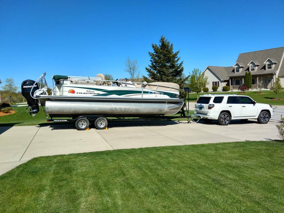

I'm not an expert on pontoon boats and their trailers, but are you sure that trailer is adjusted correctly? It looks like the boat may be too far forward on the trailer.
I need to slide the stop/winch back about 28 inches. The trailer is meant for up to 26ft boats so they have it all the way up from the factory.
While its not dangerous it is putting slightly more weight on the tongue than it has too.
I also need to slide the pontoon float rails apart farther by about 2 inches.

Do pontoon boats have the majority of their weight in the back 30% of the boat?
Basically yes. The motor, gas tanks, and drive control systems are usually right near the rear of the boats. Otherwise they are pretty light weight boats. I'd bet the center of mass is about around 25-35% of length from the rear. But that's also pretty typical for most powerboats in general.
The trailer wheels are pretty far back on that trailer. I figured weight was the reason. Never had a boat that long.
The biggest mistake I see on a regular basis is having the wrong trailer hitch. If your ball is too high on a single axle trailer - it moves the COG back and changes the effective tongue weight making for a potentially unbalanced trailer. On a dual axle trailer, it actually adds tongue weight most of the time because you're now putting more load on the rear axle and moving the effective center of the pair of axles. Typically trailer brakes are on the front axle in a tandem axle setup, so you're now removing weight from the axle with the brakes and increasing the likelihood of lockup and reducing effective brake force. Plus if the trailer tongue is not level it's going to want to lift the rear of your tow vehicle also reducing braking ability. Ideally a slight downward slope of the trailer frame should exist or at least get it level. The correct drop hitch is pretty easy to sort out most times and shouldn't cost an arm and a leg either.
On dual torsion axles, I can see tongue height affecting axle loading, but don't see where it'd do that for dual leaf spring axles (excepting the CG movement).
Also don't see how level trailer affects lifting of the rear of the vehicle except for the CG issue.
To me - that boat also looks too far forward on the trailer. With a universal trailer it probably needs to have the winch location moved back a few feet at least. Pontoon boats tend to be pretty rear-heavy.
My sailboat is a lot different. My axle on that boat centers just slightly rear of the middle of the boat, but the weight distribution on a sailboat is often quite a bit different from that of a power boat.

The equalizer leaf spring setups work - but only within a pretty small range. They usually only have a couple inches of total travel. So a couple inches off at the ball can throw them out of balance.

As far as pushing up or down, if the ball is too high the forward push against a braking vehicle will also have an upward component that will tend to lift the rear. Similarly too low and you'll get the rear pushing down upon braking.
