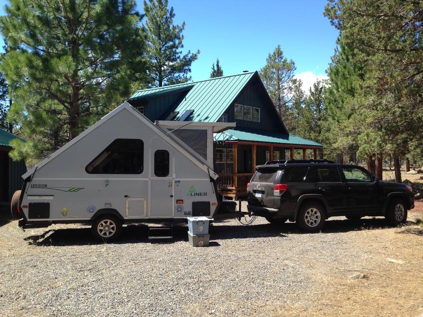

you might consider a hard-walled A frame popup. I just got one of the Aliner 18 ft models and towed from OR to Lake Louise, Alberta in a day - 775 miles with lots of mountain roads. the low profile allows it to tow well in wind and the light weight (dry trailer is <3000 lbs.) is easy on the 4R. had no issues and no add ons like airbags, tranny cooler etc .
That's a nice camper. How are those to set up? Thinking about one as well.

set up takes 1 min, max. another 30 sec for the soft side dormer. this one has a two burner propane stove, sink, cassette toilet, heater, AC and 3-way fridge. sleeps 4.
