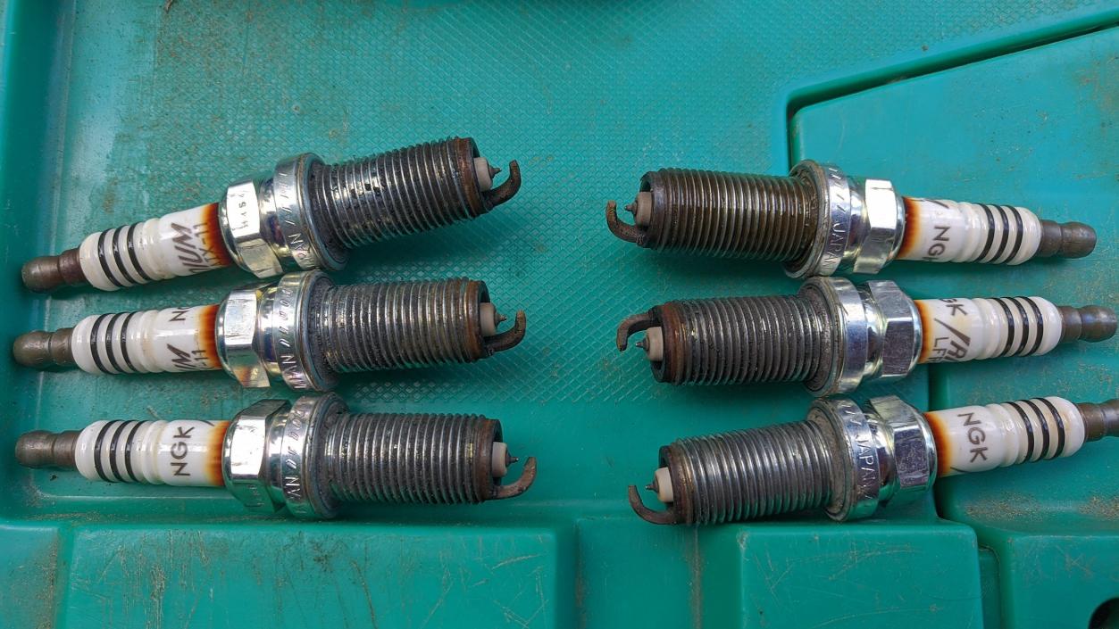

Old thread... but its title has the right words in it. Anyone have their anti-seize "dry out"?
The plugs were VERY hard to extract. It didn't feel like they were going to break off... they just needed good hard pressure the whole way out. The Driver Rear plug was still "wet" and pulled out just fine. Plugs were in "ok" shape... but I could tell the top was starting to pit and the insulator nose was getting dirty. NGK plugs ran them for 60k (yeah over a little... but under from the first owner). V6.

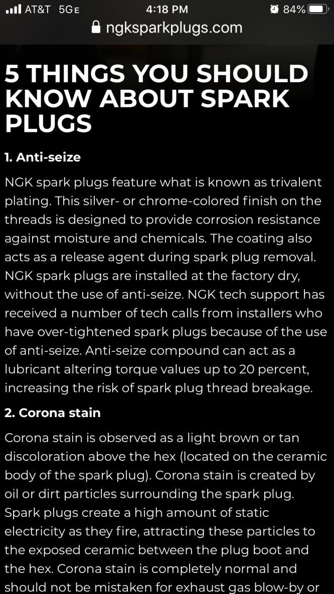

This is from NGK web site.
