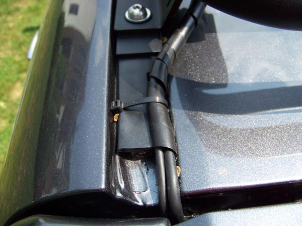

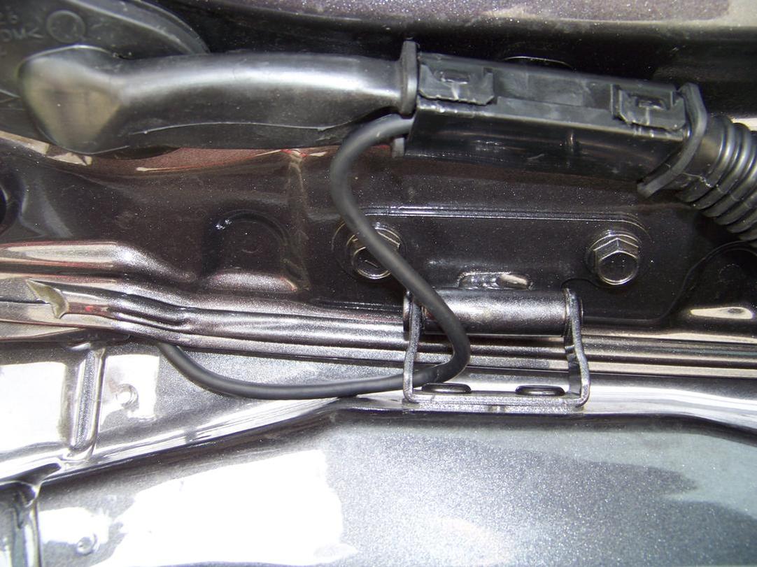

Can you show through pictures (if you have any) how you routed the wiring loom to the switches inside? Kind of curious if you ran them AFT and through the rear lift gate plug or went anouther route. They look great and I'm envious!
Could you post pics of how they are mounted. Duc just sent me the silver blocky things as mine are uneven too. Well, I guess now mine are the only ones uneven. Traitor!
Thanks man! I keep meaning to do a writeup on the Gobi wiring. In a few years I'm gonna take it off for maintenance and redo everything. I'm pretty sure Okki did a good how-to in his thread.
This is all I got:
The wiring comes from the rack into the rain channel and into the truck via the gap between the roof and the rear hatch- here:
The first pic shows just the CB cable, but you get the idea.
After entering that rubber boot the wires travel into the headliner, down to the jack access panel, into the rear wheelwell storage area, down to the sill plates to the fuse box.

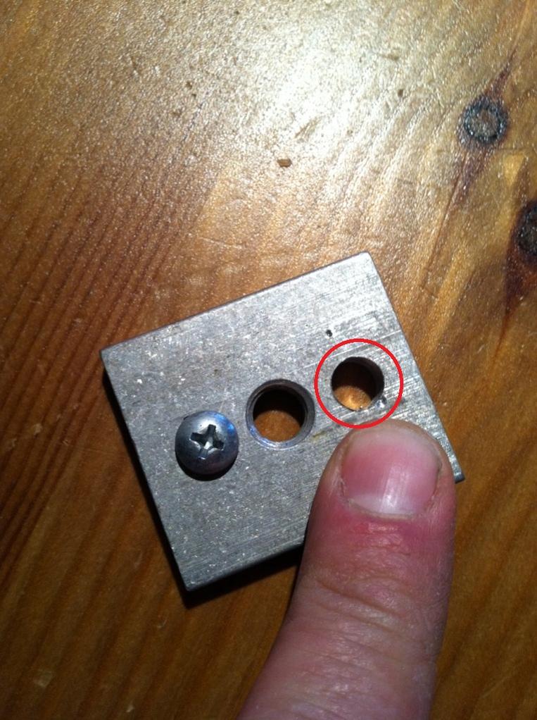

The outside lights are mounted exactly like yours, I'm pretty sure. No aluminum blocks, fairing bracket over the top of the light bracket.
photo-145.jpg~original
photo-148.jpg~original
For the 10" I had to use the aluminum spacers. I drilled out one of the small threaded holes to accept a bolt (5/16").
I used the original brackets that came with the light, not the cradle you used. Bolted the bracket to the aluminum spacer with the screw you see in the picture and a stainless washer. I used blue thread locker too. Then the aluminum spacers get bolted to the rack through the enlarged hole.
photo-146.jpg~original
photo-147.jpg~original
This puts the center light a teeny bit lower than the outside ones, but you can't tell.
