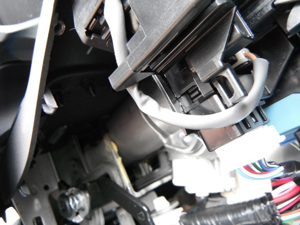

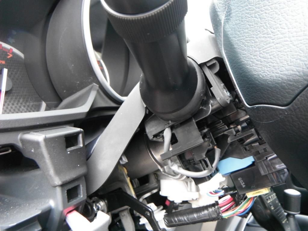

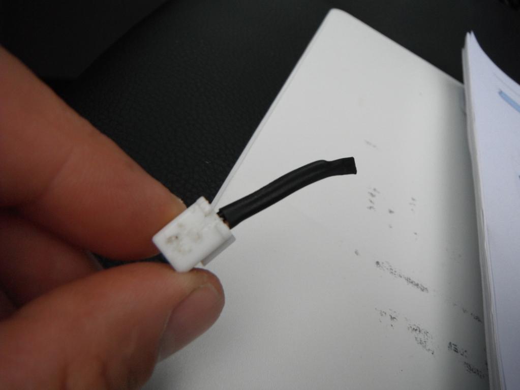

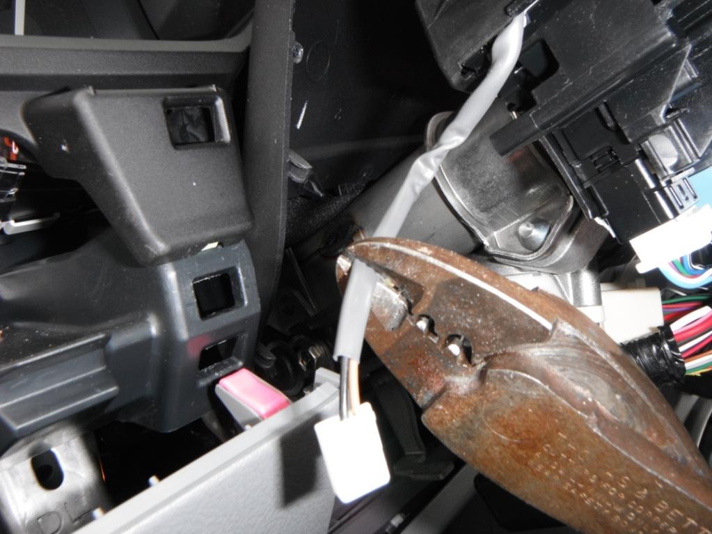

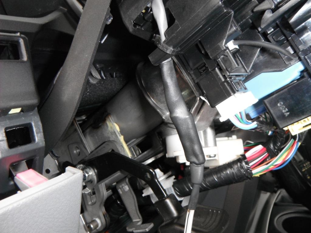

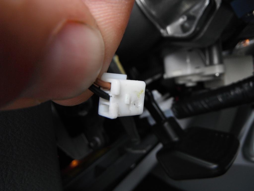

See this wire bundle? These are attached directly to the fog switch. Brown, and black under the shrinkwrap...

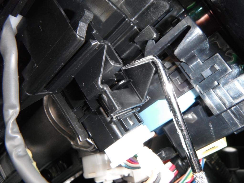

This plug is NOT easy to remove. I used a right angle pick on the top of the plug and pulled it out. Be patient here!

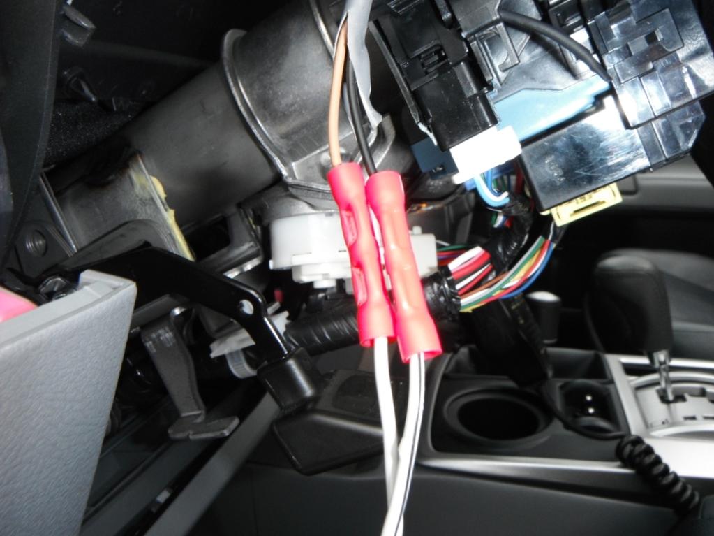

Cut the wires and connect each to a length of wire. I reinstalled the original plug (insulated), and shrinkwrapped the connections
If I may ask a question on this setup. Would it also work to just cut the wire as you did before and terminate it as you did. However this time do it with the plug still attached. Reasoning is based on you description of the process, it's a ***** to remove. This would eliminate that step as it looks like you are simply terminating that plug and redirecting the opposite end to your new destination correct?
Thanks
Thanks
Yes! It's actually mentioned a few posts later. It's one of those "Why did I even bother with that?" moments when I look back on it, lol.
Leave it there- much easier!

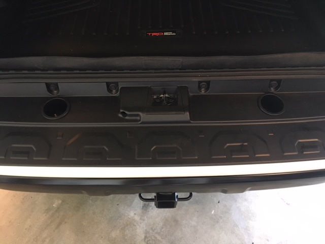

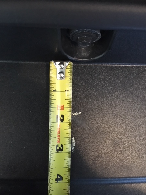

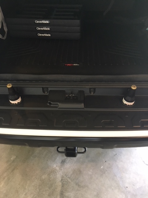

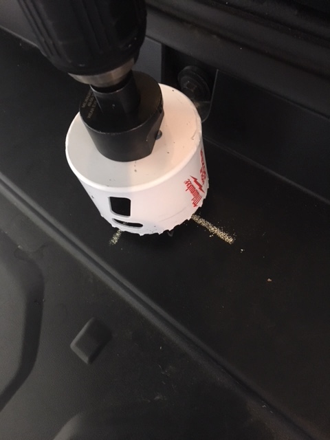

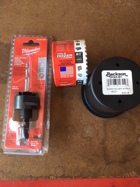

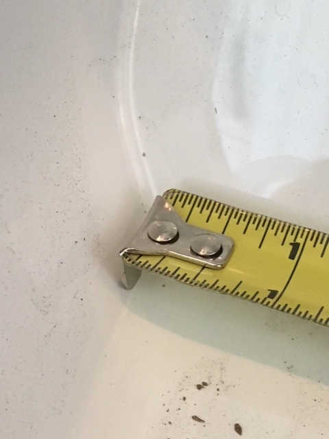

As I was watching the fourth of July parade with my kids baking in the 90 degree heat with no shade I resolved to just tailgate the damn thing next year. Of course this got me thinking about what mods to the 4Runner would make it the most enjoyable. The first thing that popped into my mind was the rear bumper cup holder mod. I knocked it out this morning and am overall happy with it, except for my bone head mistake measuring that resulted in the passenger side cup holder lip touching the vertical rise in the bumper and the driver side cup holder is 1/16 away from the vertical rise. Pissed me off something fierce. I will likely feel better once I drink a beer from the cup holder. Anyway...here are my lessons learned and thoughts on the mod:
1. Even with 2 3/4 hole saw the Dremel is needed to slightly enlarge the holes.
1A. I didn't own a dremel until this morning. I now want to Dremel everything.

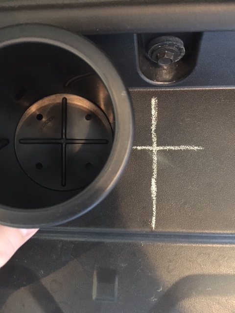

2. Chalk works well for marking up your bumper before cutting.
2A. I grabbed a piece of my daughter's yellow sidewalk chalk and it worked great.
3. There are vertical and horizontal lines / cross hairs on the inside of the cup holders from West Marine -- these are helpful when mocking up the cut ahead of time (draw the lines, then place the cup over the lines to get accurate view of placement).
4. Either measure & mark both holes before cutting the first to ensure they are symmetrically placed OR once the first hole is cut, validate your second measure against the cut on the first. My cup holders are 1/16" off in the distance from the front and it's noticeable due to where the cup holder lip sits. I love the mod, but this will drive me crazy for all eternity.
5. If you have all of the tools and the cup holders in hand this should take you no more than 30 minutes.
6. There is some wiggle room for error from Antman's original measurements. Thank God.
7. The measurements Antman provided in 2011 still work on a 2018 TRDORP
8. This is super easy mod that just takes a bit of courage as you're placing a hole saw against the body of your baby.
9. Re-read #4 above again.
