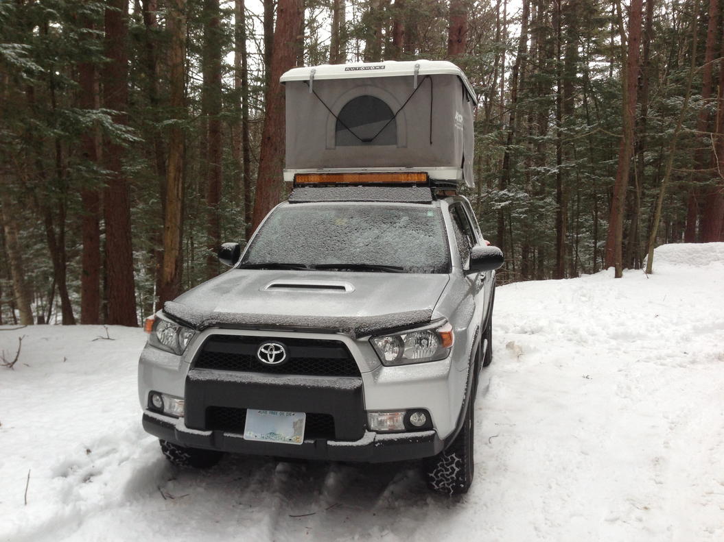

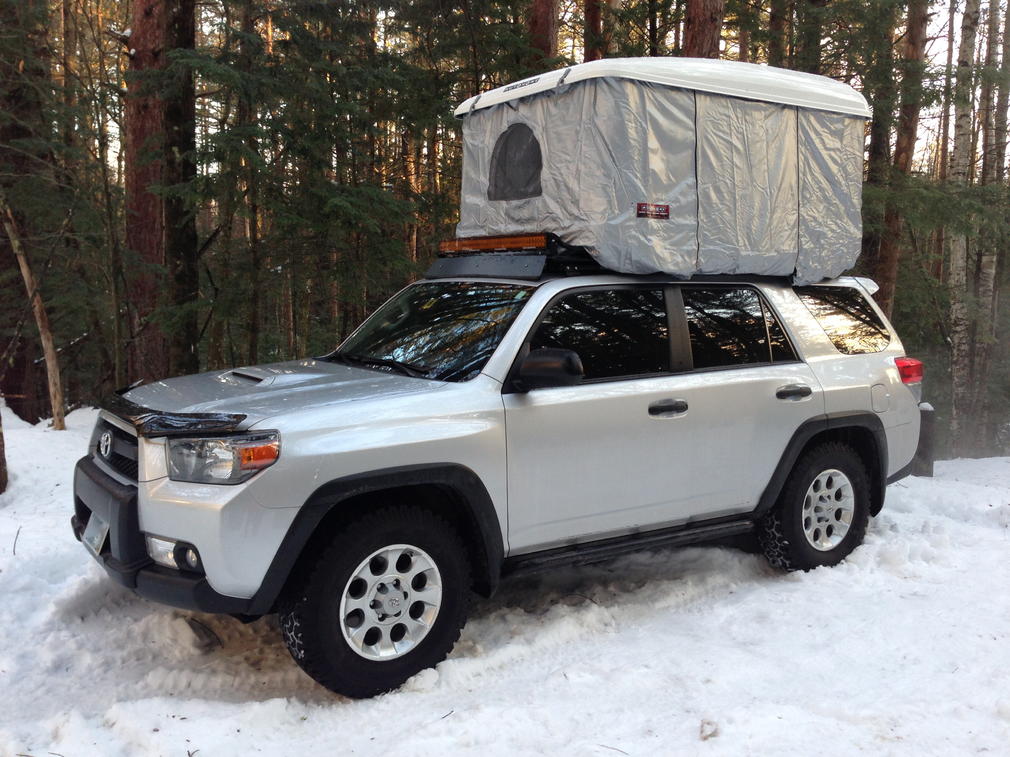

Is that an autohome? Extreme? How do you like it?
Autohome "Air Top". :) The concern I have is snow accumulation at night while sleeping. The 4 struts that erect the top I don't think would hold up to much snow loading.Also high winds would be an issue with the winter hood do to its Velcro attachment points. Other than that It is comfortable and roomy inside. I'm 6' 1" and have plenty of room.

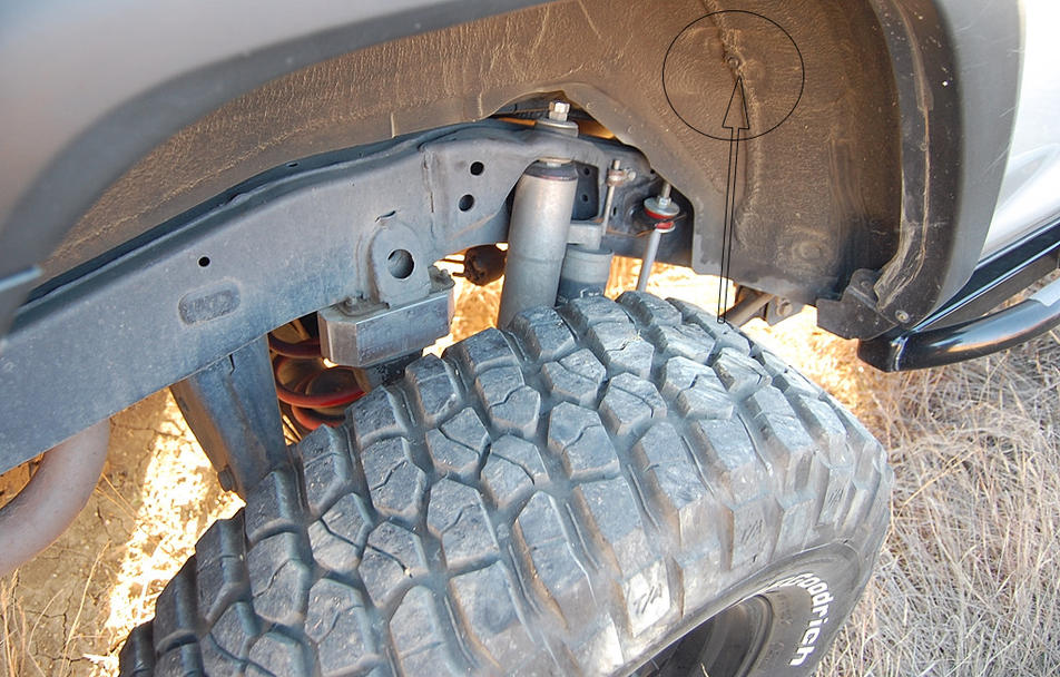

An interesting observation that might not be to you however Im going to share it. That is with an oversized tire like the one you have currently installed, are you seeing any rubbing on the tire itself? The tread in other words, has it began to wear off the rubber lining within the fender well?
The other thing I have observed is the rear seatbelt bolt. Now that my 285/70/17 tires have hit it on a few occasions the rubber lining stuff that was sprayed around it has come off making my tire potentiality prone to damage and the bolt to rust. Thoughts?
See your image for further clarification:
