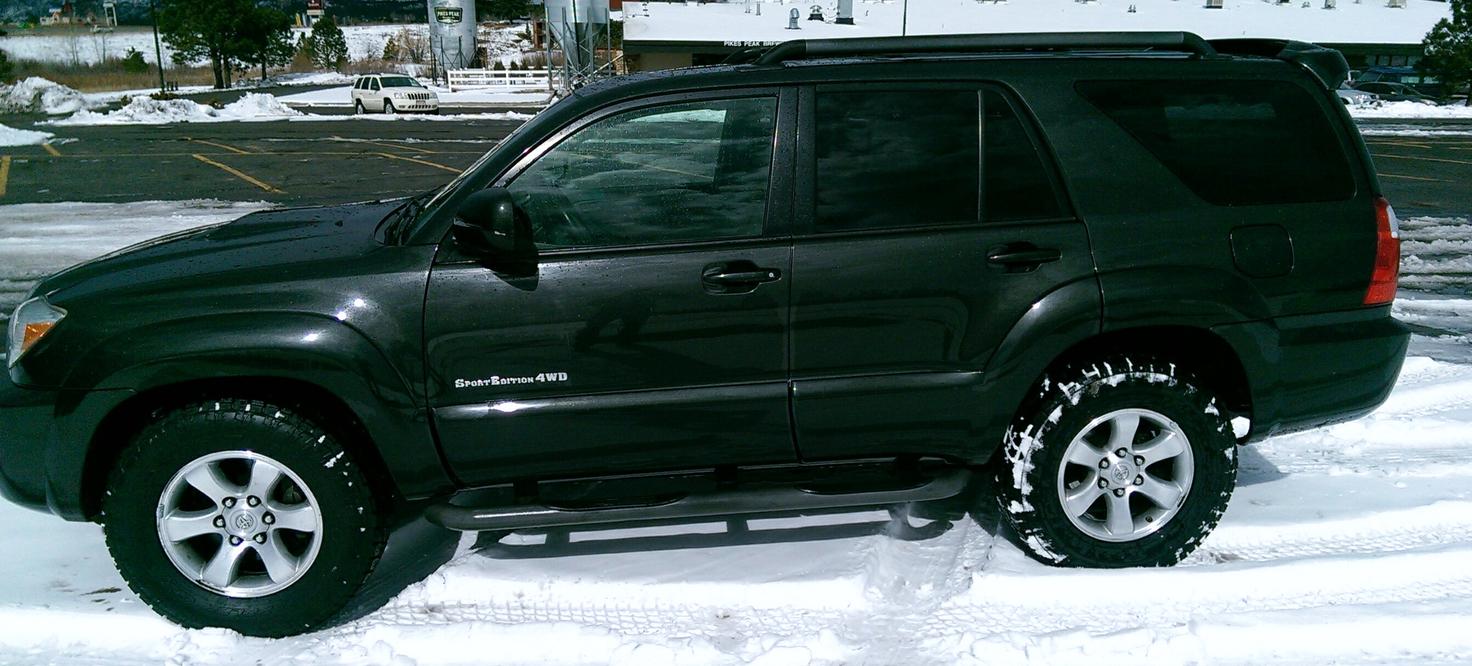

I went to 265/70/17 Nitto Terra Grappler G2's on my 2006 w/o lift and have had no problems. I also removed the mud flaps.
