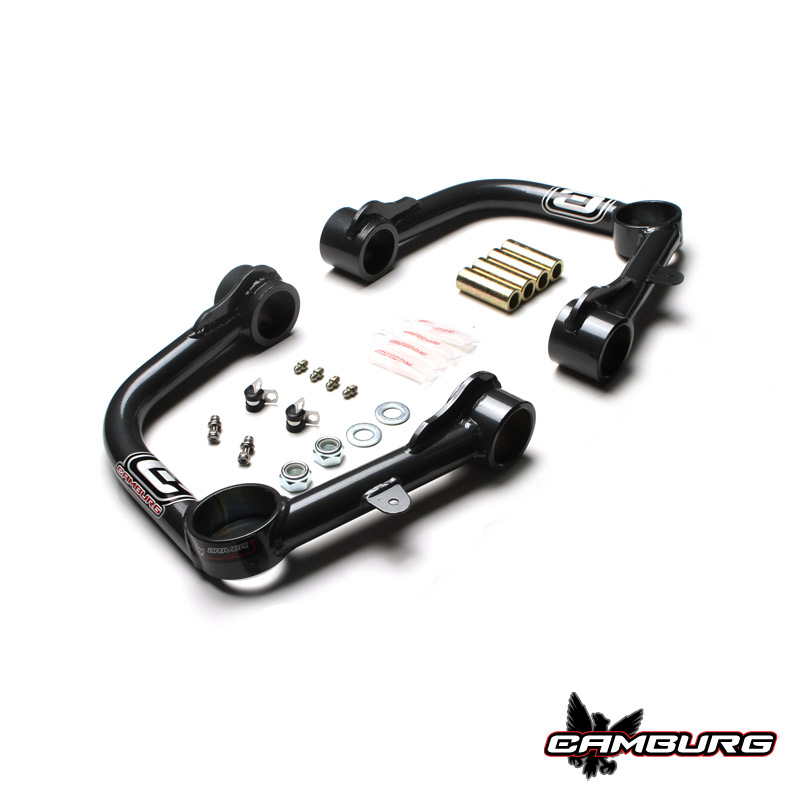

Went to Dale's Alignment in Huntington Beach. Very pro place and Dale knows his stuff. He said he sees this problem all the time. He put it on the rack and told me (among other things) that the caster has been put to it's max adjustment. I ordered the Camburg upper control arm which will give me room to adjust to 4 degrees. The are backordered and the manufacturer said they are flying off the shelves.
I got a call from wheelers offroad that they are back in stock there.
Camburg UCA - 310040 "Ball-Joint" Upper Control Arm Set with Moog Ball Joints Pre-installed
