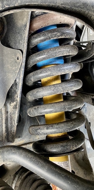

I have the Bilstein 5100s on mine Mike. I came from XREAS tho. 193k on mine and definitely had front end sag on original equipment. I would really recommend the Bilsteins over KYB. IMO the quickstruts (I assume that's what you mean by "replace it all") are of really low quality, I used them on a fleet escalade and town car with equally poor results)... Anyhoo. My vote is Bilstein. If you don't want lift just get the 4600 series. If you have significant sag, you'll need springs, and that's where you'll have to decide how far you want to pull the string. New springs will cost more than a small spacer to offset. But they will likely ride better than worn springs that are now sagging. You know your sh*t so I have no doubt you'll be riding in style again soon. Cheers

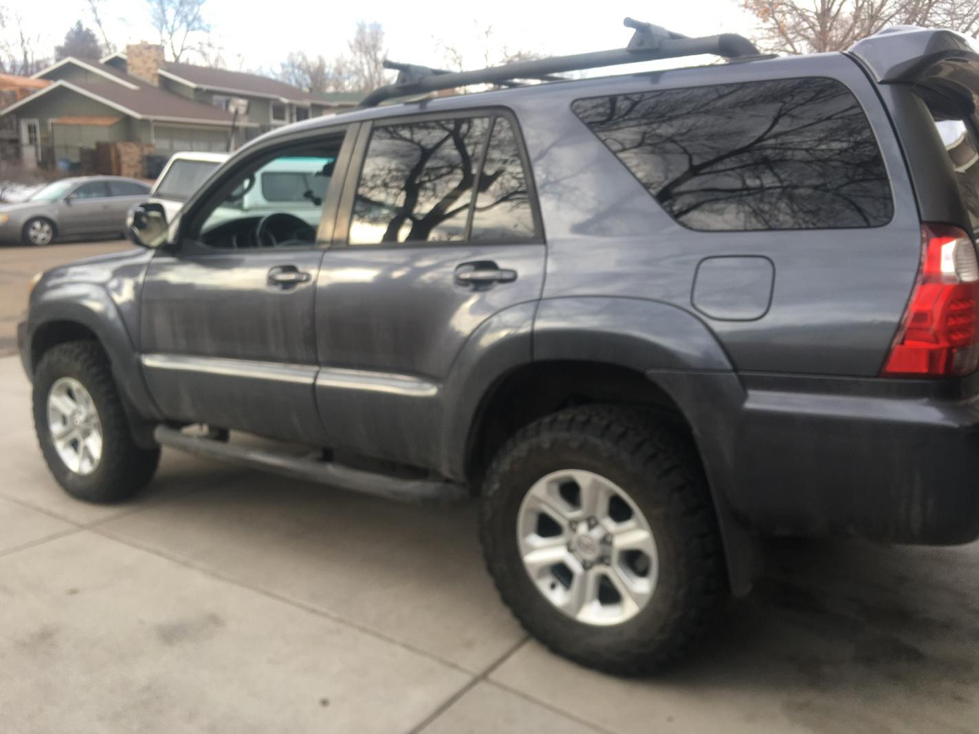

I found some Tacoma TRD Pro suspension parts on Craigslist for REALLY cheap. Provided a small lift and rides awesome.

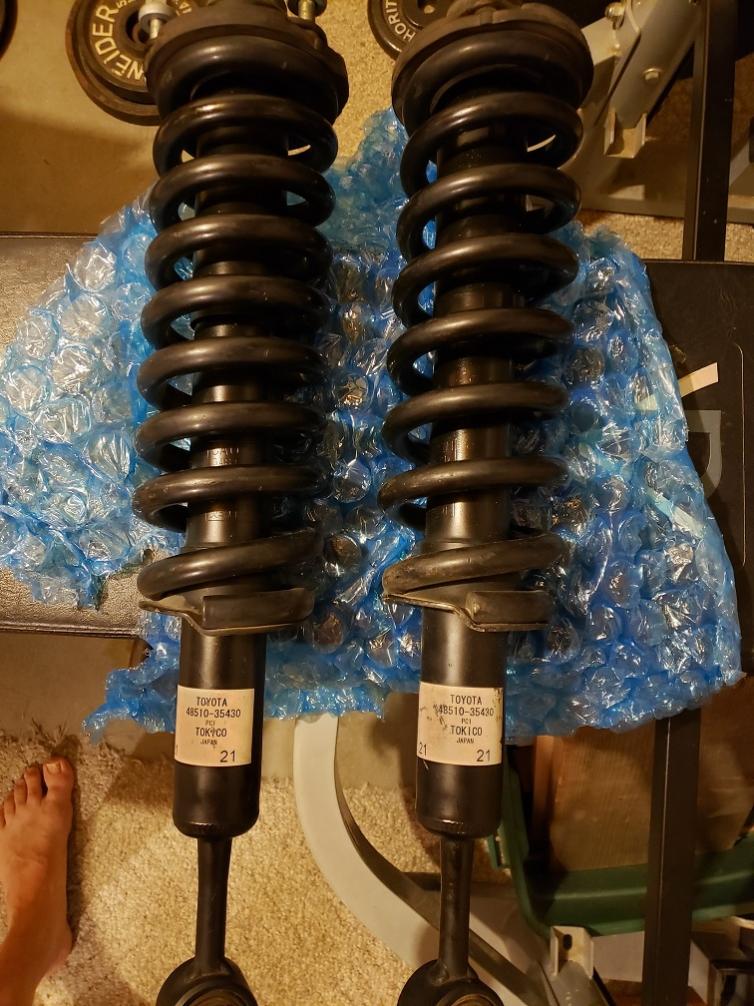

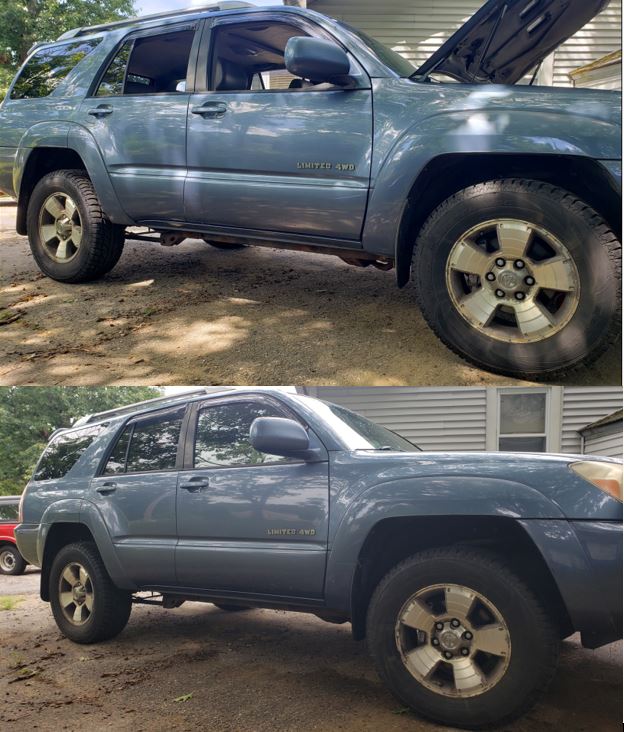

To close this out, I got some almost new struts off E-bay for $120 shipped. They said less than 1500miles from a 2020 4runner and they look like it. Gained a couple inches and wow does it ride better.
