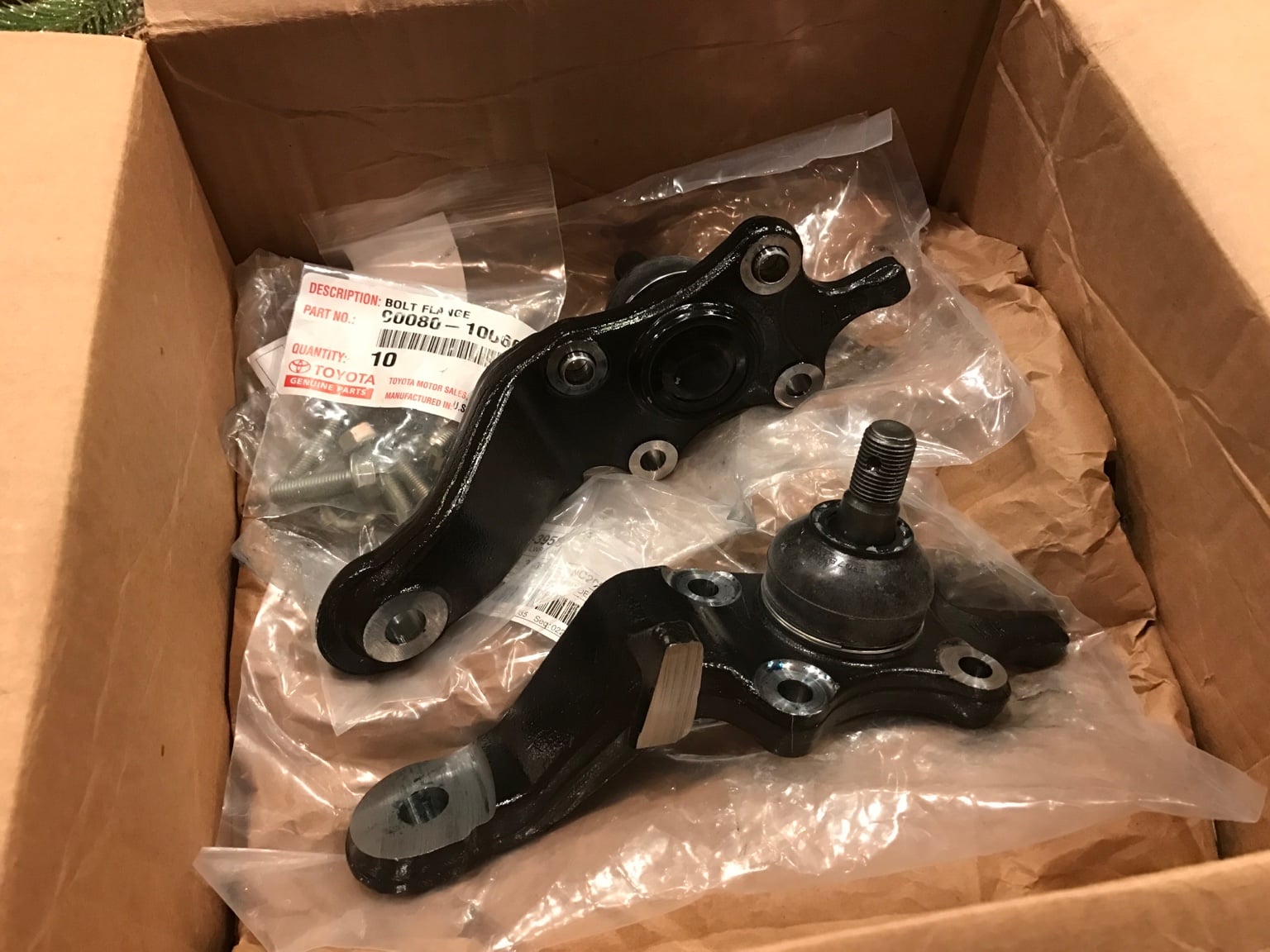

After so many LBJ failures being posted recently, I've been just anticipating one of my unknown-mileage-probably-248k mile units failing on the interstate.
I'm constantly going through the roll-over scenarios- in my head- when I'm driving.
I finally got new LBJ's and bolts today from OEMPartSource.com.
They're clearly 10x higher quality than the ProForged units I bought and returned.

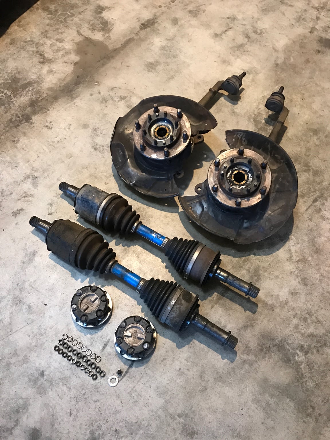

I'll be installing them with my Tacoma free-spin swap, as well as new LCA bushings and wheel bearings.
Maybe the OEM porn will help someone else replace their joints, and go with OEM [emoji1360]

This is some good inspiration. I'm ordering parts now for doing upper and lower ball joints as well as inner and outer tie rods.
A question for anyone: beyond the UBJ snap ring, wire, dust cap, and LBJ flanged bolts suggested http://www.toyota-4runner.org/3rd-g...nner-tie-rods-ball-joints-wheel-bearings.html , what else should I be looking at down while I have the front end apart?

OEM uppers, lowers, bolts, tie rod ends done just now with my frame swap at 170k. Drives so much tighter on the highway. Nothing looked dangerous, but SOMETHING must have had play I could not feel with my hands. No fear here.
