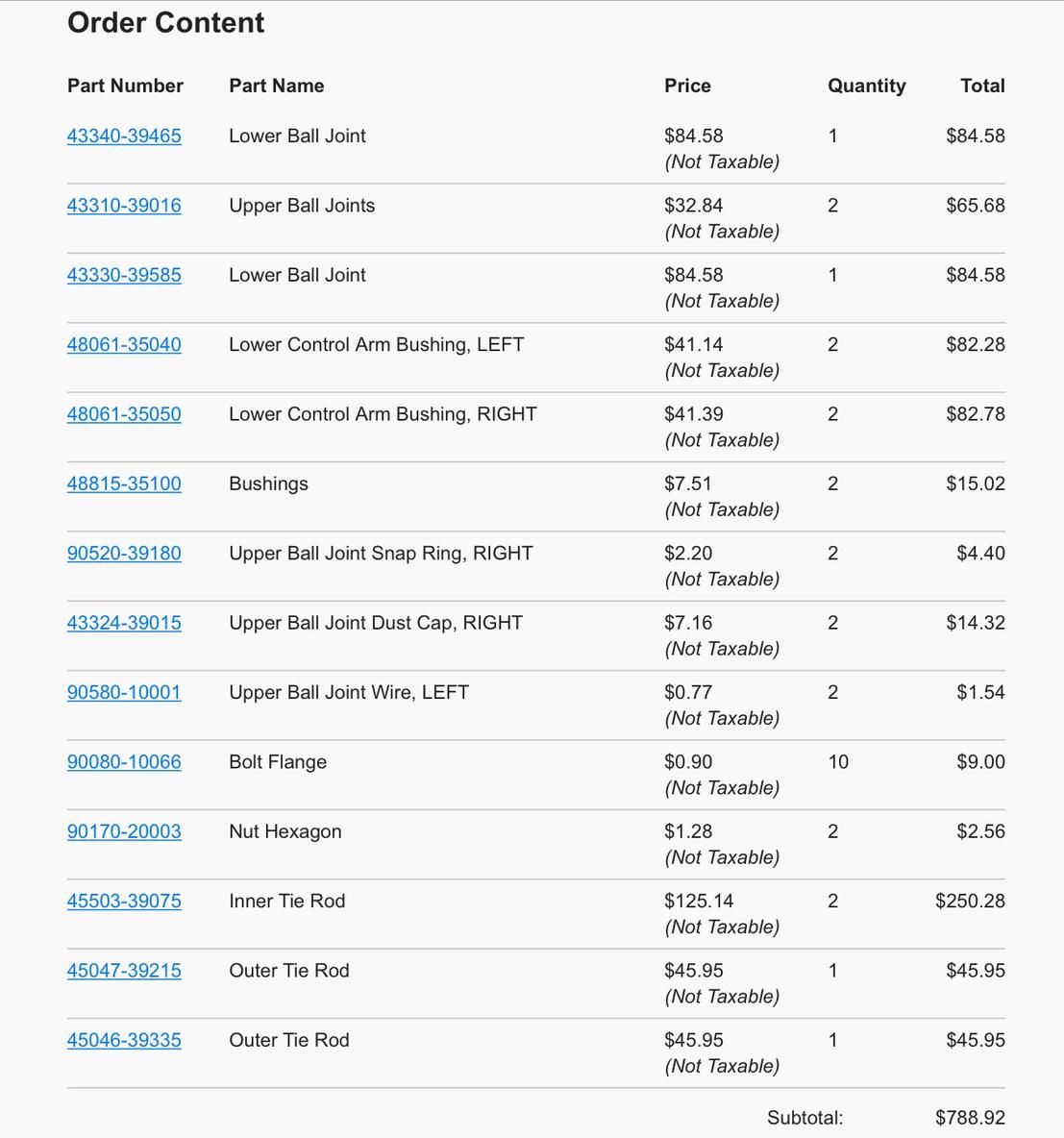

Okay, I went for the proverbial whole nine yards here... did I miss anything?
Actually, I think you went too far. The wire, dust cap, and snap ring are all included with the OEM UBJ. I just did mine.
[MENTION=85040]99problems[/MENTION], you'll need the 8 bolts for the LBJ's to mounts them. (they come with the castle nuts)
(unless that's the bolt flange you ordered)
Yeah the "bolt flanges" I ordered are (supposedly) the correct bolts. I ordered 10 juuuust in case.
[MENTION=10169]TheDurk[/MENTION] "Actually, I think you went too far. The wire, dust cap, and snap ring are all included with the OEM UBJ. I just did mine."
Good to know; thanks for saving me some $.
[MENTION=146628]Mark_BC[/MENTION] "Aww, snap"
Thanks for double checking the list! I really appreciate all the help.
