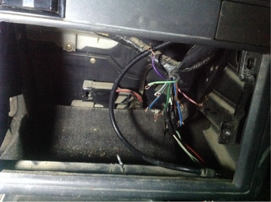

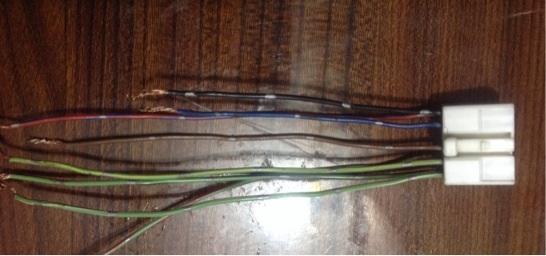

4runner 1989 stereo harness problem
Hello , Before 2 days i cut stereo harness wire and bought a new one , and now i dont know how to put it , there are 8 wires , i wire it random but the hor turn on when i press 4 signals button
Plz help me how to fix that
Need more info...not real sure what u r saying.
You cut the harness out? Can you provide some pics?
Not really sure what you're trying to say. But it looks like you took a knife and cut the wires in random spots. Put the harness back in by connecting the matching wires, and then buy a harness to do to job correctly. Also, it seems that this is not out of a 3rd Gen 4Runner.
His is an 89 but I agree 100% with your recommendation.
x2 Reconnect the harness you cut, buy the correct harness for your radio/vehicle. If you don't know which harness to purchase you can call Crutchfield.
