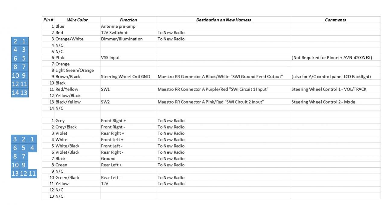

Urban Runner Wire Table
Hopefully this works, attached is my wire connector documentation for the Urban Runner.
