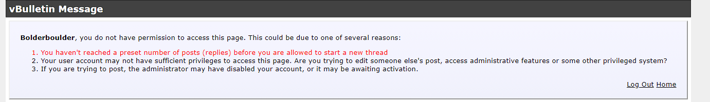

** First Off, My Apologies For This Question **
I'm sorry for posting this question here, but I do not know where else to post it, and my numerous messages to Mods have gone unanswered.
I want to post a new thread for assistance and also a thread to show how to finish a repair on my '05 SR5 this week, but I cannot post a new thread because I get the message in the attachment. As I said, I have sent messages to several of the Mods with no reply.
This forum would be much more helpful if I could Post. Any assistance is apprecaited.
As the message says, you must have a minimum number of posts (15 IIRC) to start a thread. I assume this is an anti-spam measure.
