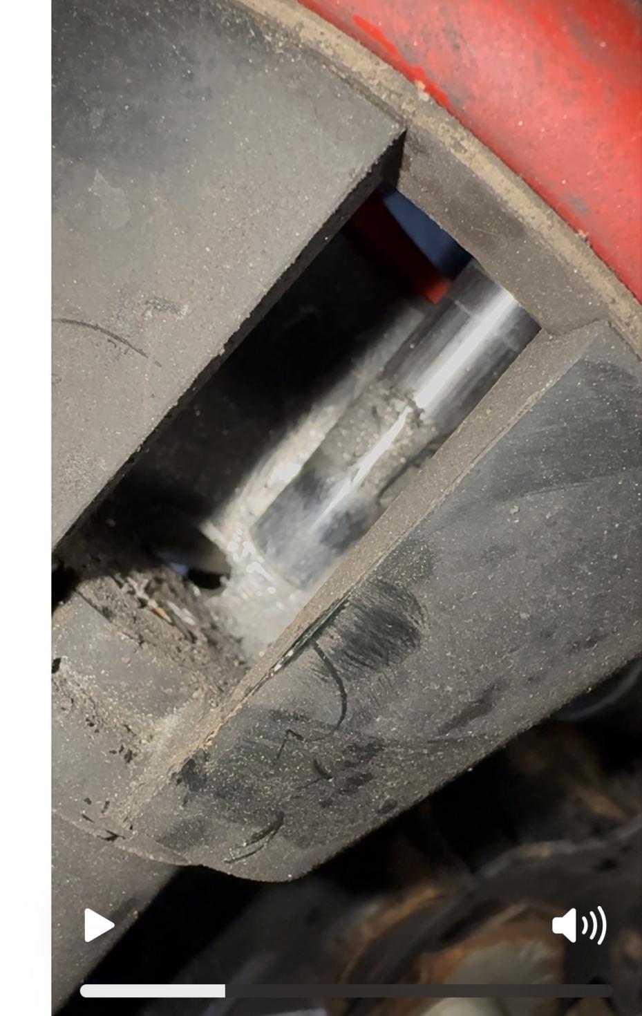

Toytec Boss Aluma Coilover FAILURE
buyer beware on these Aluma Coilovers. Had these for 3 years with almost no off roading besides some fire roads and started getting a lot of bad squeaking for few months followed by clunking. I took a closer look and looks like the shaft sheared off and shock is bending (Which was causing the rubbing/squeaking). Not good. I have a call into Toytec to see what they say..
