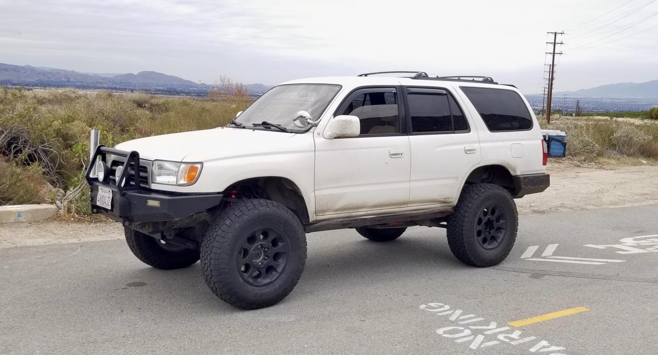

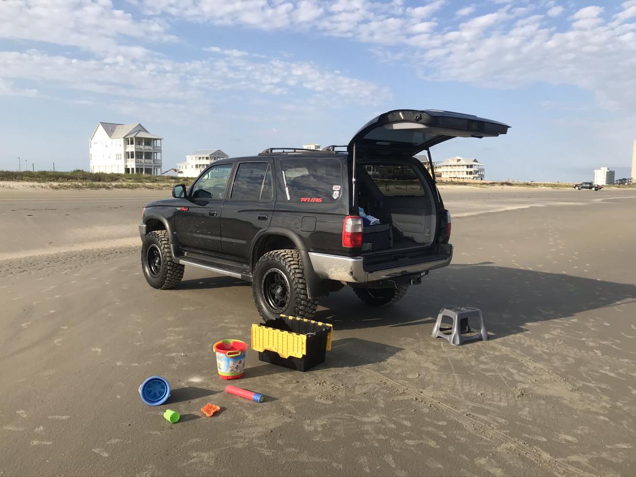

I have them and really like how they handle compared to the stock oem. I haven't put much abuse on them though, as my driving is predominantly highway driving. The little bit of off-roading I've done has been good.

Thank you! Is the side pic of your truck in your signature with these coils installed?

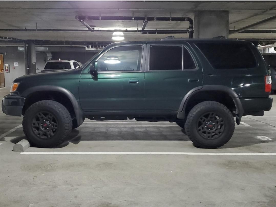

Yes, I have the 3" kit installed (front and rear), but no body lift.

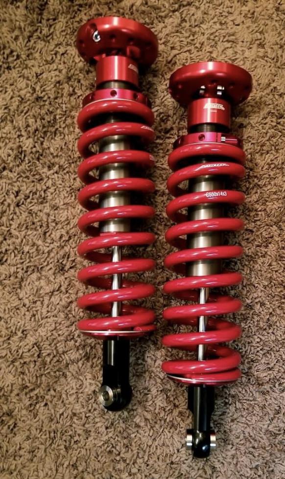

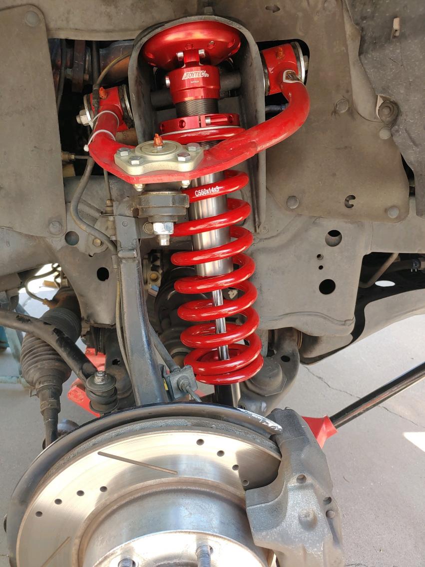

It’s on now! Well, not today because I am still working. But soon!...

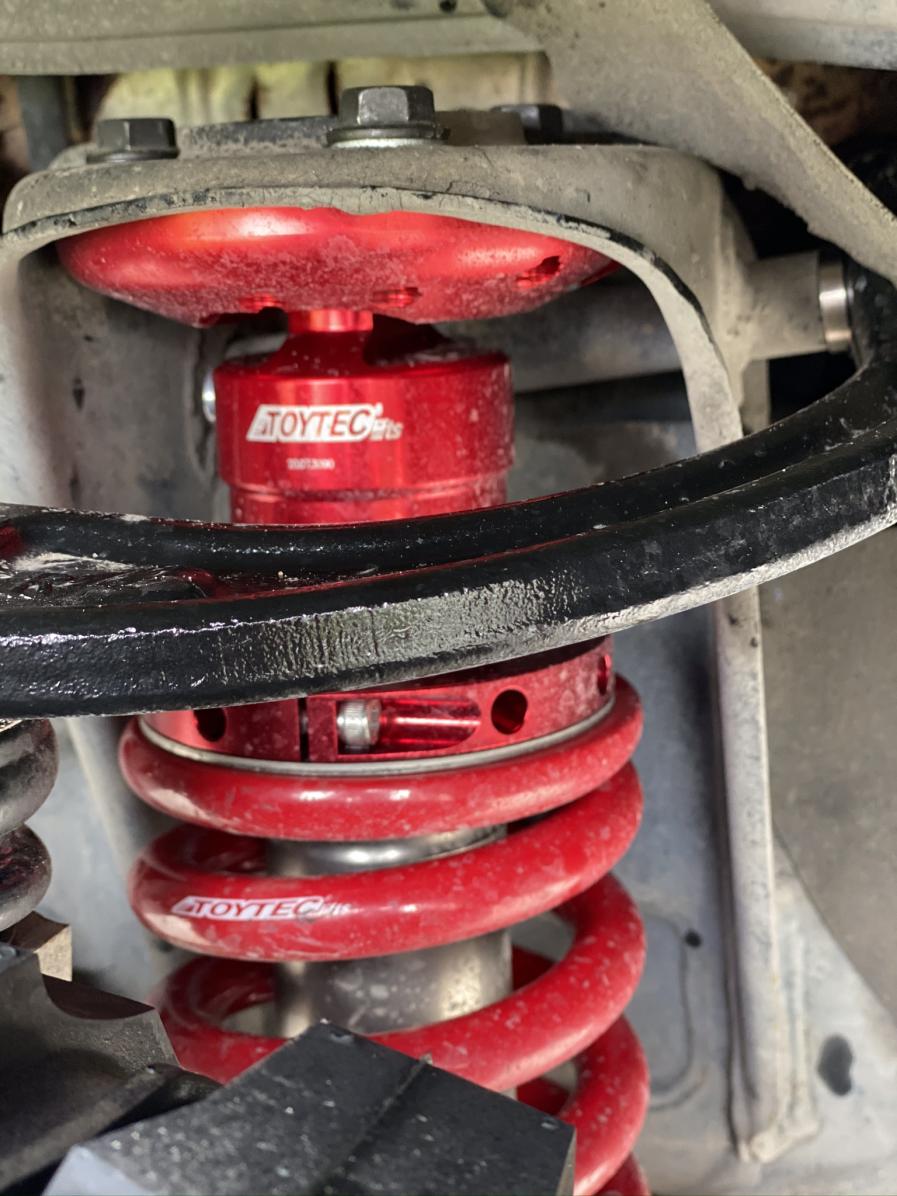

Checking back in. I put them on the truck a few weeks ago and I LOVE these coilovers! They are soooo great for the price. They’re great for any price, really. I love the 550# spring rate too... perfectly soft and flexy, but handle great on road too. I confirmed after the fact they’re made by Elka for Toytec, which is great also. If you’re on the fence about getting some new coilovers and want an amazing ride on and off road, while staying staying under a grand, I’m convinced there is absolutely no better choice than these new Alumas. Do it.

I’ve had OME 861s in the back for about 10 years and they are the perfect spring for me as far as lift, weight support and flex. They are also nice and broken in. I have a good amount of weight back there between the bumper, tire, drawer system, tools, gear, hi-lift, etc..., so these 861s kill. As far as shocks, I’ve also been running stock OEM Tokico Landcruiser shocks back there for about 10 years and they are inexpensive and they feel great. So basically, I feel like my back suspension is dialed in, so if it ain’t broke, don’t fix it.
On the other hand, I was running 883s and OME shocks up front for 10 years also, and these Alumas are 1000xs nicer in every way. The OME stiff up front was harsh, jarring and just sucked on my truck... especially now that I have felt the difference!

You bet! The difference in ride quality between your OME front set up and the Alumas will be night and day! And as far as lift, they put me almost exactly where my 883s were (they sit 1/8” higher, measured from top of tire to bottom of fender), so I didn’t even bother realigning the truck.

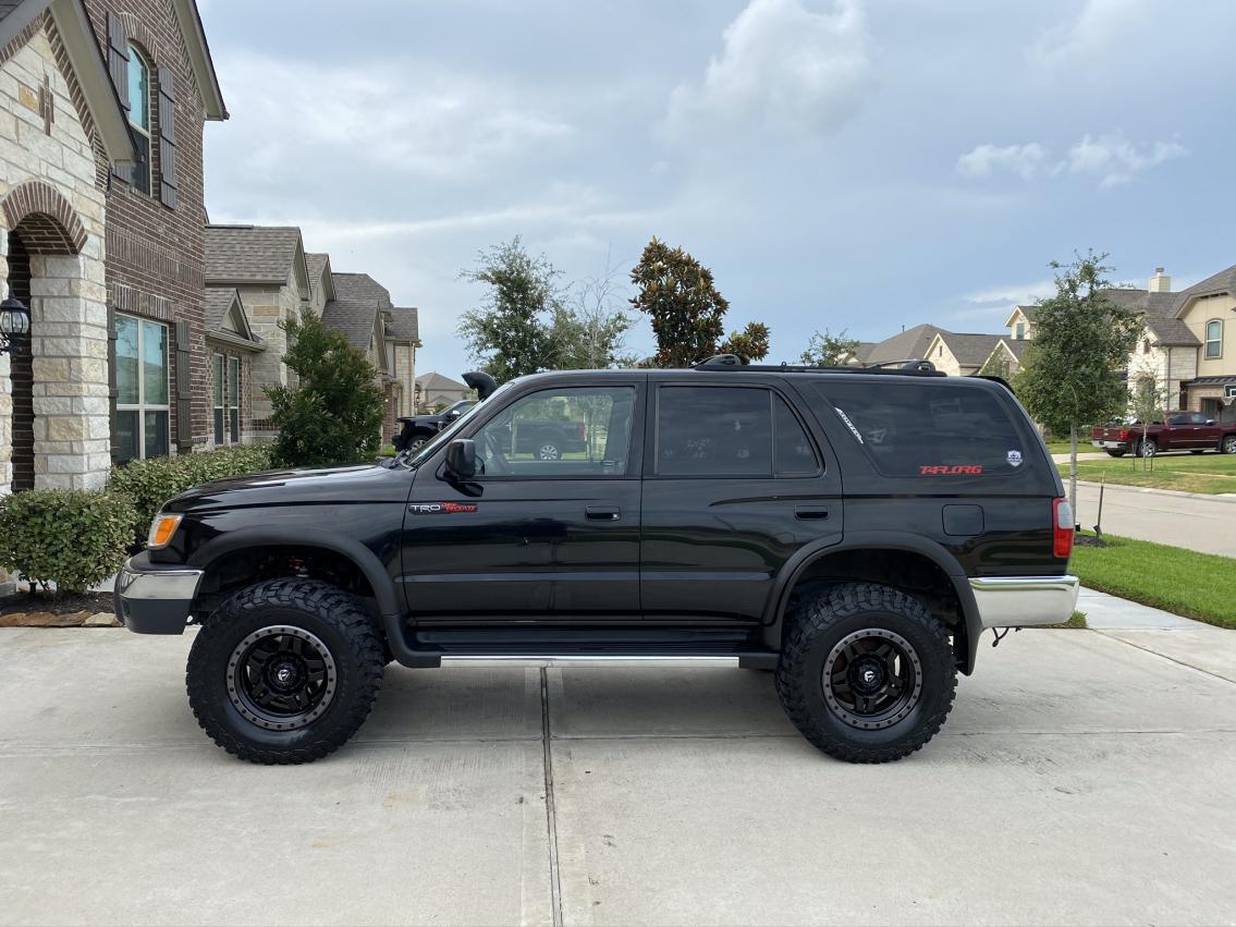

I've been running this setup for several months and really enjoying the ride.
There was a few weeks where I thought the ride was too firm - but then I replaced the hard plastic polyurethane Rear endlink bushings with rubber ones and it made a huge difference to the ride comfort.
*Also, I'm running MStud's endlinks in the front and 2nd Gen Rears on the rear.

What's the rake like after it settled? Did you max out the front coilovers to 3 inches? I recently put mstuds link all around but I believe the bracket bushings are polyurethane ones from energy suspension.
That's awesome that you are the original owner of your 4runner man.

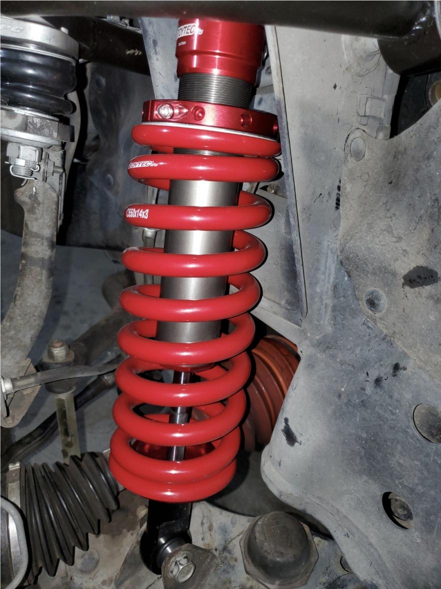

I wanted to be slightly higher in the rear so the fronts are not maxed out (see attached)
I've been meaning to take measurements I'll try to get some tomorrow.
I'm still running polyurethane up front - but changing the rear endlink bushings to rubber was a huge improvement in comfort.
And thanks - when the color matched bumpers became a thing - I pulled the trigger.
