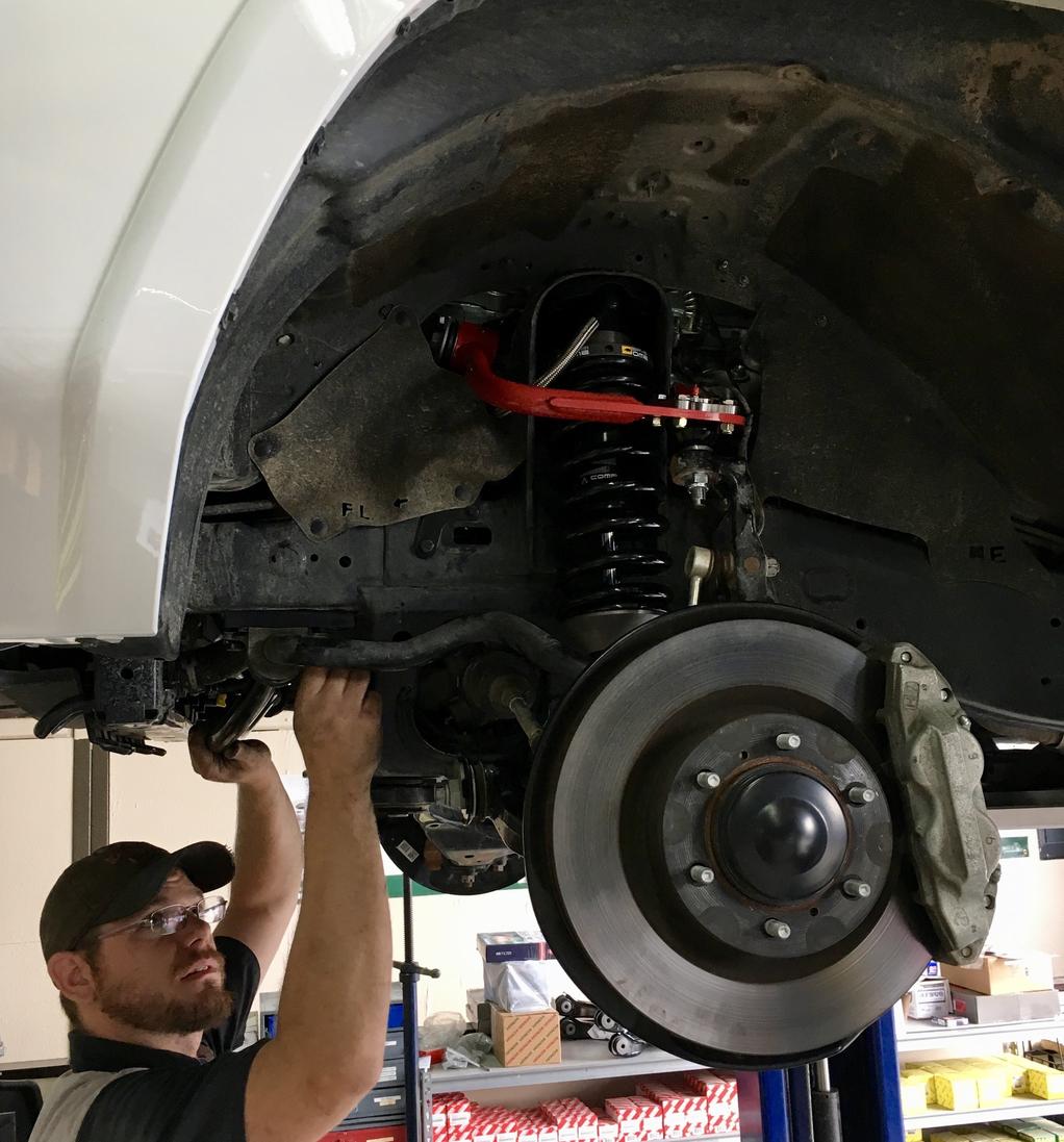

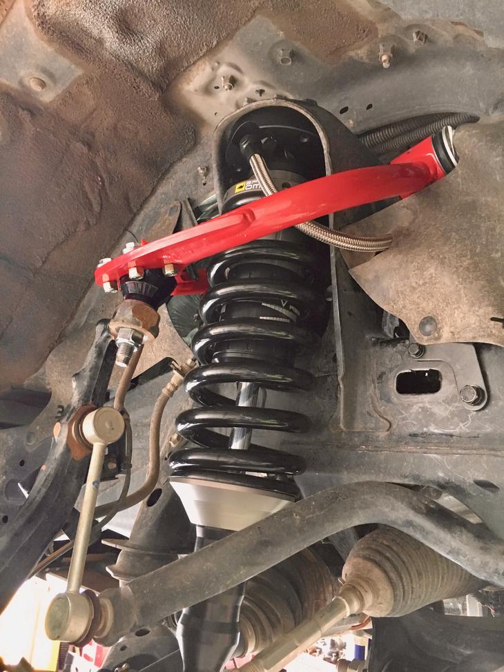

I had my OME BP-51 suspension installed along with new JBA UCA's on my 2016 Trail Premium T4R. The install, with breaks and the follow-up alignment, took about 8 hours. It was straight forward, though the instructions (still only FJ/Prada) were a little confusing at times for the brackets. The included sway bar and radiator relocations kits all fit with no issues. The kit did not come with a spanner wrench so I could not adjust the coil over preload and left it at 20mm. In the end, it worked out fine as the lift ended up about 3.75 in the rear and 3.25 in the front. You cannot visually see the rake, and the T4R looks level, so I was happy with the results. As for the Compression and Rebound settings, after talking with David at ToyTec, I set the front C at 2 and R at 5 and the rear was C at 2 and R at 4 as I used the OME 889 medium springs. His recommendation for a rig with mild weight (sliders and skids) was C at 1-4 and R at 4-8. I went on the lighter side, and the ride is good for a lifted vehicle. The ride is firm but not harsh. Gone is the body sway on turns and the hood bob when breaking. Bumps are felt but not as harsh on rough roads as pre-lift and handling is tighter and improved at highway speeds (75 mph as it is Colorado). The JBA UCA's work great with this lift and the alignment came in great after a few readjustments after the installation. (See the pictures) Respond if you have any questions and I will see if I can give you the answers.

Been running the JBA UCA’s for 3 weeks now. Mine have the newer style bushings and man are those a PITA trying to get on with those washers. In fact I couldn’t get one of the inner mounted washers on. Try as we might we couldn’t do it but we did get the other side on. We ended up mounting it without it on the one side. But now the sleeve is backing out of the bushing as you can see in the pic. It’s obviously not right. Made me start to wonder if my passenger side arm is out of spec. I’m seriously considering replacing these bushings and just going with the OEM Toyota ones. Do you think I’ll be OK to reuse the ones out of my stock arms? Or should I replace with new ones? Any feedback would be appreciated.
Those washers were definitely a PITA. What I ended up doing was using a breaker or pipe to pry the rear of the UCA just so I could start wedging the washer in. Then, I tapped it into place. Wiggle it to get the through bolt in and they were in. I have only put these last night, so I couldn't tell you how they perform. From the test drive though town and local speed bumps, everything feels fine.
I think you'd be very lucky if you were able to get the bushings out of the stock UCAs without damaging them. As the last poster mentioned, you'll have to use someting for leverage to pry enough room to insert the second washer. I just happened to use the handle of the ratchet.

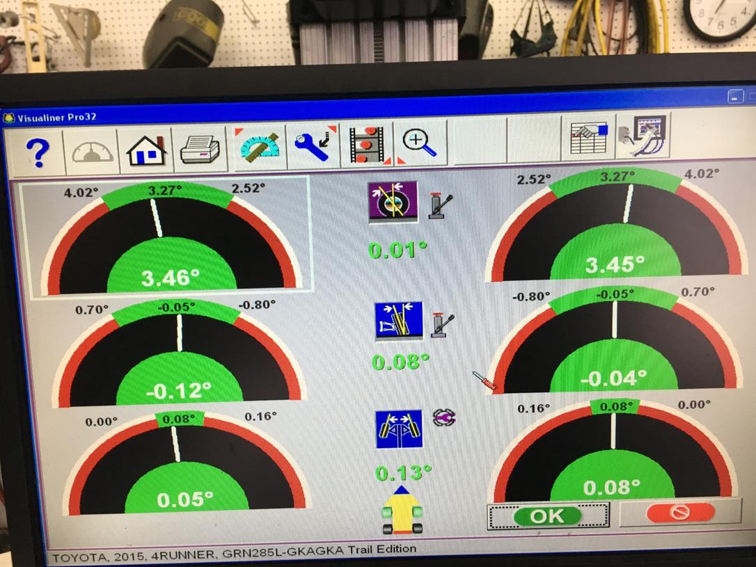

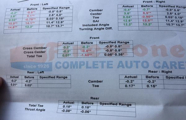

Here are my alignment numbers. I paid for a lifetime alignment at Firestone several months ago. This is probably my 4th time having it aligned. The tech was not happy that I put new UCAs on my truck. He said he had to start from scratch instead of make minor adjustments. He also said this was the best he could do with "damn near new everything under there" (his actual words). In reality, the only new parts were the JBA UCAs, as I had swapped in my suspension before getting the lifetime alignment from them.
I'm out of spec on the drivers side "SAI" and "Included Angle." Is this a big deal? Do I need to give it another shot at a different Firestone?
Drive around for a bit to let things settle in. Take note for any weird behavior. Take it back for round 2 in a week
Never really noticed any weird behavior after round 1, but after round 2 today, all of my numbers are good, and the truck feels even smoother.
Camber: -0.5º/-0.2º
Caster: 3.9º/3.7º
Toe: 0.08º/0.10º
SAI: 12.4º/12.1º
Inc. Angle: 11.8º/11.9º
Those are with a 2.5" lift up front (OME 2883 and Bilstein 5100 set at 0).
