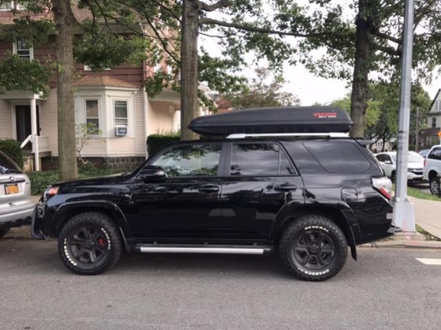

Yes
I got the Skybox 21, fits fine. The only issue is with a spoiler. The trunk will only open up parallel with the ground. As in, not all the way, but we are just fine with it.
We are going to put some 3M foam tape on the box, so that when we open it up it won't scratch the spoiler.

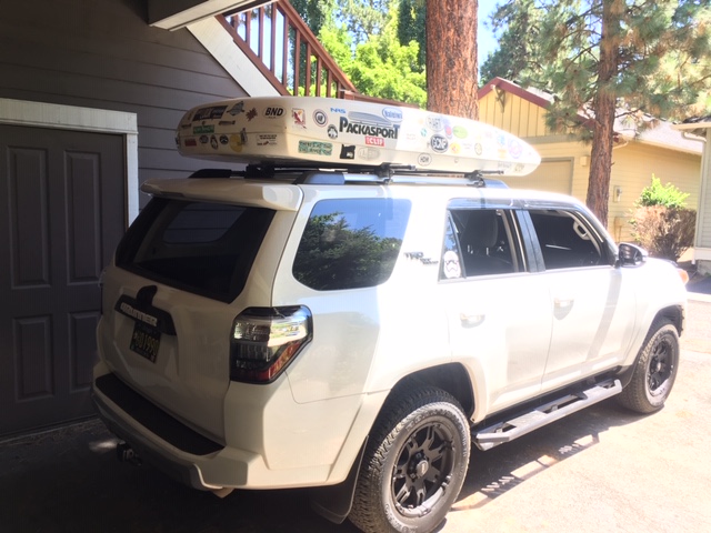

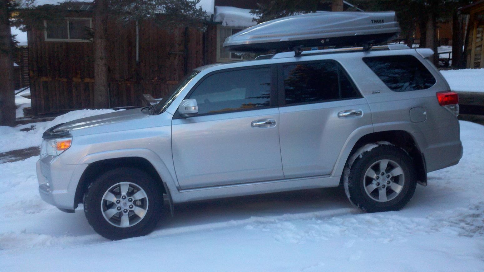

I actually went with the Thule Atlantis 1800, we just got back from the ski trip and we were able to fit most of our stuff up top (2 adults + 2 kids). As you say in your post, definitely a good idea to go w/ aftermarket cross bars, this will bump the roof box up above your antenna fin in the back. $379 bucks is a good price for a Yakima 21; however, check out REI - they have an awesome return policy if anything ever goes wrong w/ it (you may pay a little more there, they do run specials every so often 20% off items).

I'm also in the market for a rooftop cargo box. What length do the crossbars need to be so that they don't stick out too far past the outer edge of the factory rails? That Thule Atlantis 1800 looks great on Silver!

Yep, I appreciate it - we thought the silver on silver looked good as well. Got our first sticker at Red River, NM last month - will start populating the box w/ the places we've been. It depends on how much gear you are carrying, the step down on the Thule wasn't large enough for us. I don't think REI will do a 20% off now for you; however, you can probably buy now then go back in while the 20% is going on and they can price adjust then (if you are going to be in town while that's going on, or get someone to do it for you).
I will say the 18 covers the satellite radio antenna; however, we had zero reception problems.
I'll answer my own question in case it can help a brother out. The 50" crossbars are a perfect fit on the 5th gen. I ended up buying the silver thule atlantis 1800 box, and the thule complete crossroads rail system 45050. With the 50" bars they only stick out about 1" past the factory rail outside edges. I rode around with just the bars mounted and the howl from the wind was pretty damn bad. I skeptically ordered the 38" Thule fairing (which is also just about a perfect fit between the rails with about an inch space on each side) and the wind howl is gone. I ordered folding wheel step off of amazon so I could get up there and load stuff and I couldn't be happier with the setup.
So, you went w/ a Thule fairing and the howling went away? That's a big reason why I don't leave my Thule bars on there all the time, they are definitely nosier than factory bars; however, will have to try the Thule fairing... Post which one you got.
I'm not sure what size my Thule bars are; however, I know they stick out a good 4-6 inches on either side, I like the longer bars in case I want to push the bars all the way over to one side, and maybe put some ski/snowboard racks on there to hold the skis/snowboards. You know, one thing I found handy - when you open the back door, right there beneath the seat is a good place to put your foot when accessing the Thule Cargo carrier.

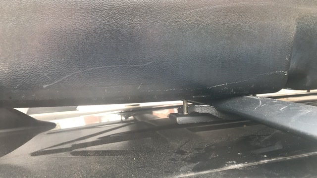

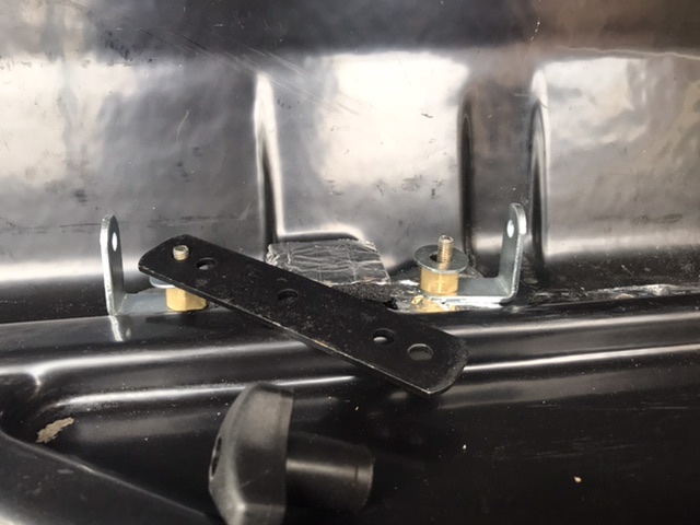

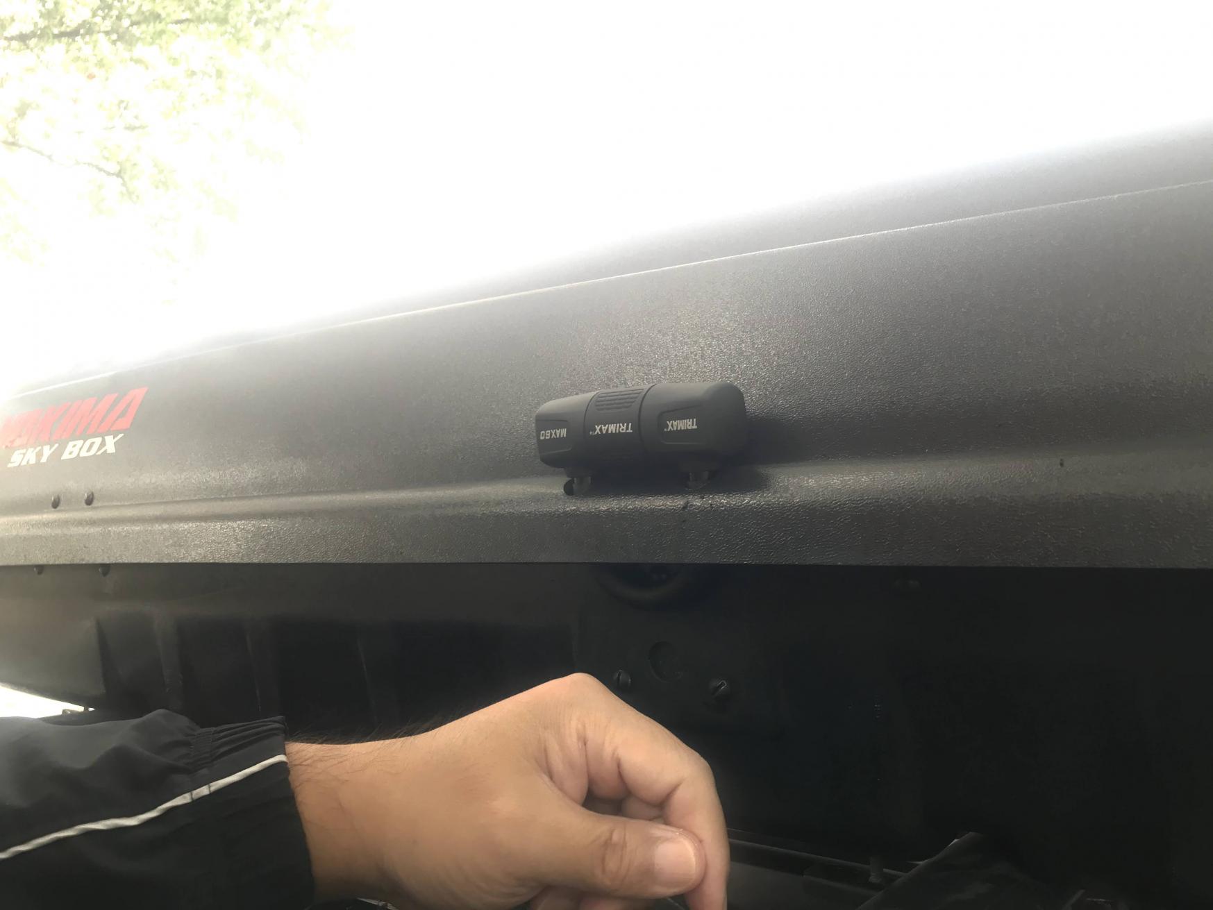

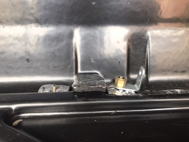

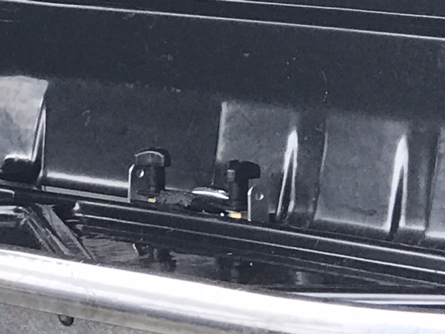

Yakima Skybox 21 fits fine on OEM crossbars if you drill your own holes so that it doesn't stop your trunk opening. Also I changed the fitting so it's more secure and thinner than clamps.
You'll have to mount on top of the bumps in the box in the front. There's no way around it. So I found some fittings for screws so that I can lock the bump the same way I lock the flat parts.
I bought this box used for $130 on Facebook Marketplace just 2 weeks ago. I drilled 2 holes on the lips so i can lock it down with a U-shaped bike lock.

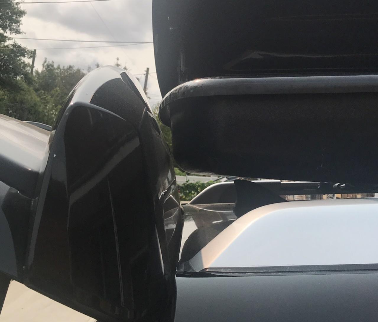

Hey team, Reviving this thread. Currently have a skybox 18 that I had before my 5thgen 4runner. Having clearance issues with the rear spoiler. Has anyone found any solutions to this issue other than drilling new holes into the box? I will if I have too but not going to be my first choice. Thanks!
[MENTION=634715]cruf665[/MENTION] Are you using the OEM rails? If you use Thule or Yakima it should set it up high enough to clear since they are above and not integrated into the roof rails.
no enough clearance for oem bars
I just bought a 21 4runner and I don't have enough room to clear the roof with the yakima box up top, disappointing as I just bought the OEM bars, I am hoping they will take them back but sucks to have to spend more $$ on aftermarket to make it fit. So stupid to put the roof rack so close to the top of the car.
We already had the Skybox Pro 16 so I just stuck with it. The only issue I had were the stock crossbars and clearance between them and the roof. Got some Thule crossbars that mount perfect and give it some height, works perfectly. Considering a different rack on top but no issues for now.
That was an enhancement to reduce wind noise and make a major improvement on gas mileage. :mad2: Would have fit my 2011 Trail no problem. 2020 ORP OEM bars are lower so you have to purchase aftermarket bars.

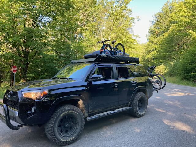

I've had this gigantor Packasport for years and moved it over to various vehicles. Originally a Suburban, then to a '04 Pilot, now on to the 4Runner for the last 4 years. It sits up on Thule crossbars and I had to drill new holes in the Packasport to move it forward to clear the spoiler. I like the look of a roof basket, but this thing just swallows up bulky gear in a much more aerodynamic form and has advantage of being lockable.

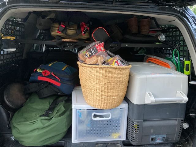

Lose the Skybox...
...and get thee a set of Rago Fabrication molle panels and shelf for the rear fo the truck.
I do a lot of road trips with my wife and two sons. We used to have a Skybox 16 on top for all the camping gear. Now that I have the Rago shelf I can fit all of our camping gear, food, luggage and fridge in the rear cargo area. 2 bikes on the top of the truck and two on the rear rack. Only gets a little tight when we have to haul firewood but that's usually only a little ways each time we camp.
First pic is with the box and 2nd is the rago setup. Not very organized in this particular shot but it works. There is SO much more space back there when you have the shelf. Good luck!
