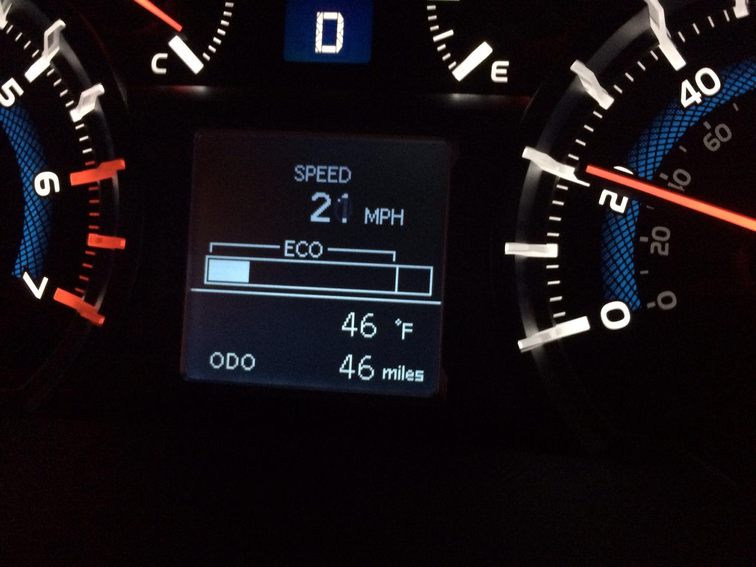

"Turn off the echo bar"

  • Remove the "eco" bar from the center LED display
